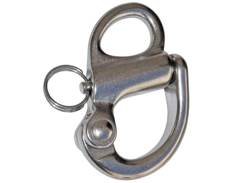

Lets consider your rigging. You have a Halyard (Main sail or Jib/Genoa) that you want to make easier to connect and remove from the sail.
You are considering a "Snap Shackle". Like this?
Are you concerned about the risk of these shackles snagging and the sail pulling loose from the halyard allowing the sail to fall and depower the boat?
