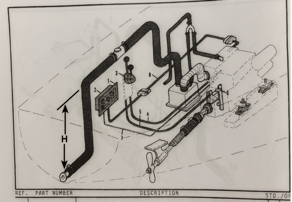

................ but in order to have backflow due to a following wave, you would need a wave higher than your lazarette = H. A check valve any where in an exhaust hose is not recommended because the corrosive exhaust gasses would eventually corrode out the flapper or the flapper would plug with carbon.

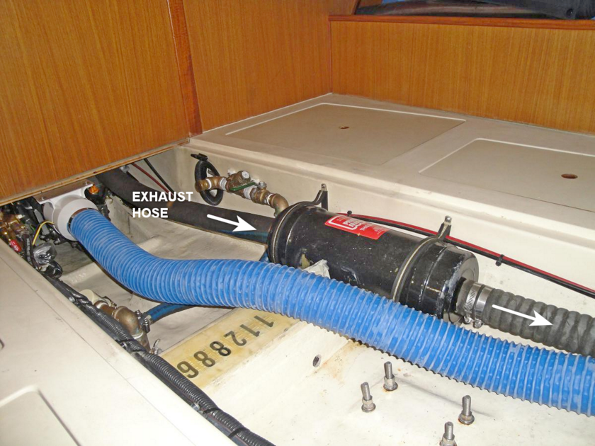

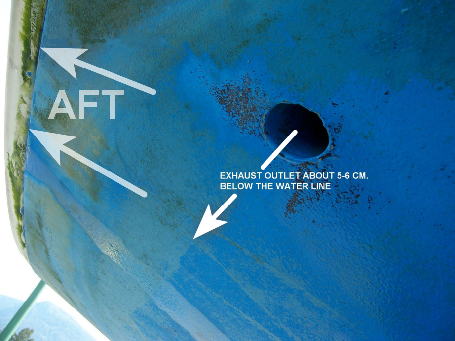

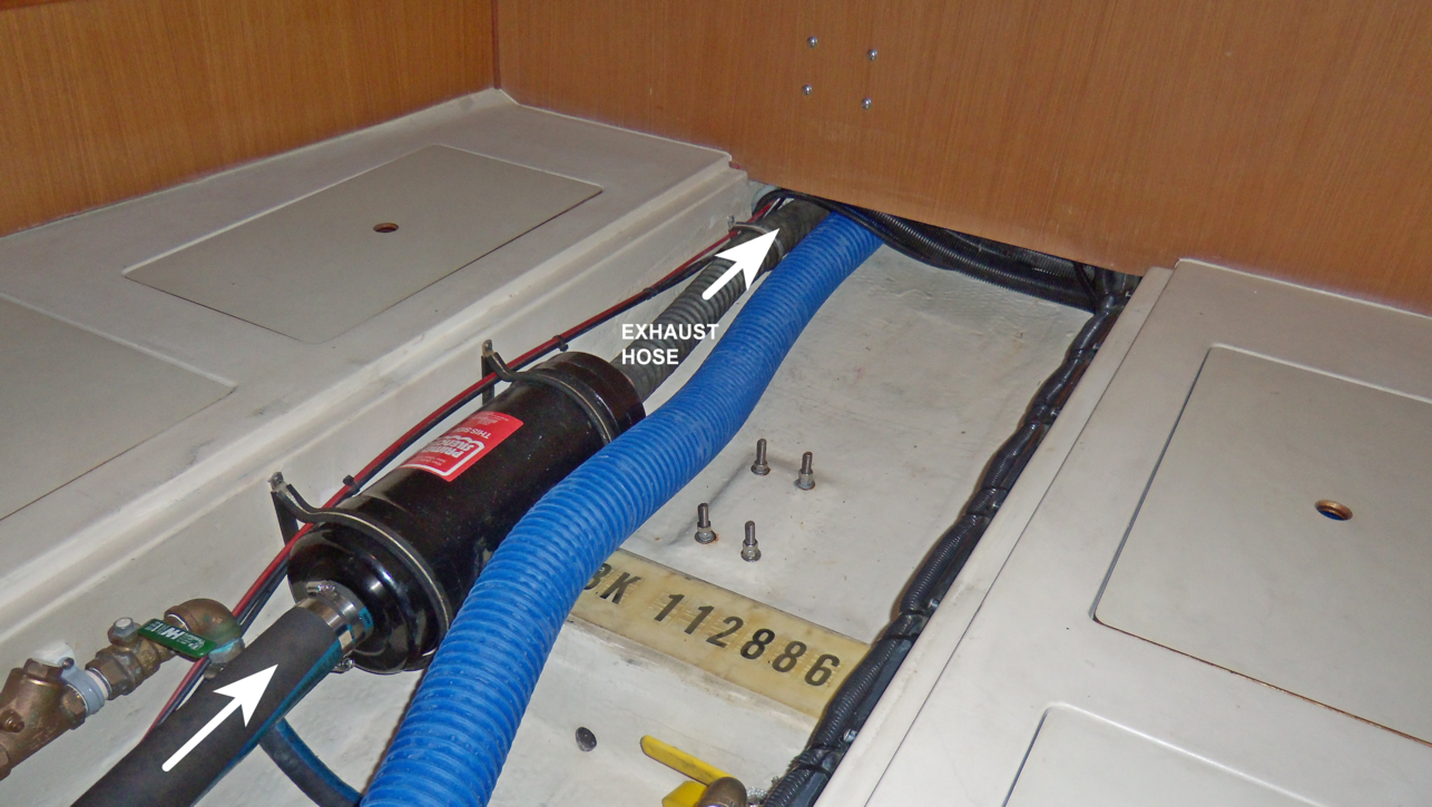

If the exhaust hose lays on the bottom of the hull as mine does, then you need an exhaust loop. In my H-310, the exhaust hose lays on the bottom of the hull from the engine exhaust all the way back to where the bottom of the transom meets the bottom of the hull :
When it reaches the bottom of the transom, it rises up in a tight loop to the height of the transom and then down to the bottom of the hull where it discharges underwater.
Backflow is only possible if a following wave rises to the top of the transom with the engine shut down. At that point, one would have far greater problems than backflowing water in the exhaust hose :yikes:.

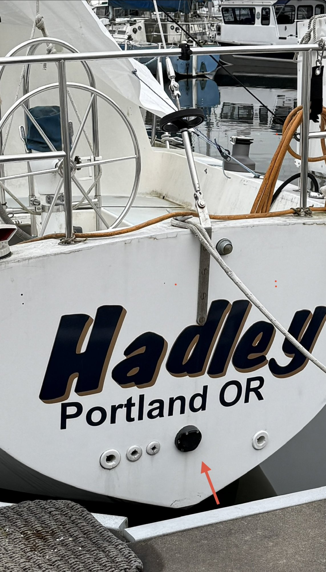

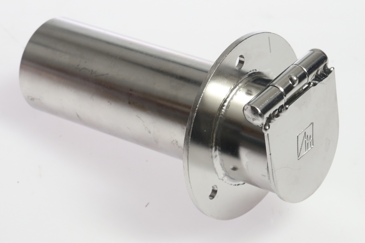

My boat came with an exhaust pipe that rises 24” from the engine exhaust manifold does a 180 drops about 15” at which point the raw heated water from the engine is injected and runs at a shallow angle out through the stern tube. There is a rubber flapper on the stern tube. When up it lets exhaust and water exit. When down it lessens the possibility of water to flow up the exhaust system
Arrow points to exhaust stern tube sitting well above the water line.
