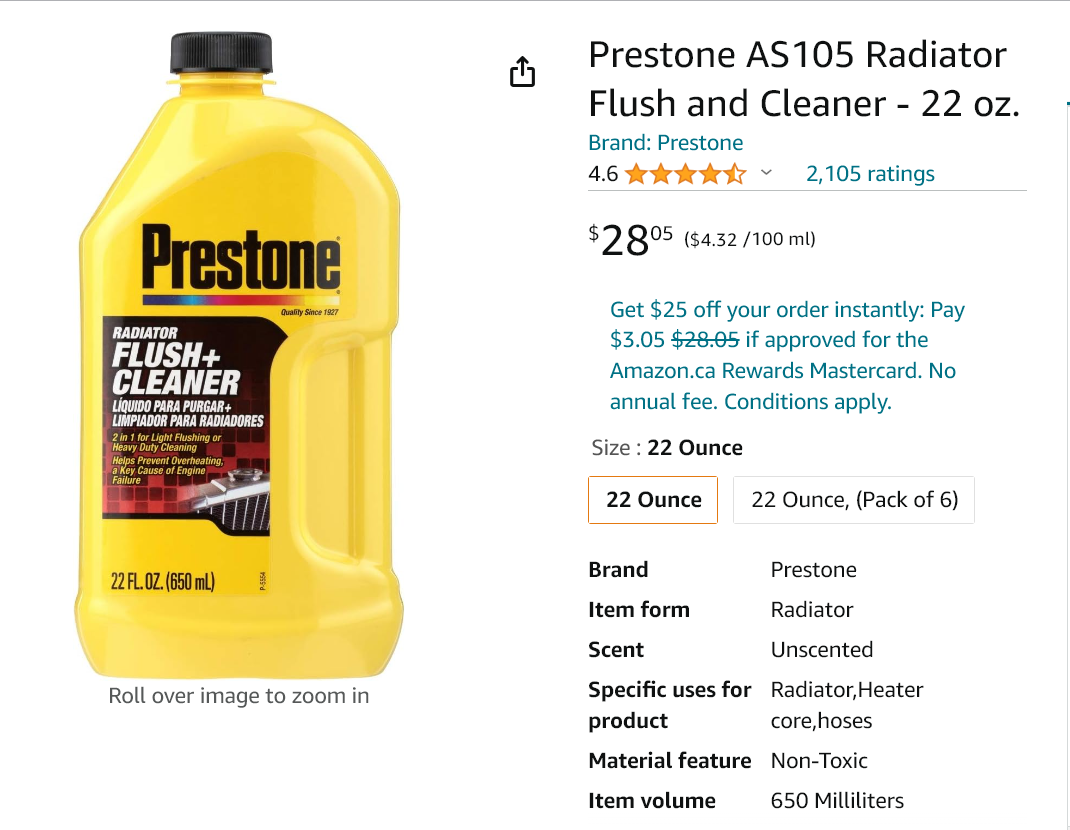

I want to descale our 2GM. I can see lots of deposits inside the motor when I pull the thermostat.
What you are seeing inside your Yanmar ENGINE BLOCK are likely the metallic products of corrosion which have been corroded from one location and deposited in other locations. These deposits are not the sea water scale referred to in the Practical Sailor article above. Those are most commonly caused by salt water. Sea water scale as opposed to internal engine block scale require different cleaners.
Search for internal engine block coolant cleaners made by well known Antifreeze manufacturers such as :
Once the internals are clean, use only distilled water to make up your 50/50 antifreeze mix.
Likes: Hello Below
10,093
Note that the 2 GM is seawater cooled.. the 2 GMF is coolant cooled.. He may well have seawater deposits
