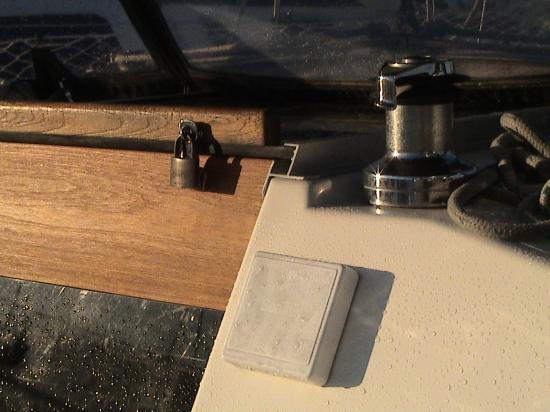

I have a 1992 H28 that I bought used a couple of years ago. I am having intermittent problems with my depth gauge. Sometimes it will not even power up (blank LCD display). Other times it will show a blinking display with the last depth it registered, then all of a sudden start working again. I have inspected the wiring and all the connections are tight. I used a multimeter and I am getting power to the display head in the cockpit (even when it won't show anything), the through hull doesn't look damaged and is clean. Any ideas why my depth gauge would work intermittantly? I have included a picture of the display, unfortunately it is covered and I'm not sure of the manufacturer (I think it is a Raymarine ST60 Tridata). Thank you for any thoughts that will help me in trouble shooting.
