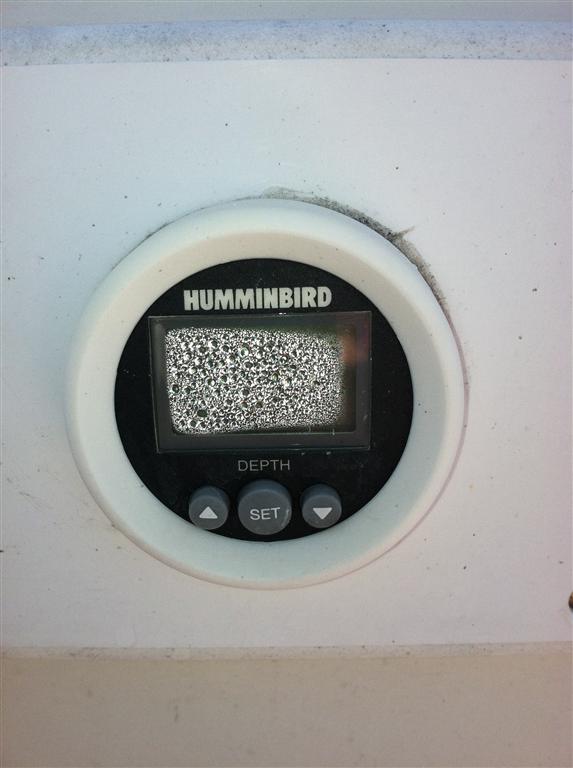

My boat has a Humminbird depth sounder. The screen is filled with condensation so it is not readable. A new unit is around $85. Is Humminbird a good quality unit? Are there better units I should consider? Do all units use the same type transponder? The Humminbird transponder is epoxied into the bottom of the boat, not thru the hull.

Have you tried to leave the light on ? Most of the time it will generate enough heat to get rid of the condensation

An alternative to taking the unit apart to dry it is to put it in the oven set to about 120 degrees for an hour or two.

"Open it up and dry it out"
"Have you tried to leave the light on ?"
"put it in the oven set to about 120 degrees for an hour or two."
Man, I wished I had asked earlier.
I practically destroyed it just trying to take the front ring off. Turns out the PO glued it in place, solid. Even the ring was glued on. He had mounted it in a piece of rectanglur starboard which was screwed and glue to the cockpit bulkhead, then he glued in the head unit.

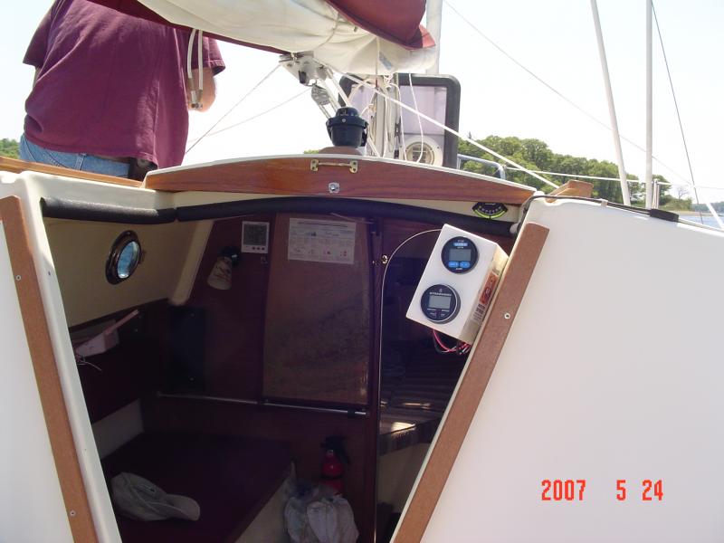

Looks like I will need to use a multii tool to cut the starboard free from the gelcoat, then repair the gelcoat or mount a panel over it to hide the damage. I might try mounting whatever I replace it with like in the 3rd photo, which is of Trinkka. I like what Joe did there.

Ward, I've seen a couple posts about using fishing line with dowel handles (like a garrott) to cut through adhesive caulk. Might help with removing the starboard piece.

You can use "deBond" to melt the glue. It come off real easy after a few days of soaking.
