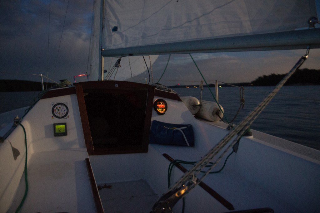

Raymarine i40. This is also available with a transom mount transducer.
Depth finders are essential to some of us and almost all of the Raymarine units are crap, including the one on my boat. I assure you, when you're at the helm at night, even on our 22' boat, you will have a difficult time discerning between 12.1' and 121' on Raymarine's inadequately lit displays. The lake where I sail can vary between 140' and aground in a relatively short time. A 5th grader would have enough sense to superscript or subscript fractional feet, or better yet, have the ability to disable them. Why does Raymarine insist that we need fractional feet?
Don't get a Raymarine. End of rant.
Is it 121' or 12.1'? Are you positive??
