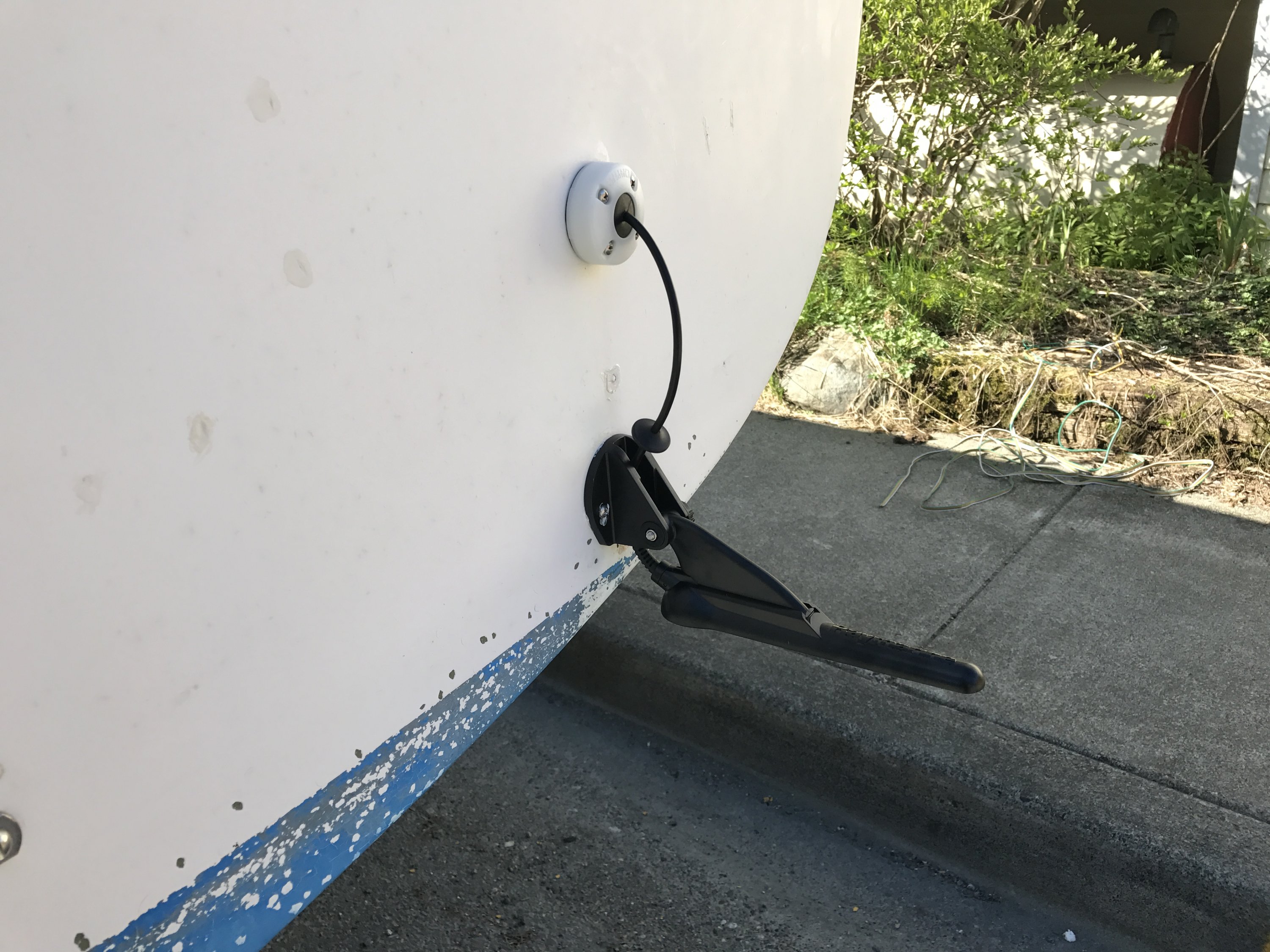

I picked up a barely used, Lowrance Mark 4 GPS/Depth unit for $76 USD.
Besides GPS, it has NMEA output so I can run it into a DSC radio or something else.
While I likely won't use it's charting functions, the extra GPS data source on board may come in handy.
The GPS function will also allow depth logging, for making my own charts. (Insight Genesis or other similar projects)

EDIT: here's hoping the transom mount transducer will work inside the hull. The New Design C22 has no coring in the bottom so it "should" work.
