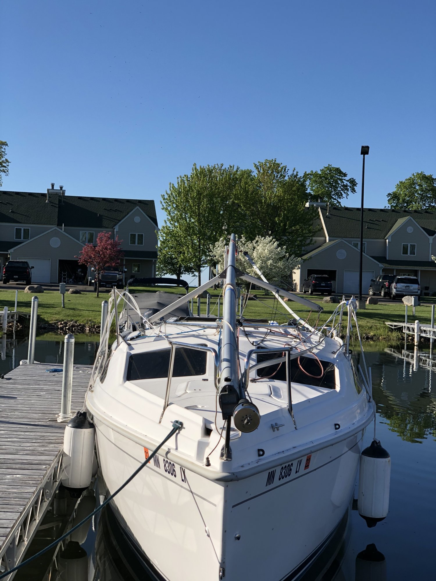

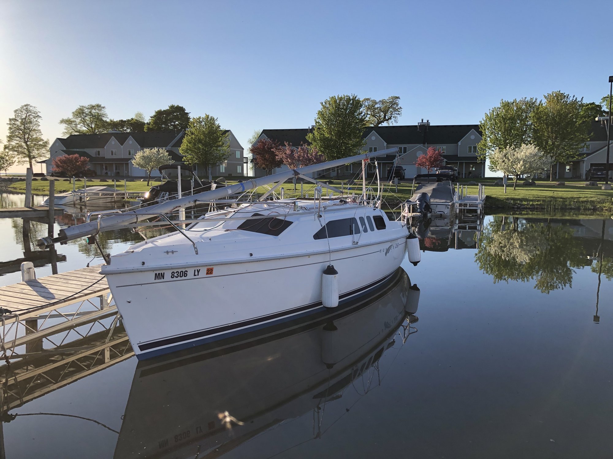

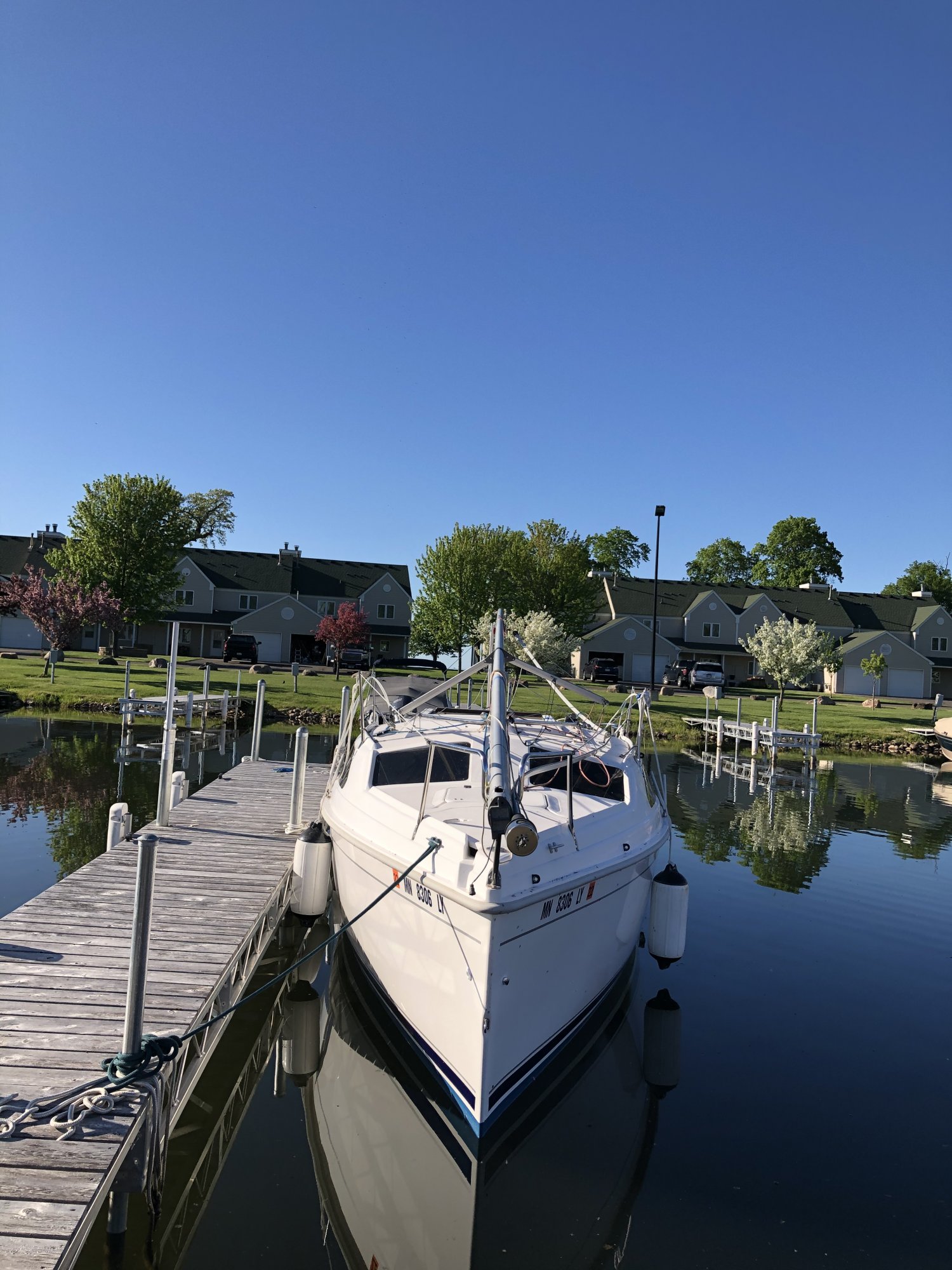

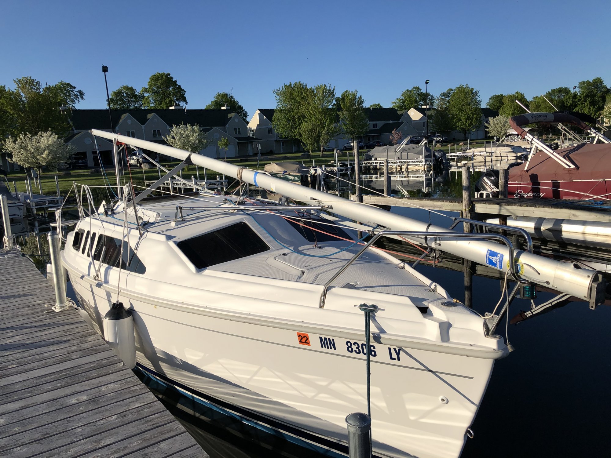

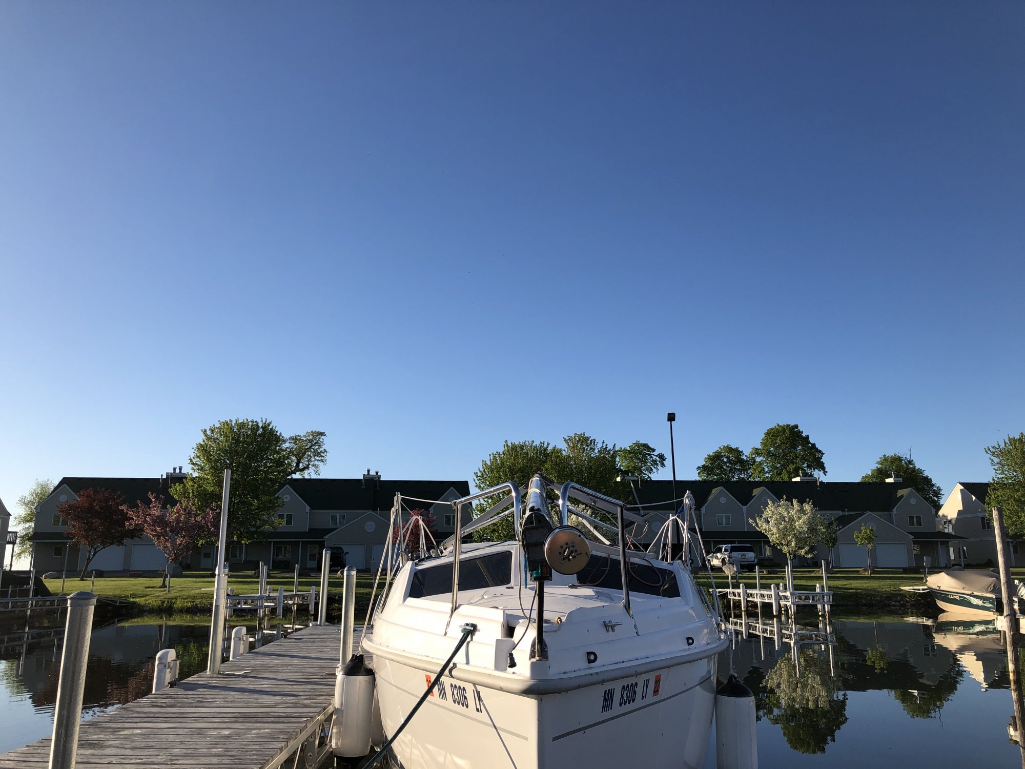

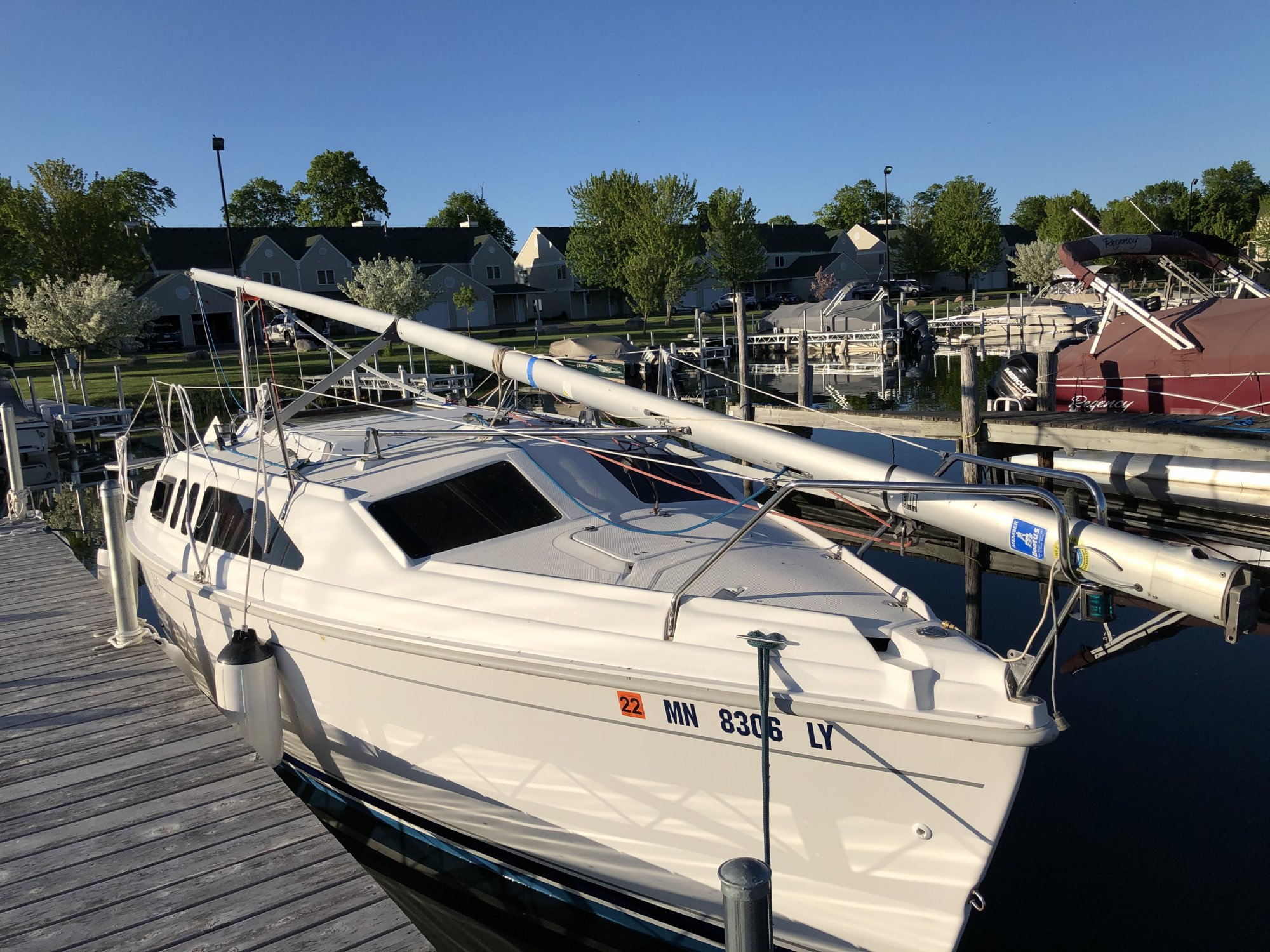

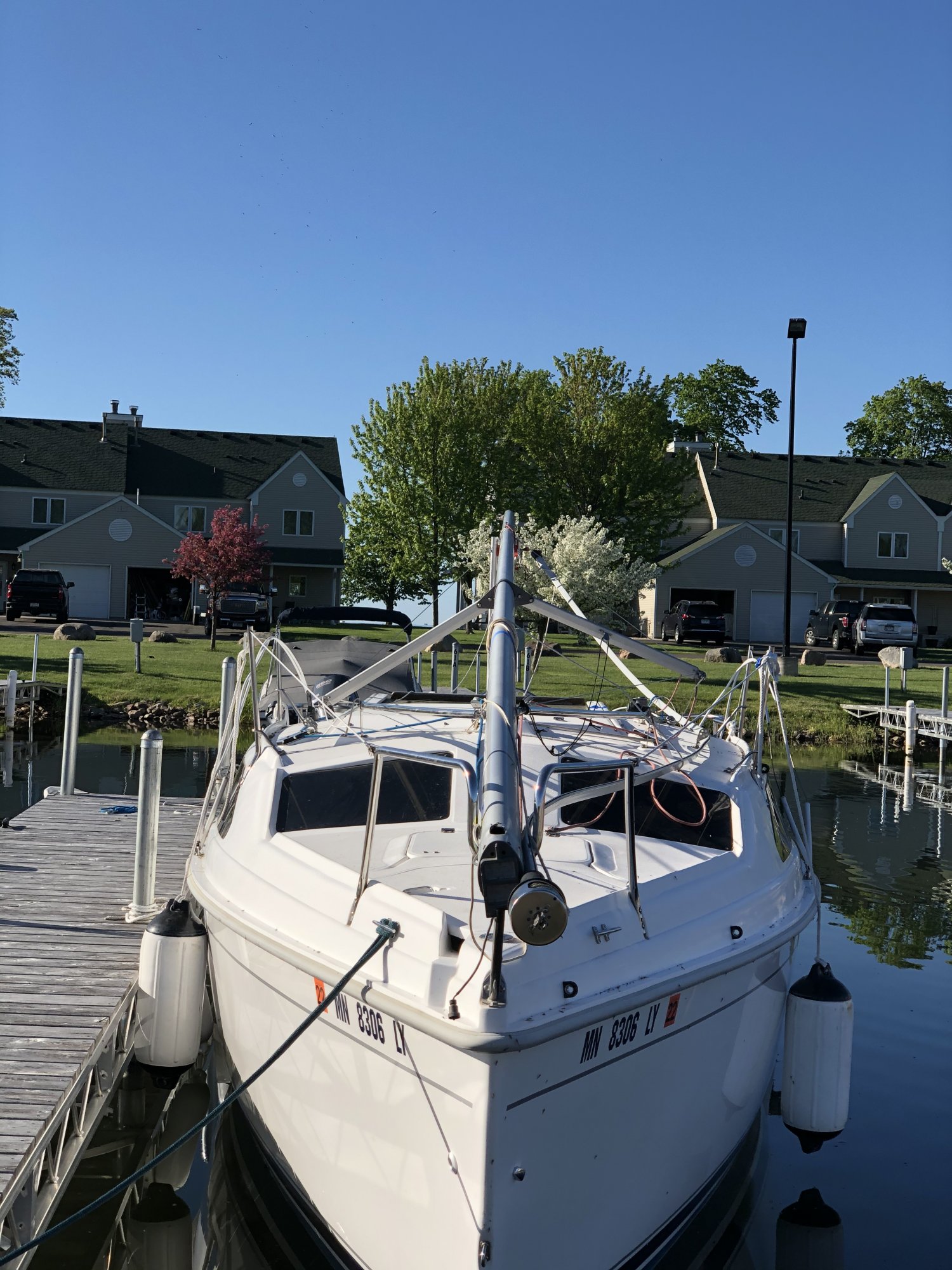

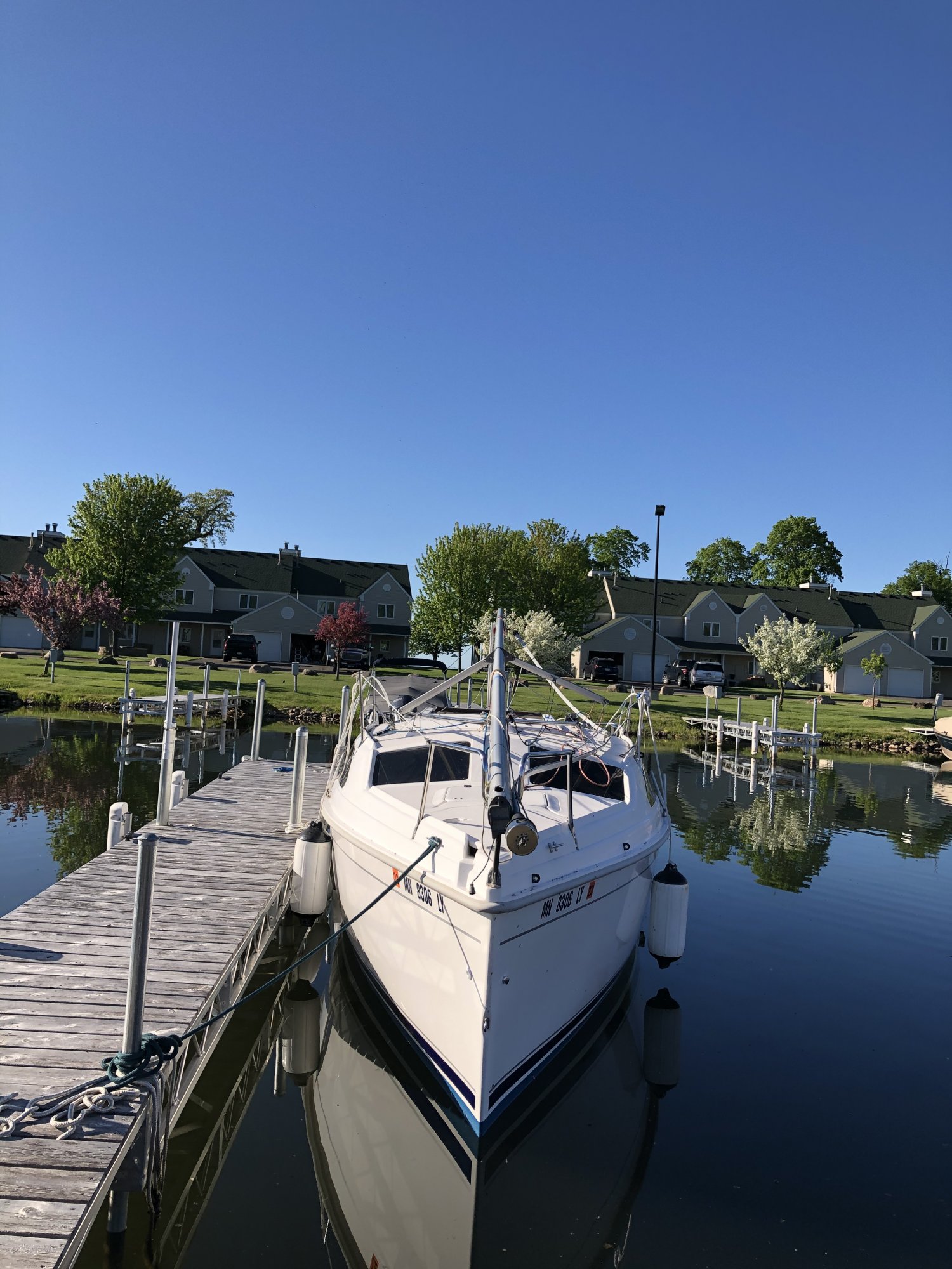

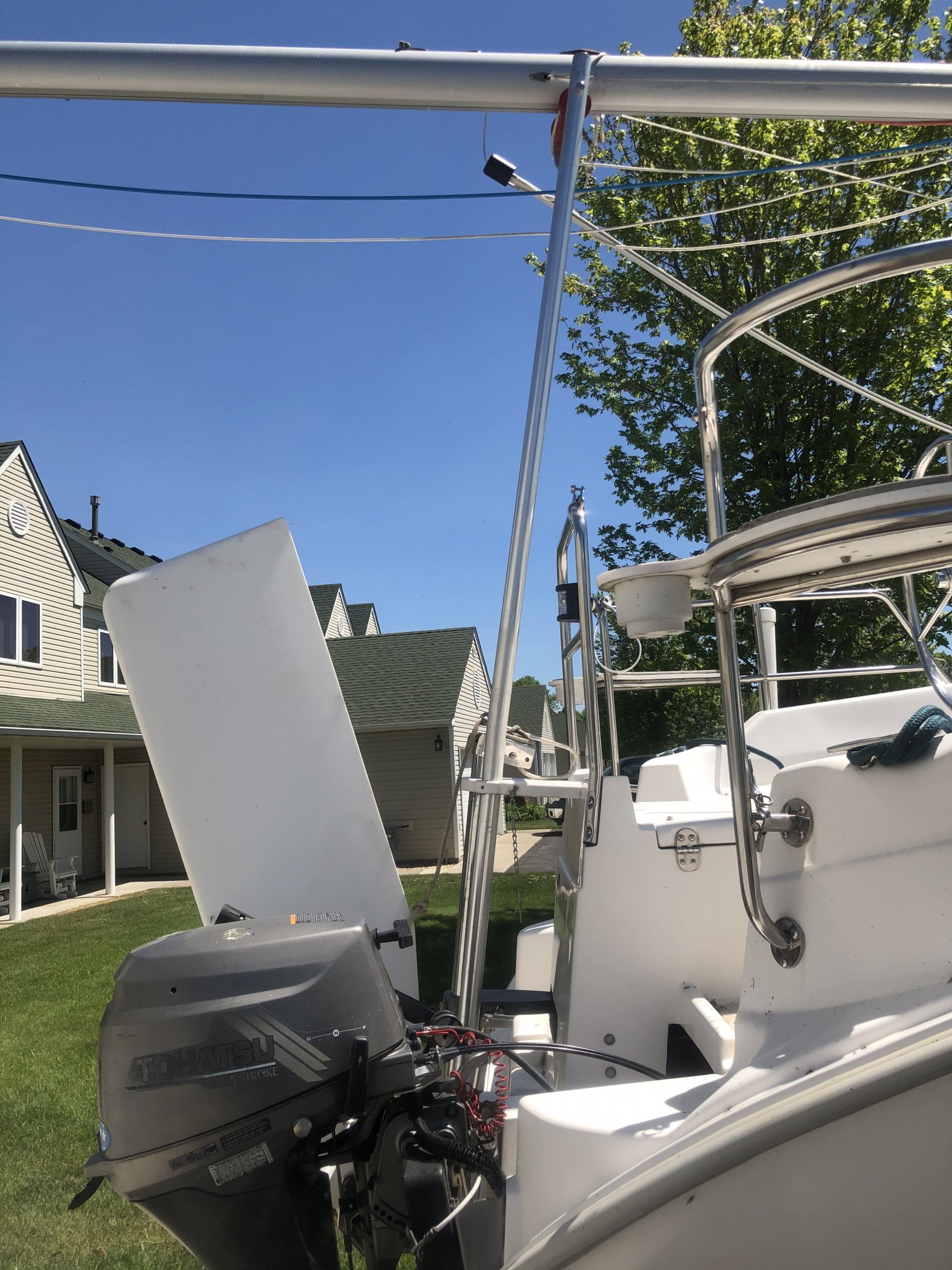

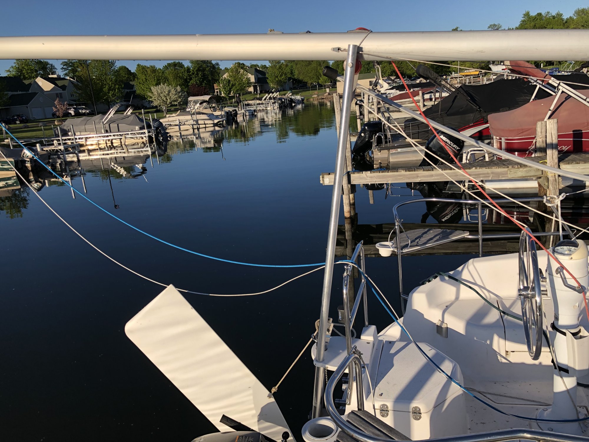

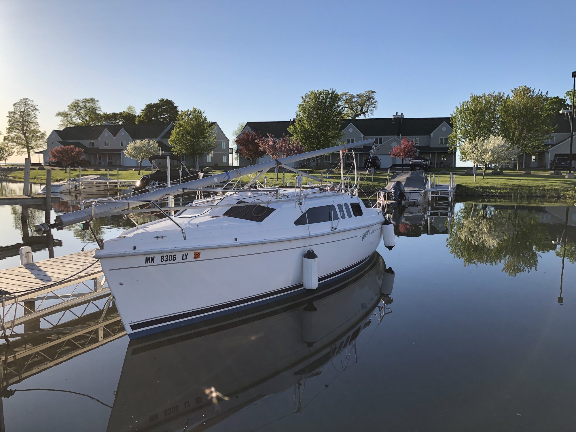

My father and I attempted to step the mast on the H260 for the first time today. The halyard line brake was accidentally disengaged while the mast was nearly full in position. That immediately led to the dropping of the mast on the cradle from a significant height. The bar the is inserted into the base of the mast was bent in a 90 degree angle, the hole it is inserted to in the mast is ripped on the aluminum, and the cradle is bent. I can’t tell if the mast is bent or not but is suspect it is slightly bent aft.
I’m not sure what to do next. I’m just north of the Minneapolis area and really don’t know of any good place to take the boat to. I also have no idea how much money (ballpark) of damage we’ve just done - though I fear it’s a lot. I also don’t know how long it typically takes to repair something like this. I’m hoping it isn’t an entire summer.
I am happy to say that nobody was hurt - but our sailing career has not started well. I’m sick over it and don’t have many ties to the sailing community for help. Any input that can be provided would be very much appreciated.

I'm not clear if the hull was damaged, or just the mast? Any photos? You'll get plenty of help here.

Thanks for the reply. It was not an ideal first outing. To my best estimate the hull was not damaged. We are pretty dejected over the matter. I had registered in a course to learn to sail and then COVID saw it canceled. The next step was to try and find someone I could pay to give private lessons - thought I could put it in the slip and raise the mast (they claim its easy) by myself and save some time to actually sail.

Captain Abby will be back at the helm before you know it. :). So it sounds like you damaged the bow rail that cradles the mast and possibly the mast. The reinforcement plate and mast raising pole aren't too expensive (by boat standards). Hunter 260 Rigging & Spars Parts
The bow rail will be, so if you can find a local shop that works with stainless see if it can be repaired. That wouldn't have to be marine business.
The mast, that's tricky and you don't want to buy one unless you absolutely have to. Someone who knows more about rigging than I do can hopefully help you determine if it's damaged. A photo of the area you think might be damaged could help.

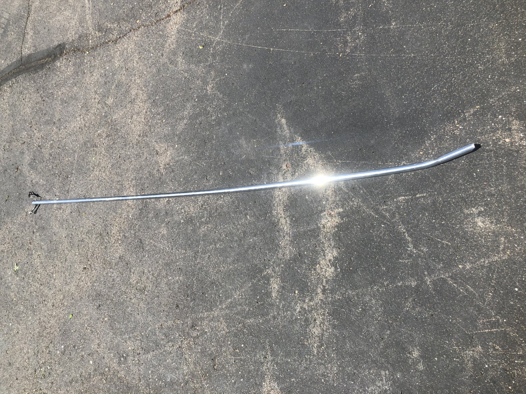

I don’t have any hands-on with a 260 but @rgranger might offer some insight as to how to look at the mast.

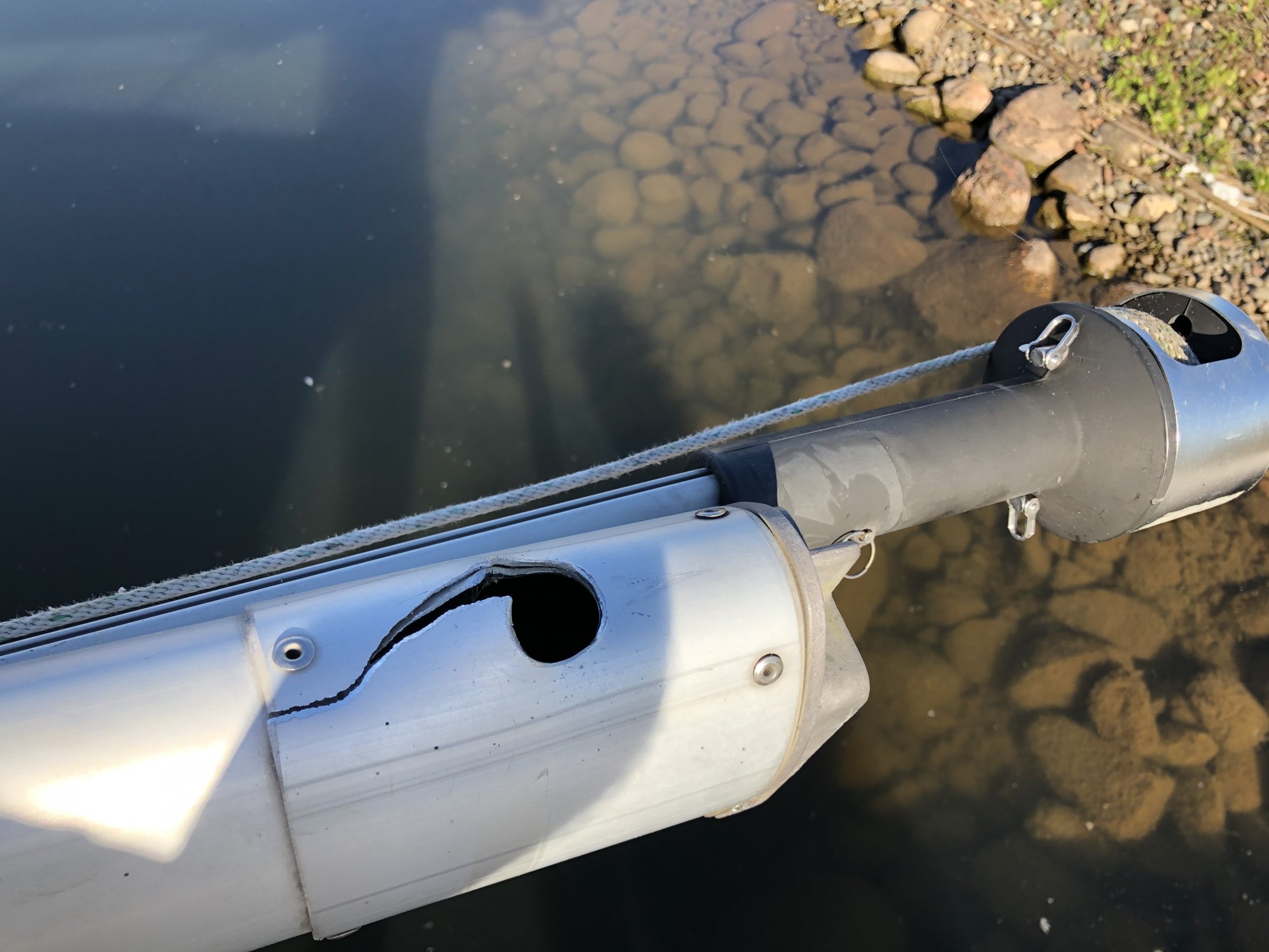

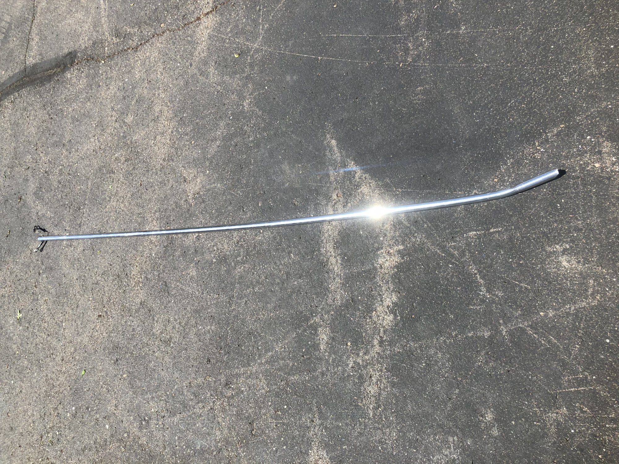

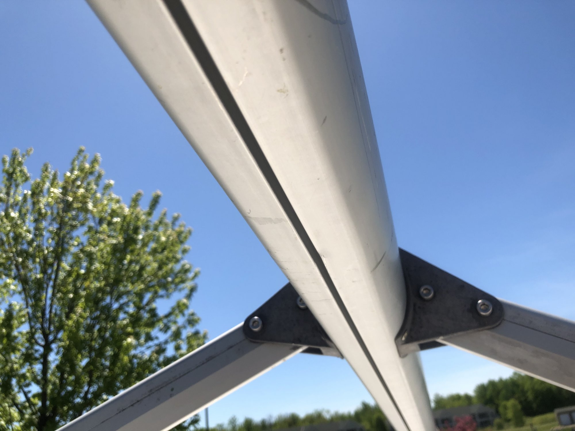

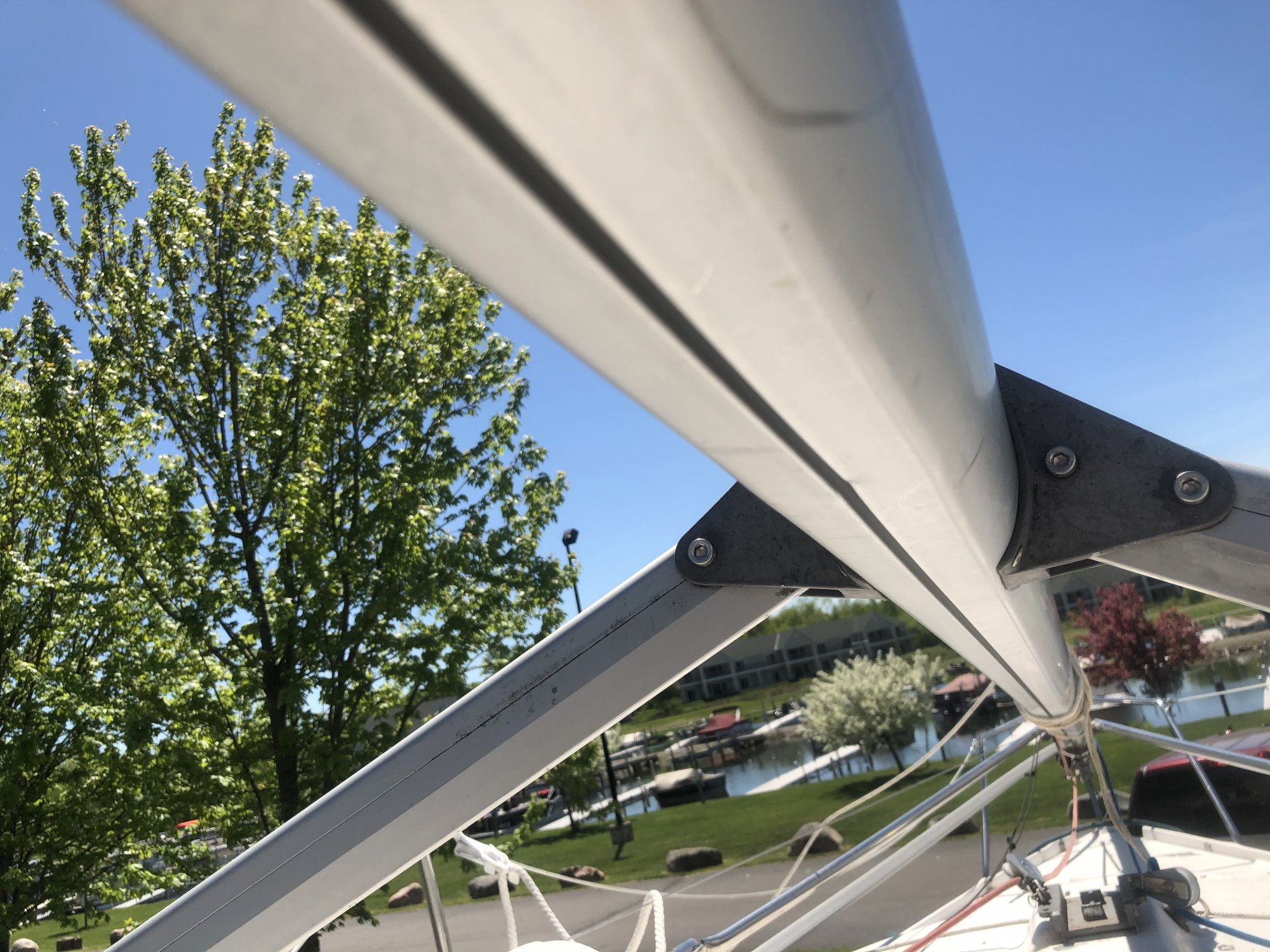

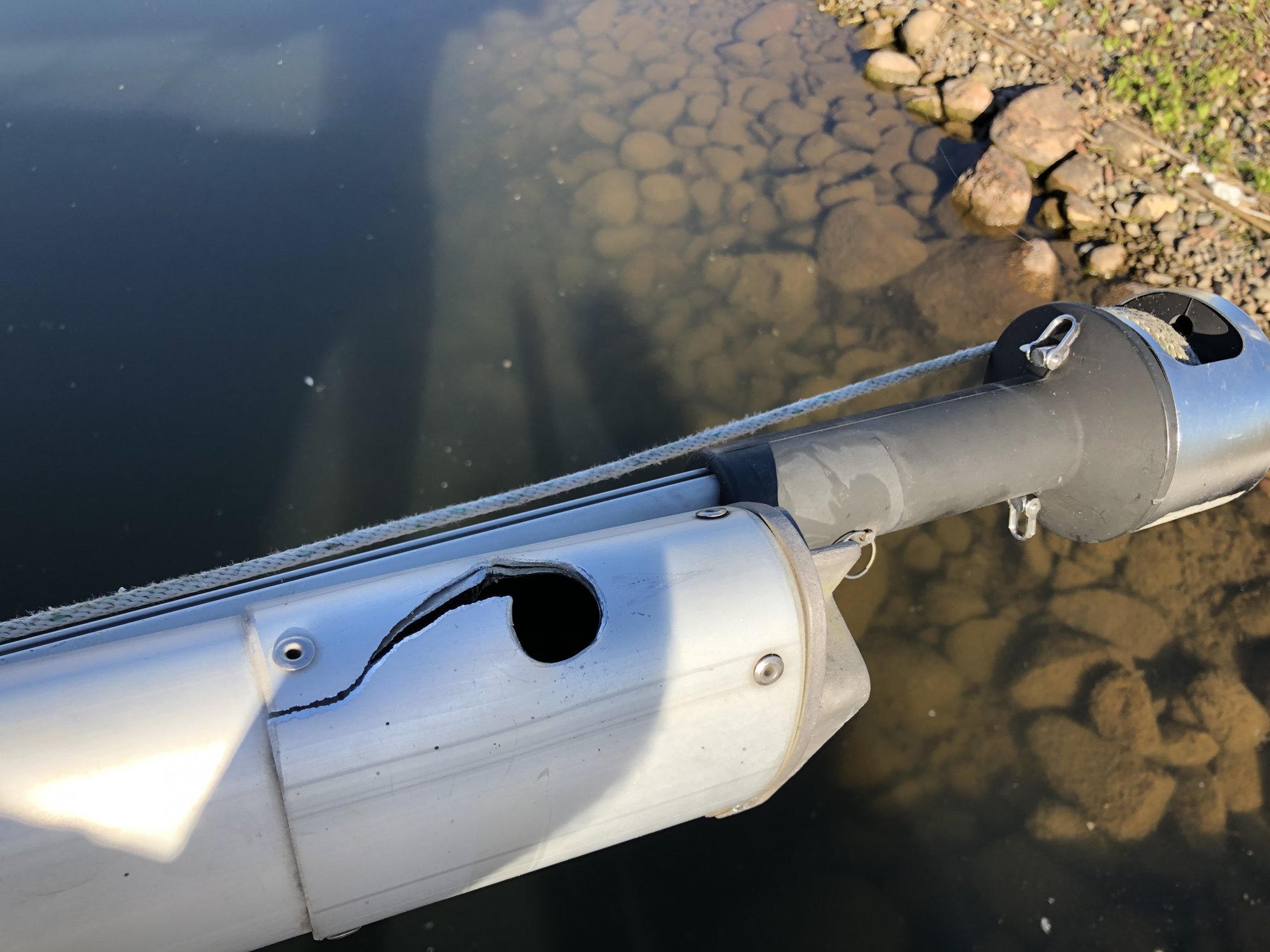

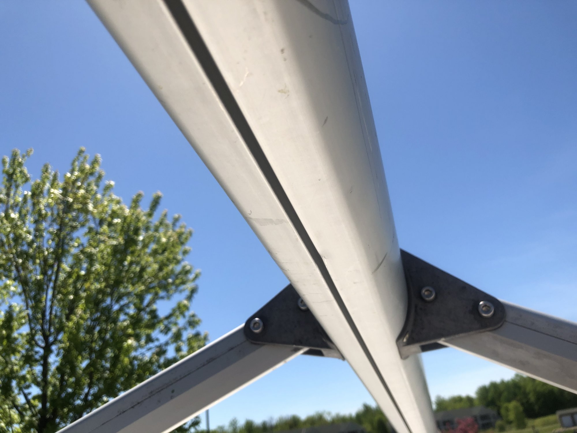

Looking at your photos and your description of the event it would be a good idea to carefully check the casting on the bottom of the mast, the retaining pin and mast step on the cabin top for damage.
I assume the struts prevented twisting on the way down and the mast landed on the crutch ( did it suffer any damage?) at the stern so that impact point would be an area of potential damage. Check the groove where the mainsail slugs slide to see if it’s deformed.
The gin pole sounds like it’s pretty bad and the hole it inserts into like you said is torn. Looks like the exterior reinforcement casting could be easily replaced by taking out the rivets but it’s hard to tell how damaged the actual mast is there.

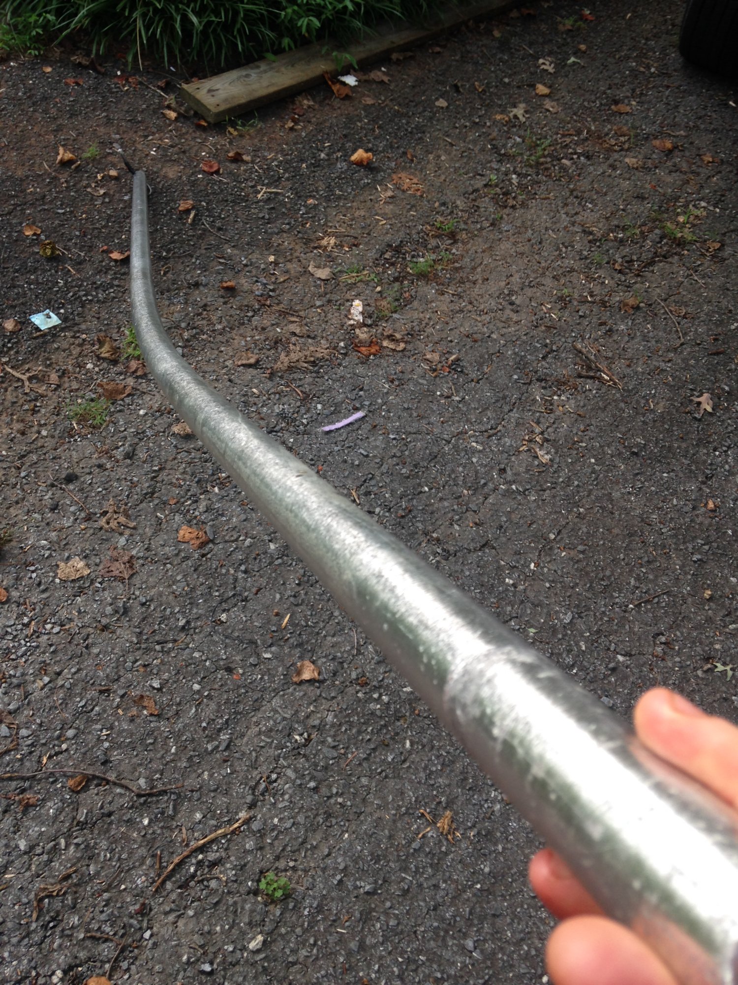

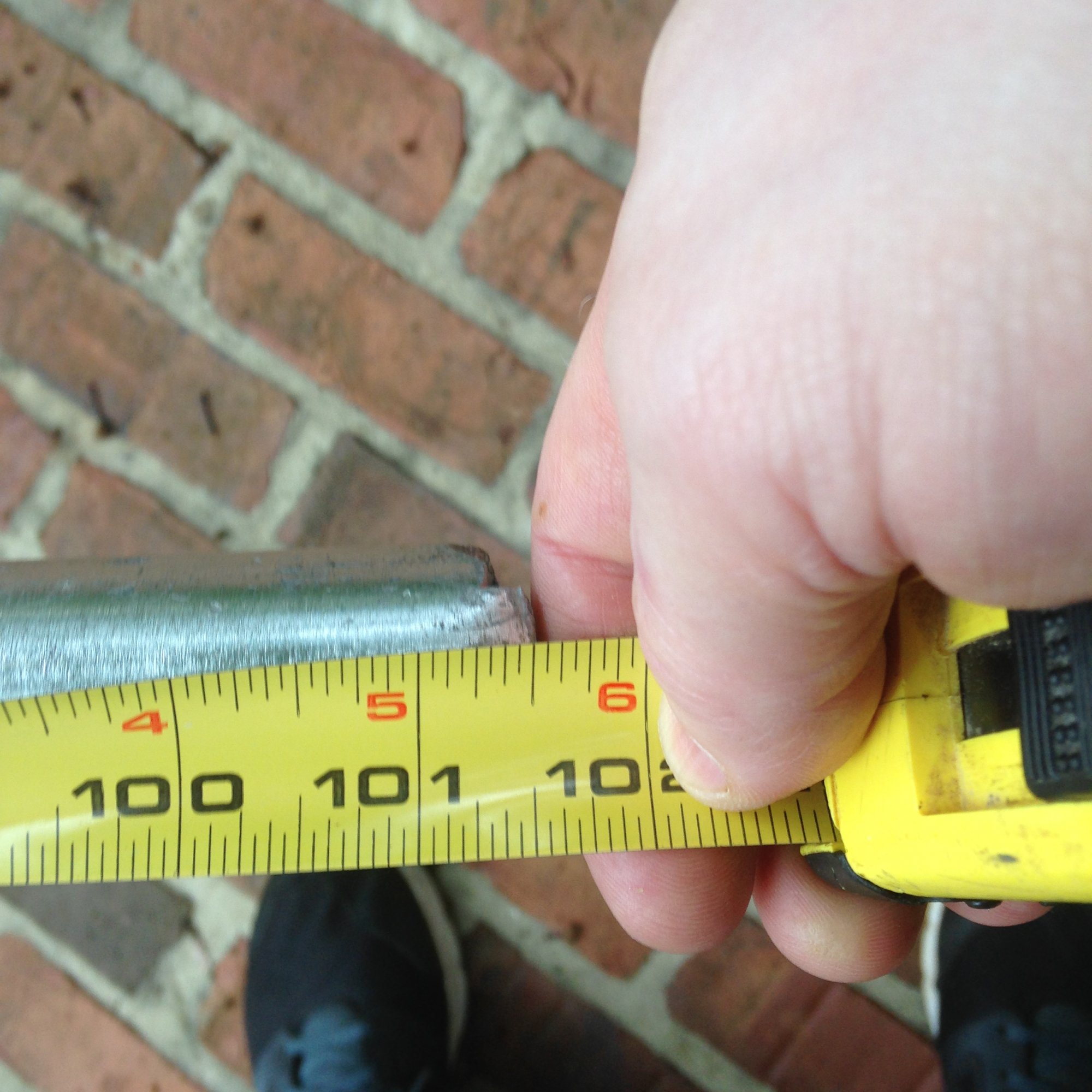

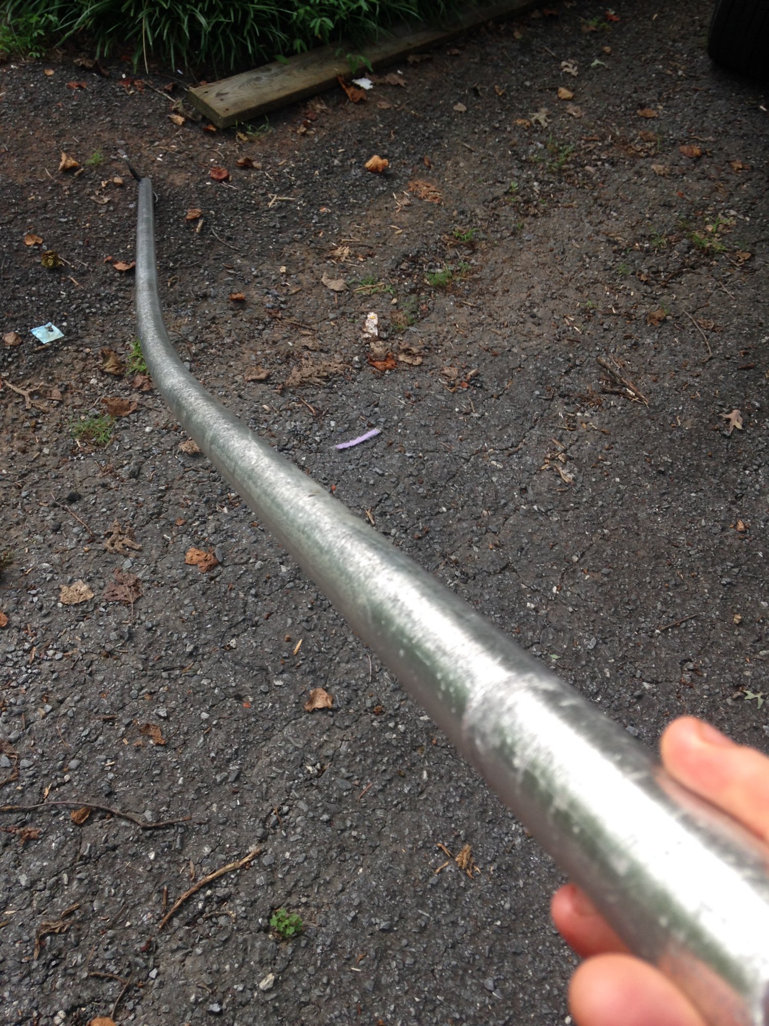

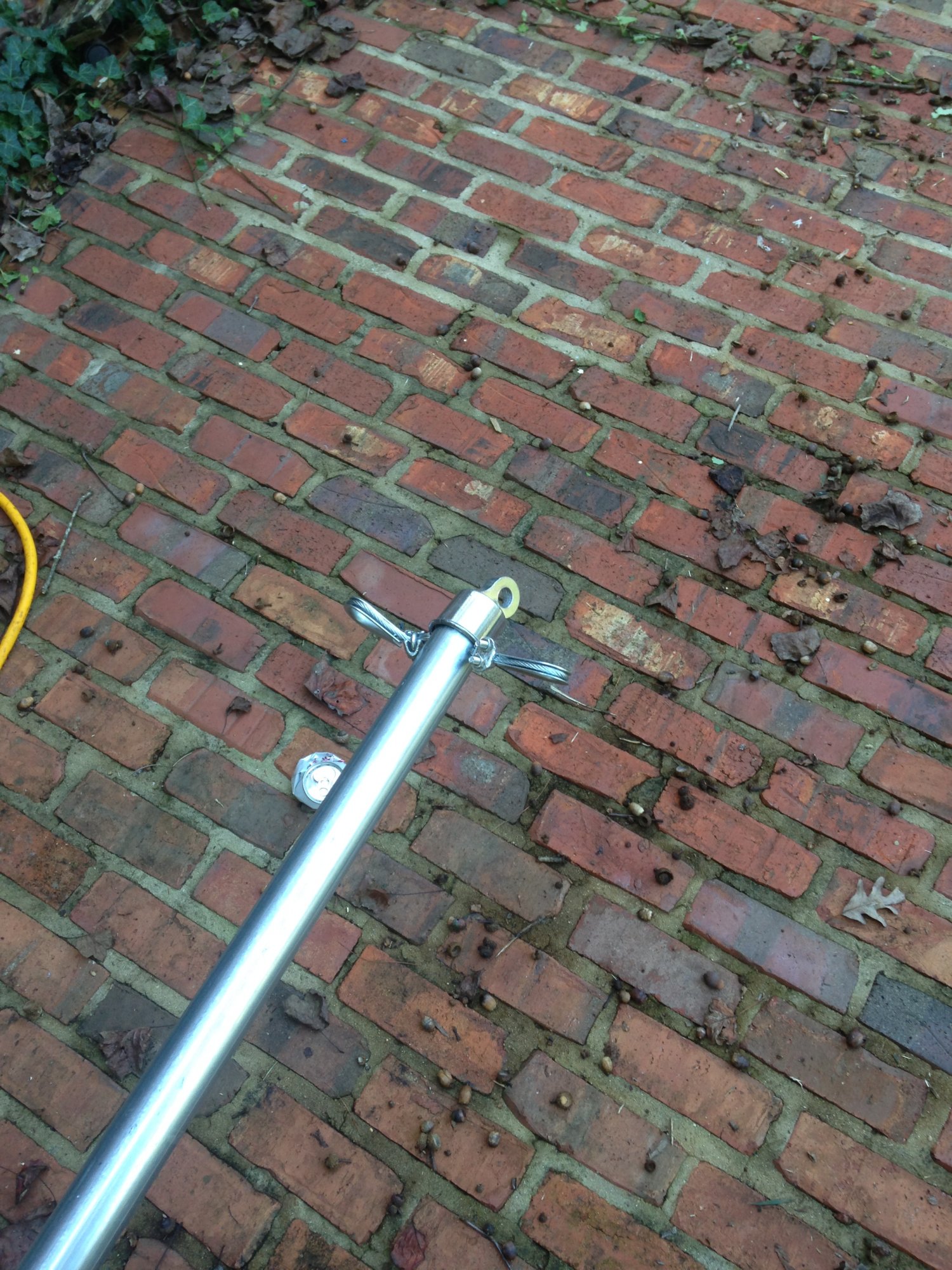

I don't want to relive the details here but your damage does not look to hard to fix. Regarding the aluminum plate for the lifting pole. Drill out those rivets, then find a piece of aluminum plating. You might be able to find it Lowes over by the area where they sell plexiglass and angle iron. Then drill a hole, bend it and rivet it back on.
If I were bending the plate I'd use a wooden post. drill two holes in the aluminum and through bolt it to the post,... then start gently whacking it with a rubber mallet until the aluminum bends around the post. This will be a time consuming step because you will want to take is slow.

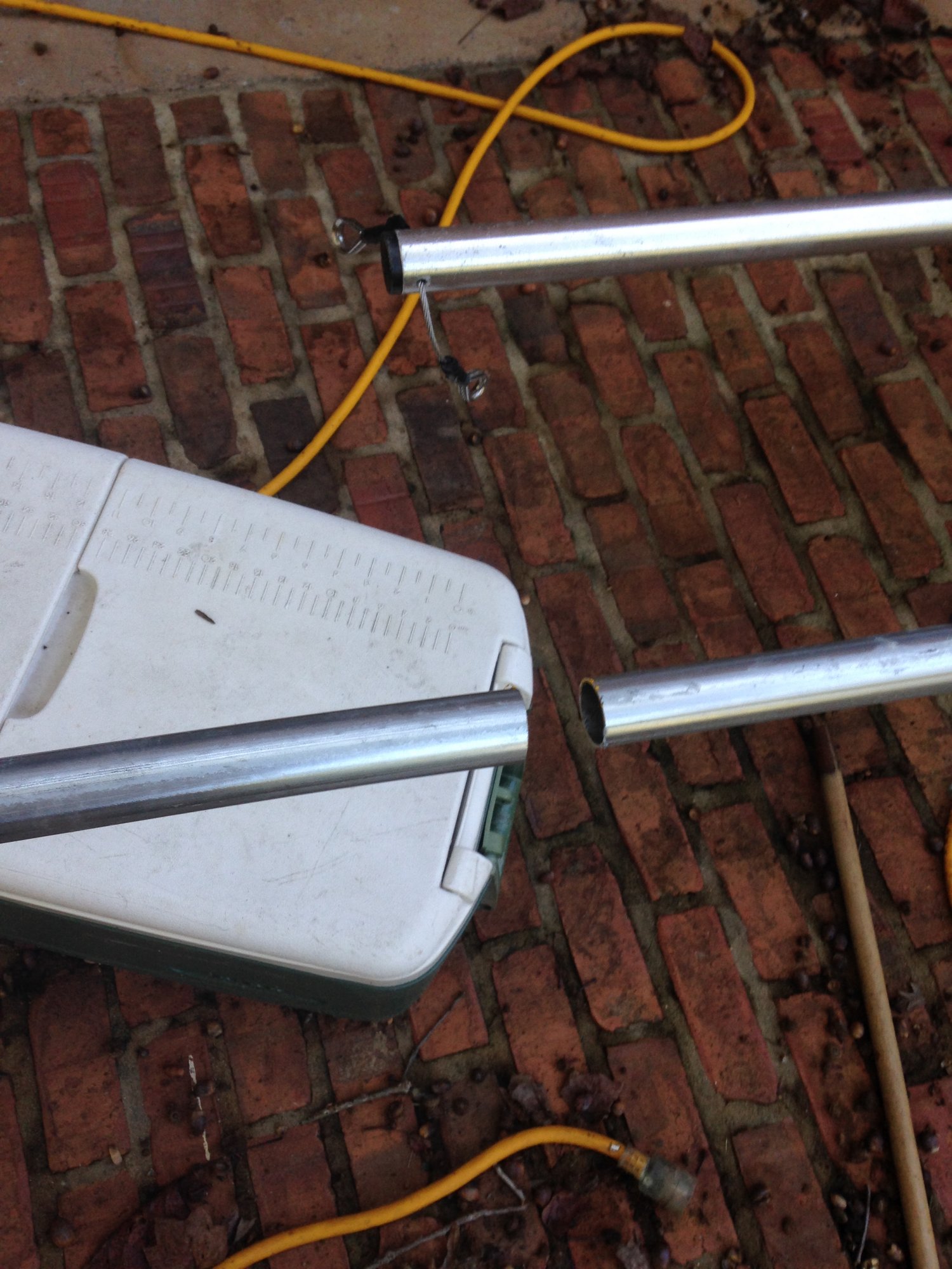

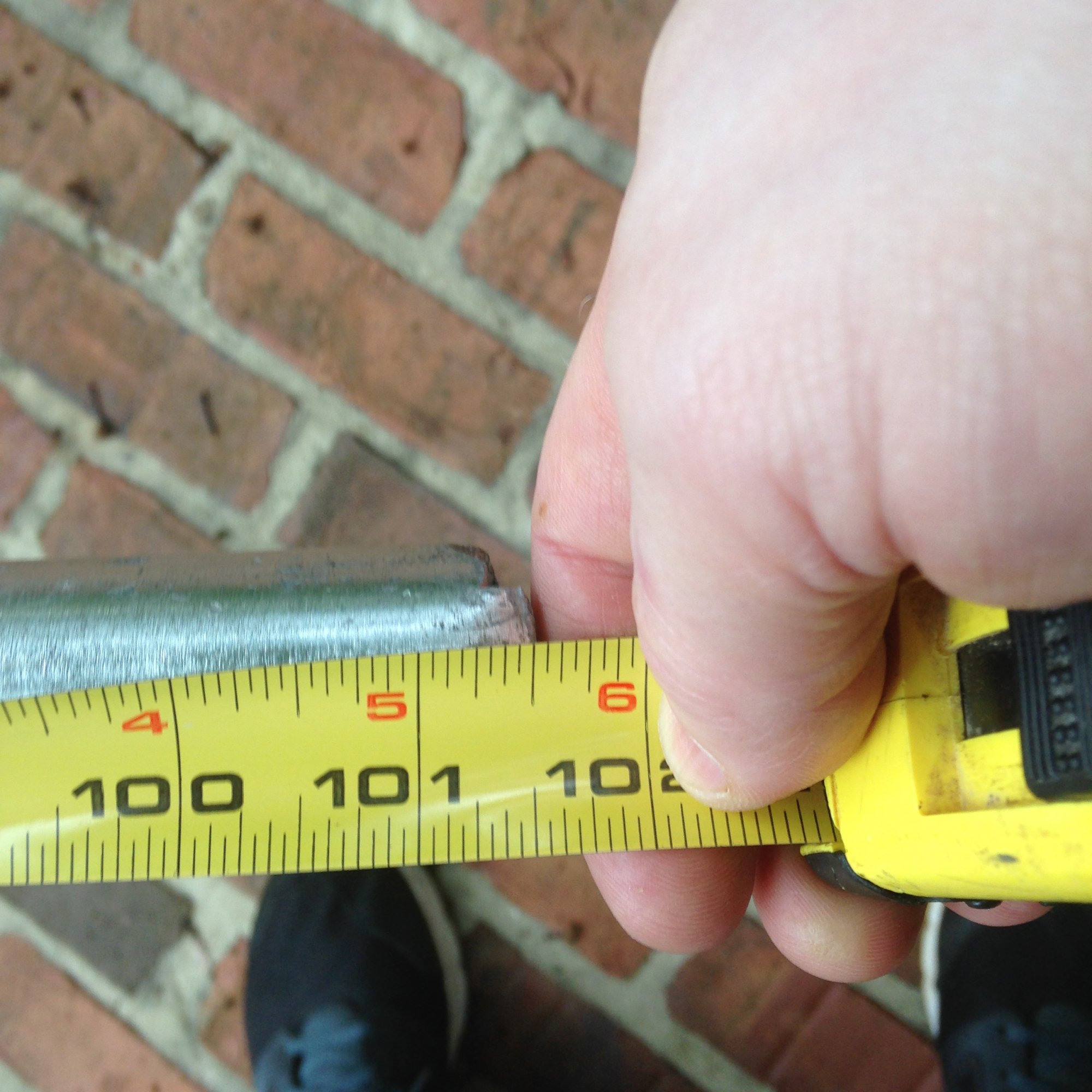

Do you need to repair the lifting pole? If so, you are in luck. The pole is the exact same diameter as chain-link fence poles. I can post pics of that rebuild if you need it.

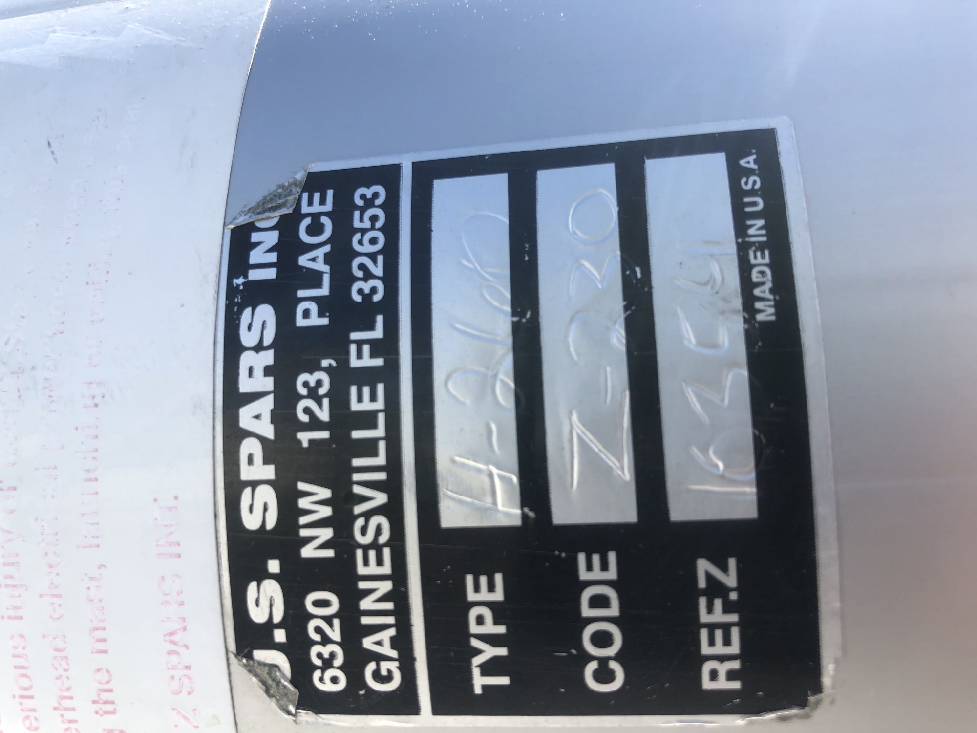

Spoke with the owner. No sailboat dealers in state. Jib halyard holding mast raise pole held in place by rope clutch. It was released accidentally when a foot hit that lever due to a kinked shroud I think. B The mast came down backwards held in place from going sideways due to mast stabilizer bars hitting aft mast carrier from the up position.
The owner is a new sailor whom he bought from a broker who did not show much to this new sailor. In fact the yard charged $300 just to take the mast down

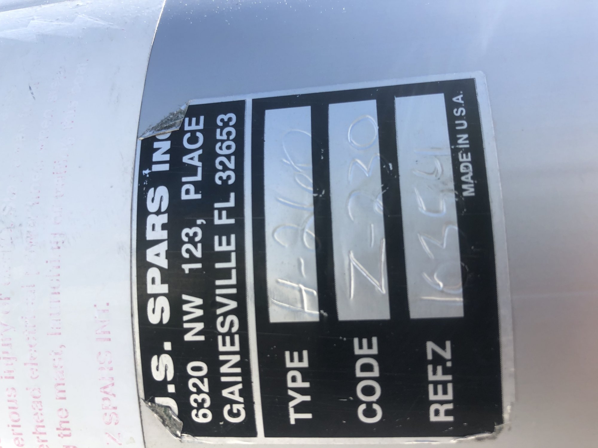

Photos requested where mast hit aft mast carrier to see if damage there as well as to where mast carrier is attached to stern. The mast is U S Spars formerly Z Spar. Happened yesterday to this veteran. I told him to report claim to USSA tomorrow and give his adjuster my contact info as I was a former adjuster/investigator who use to handle boat claims

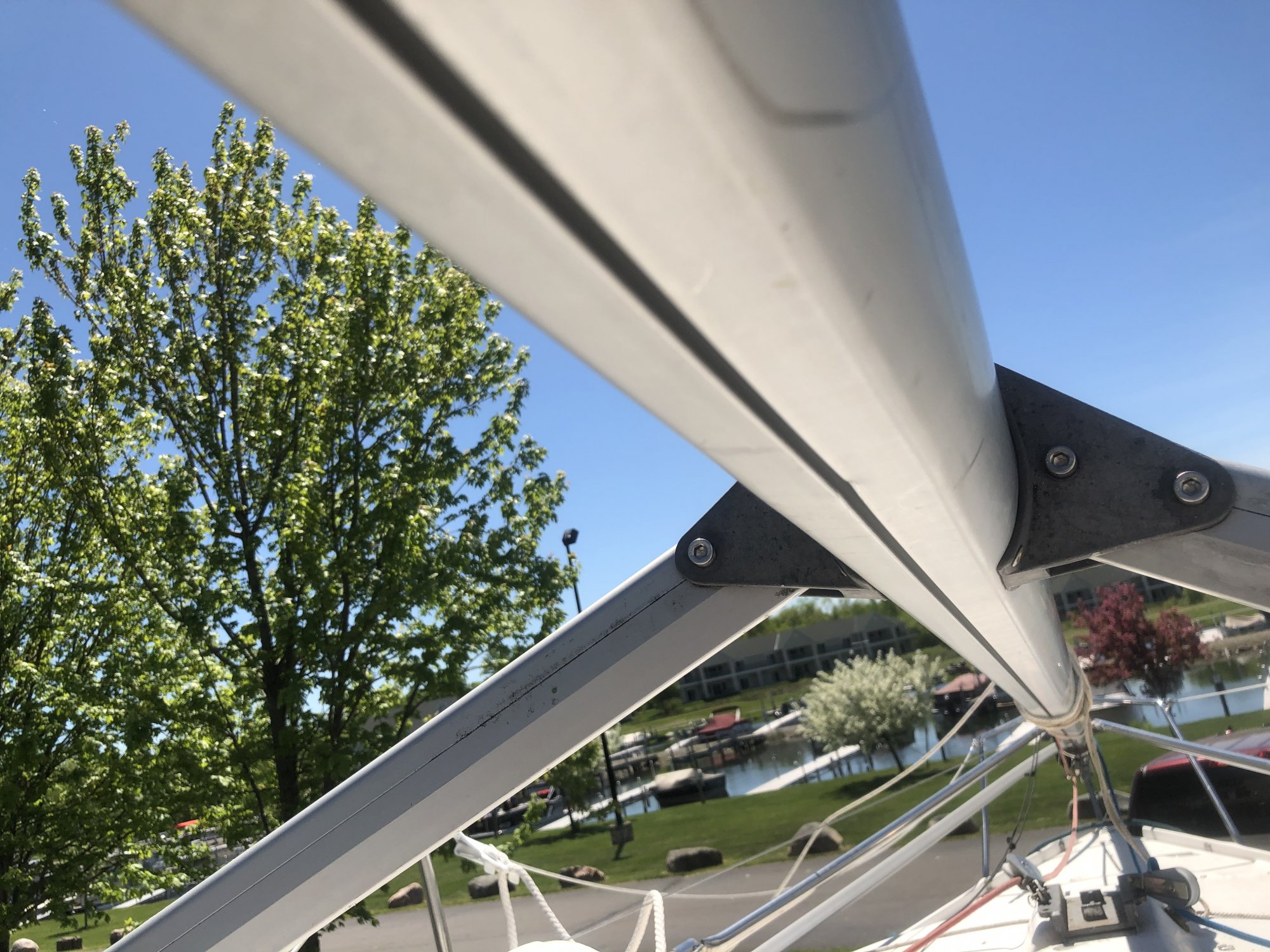

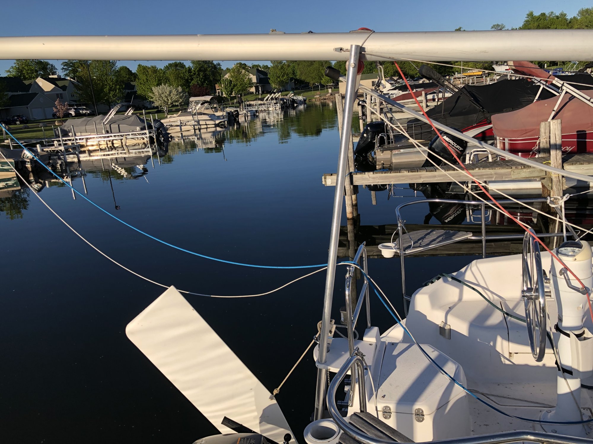

Thanks for the responses guys. Here is a picture of the plate on the mast, and some more of the carnage :wahwah: My boat is insured through USAA - which subs Progressive. I'll let you know how it goes. She's out of the marina now and back on the trailer. The mast was pinned and 90% up but we noticed a stay was crooked (on the port side, right over the line stopper for the jib halyard). As we crawled up to see how we were going to address it, tragedy struck.

You may have gotten lucky.

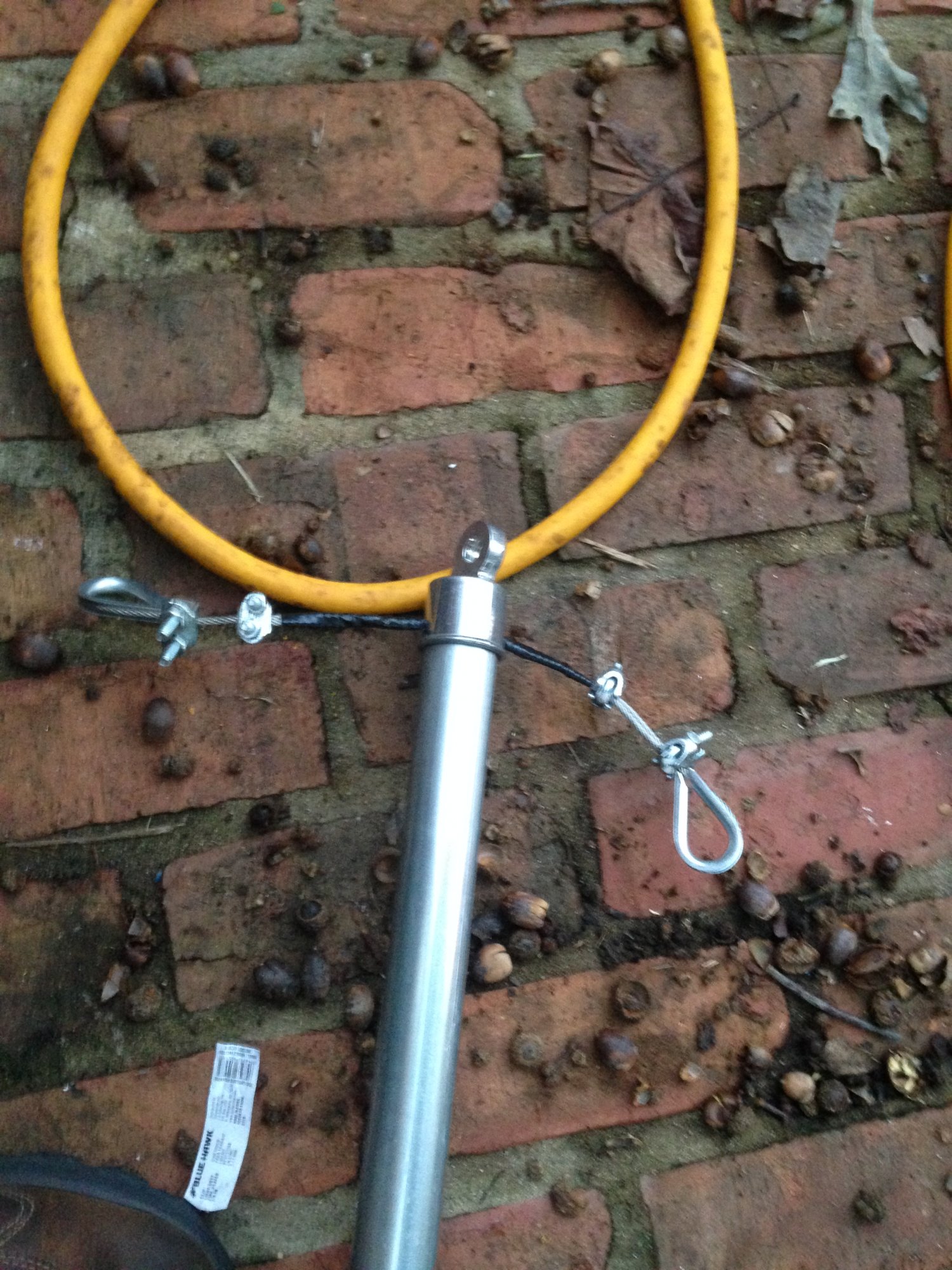

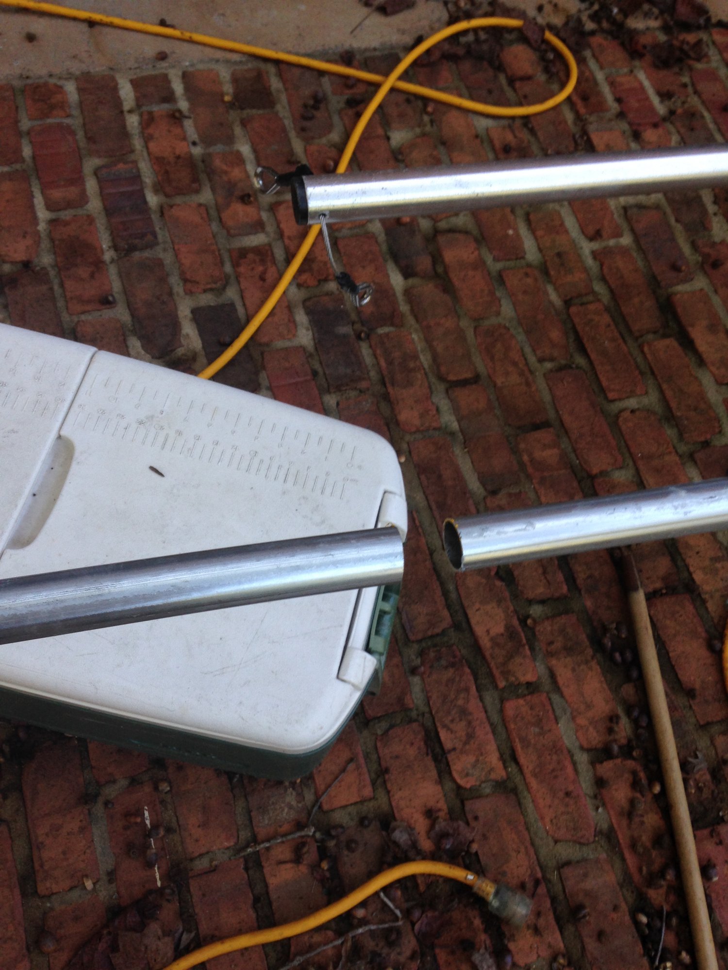

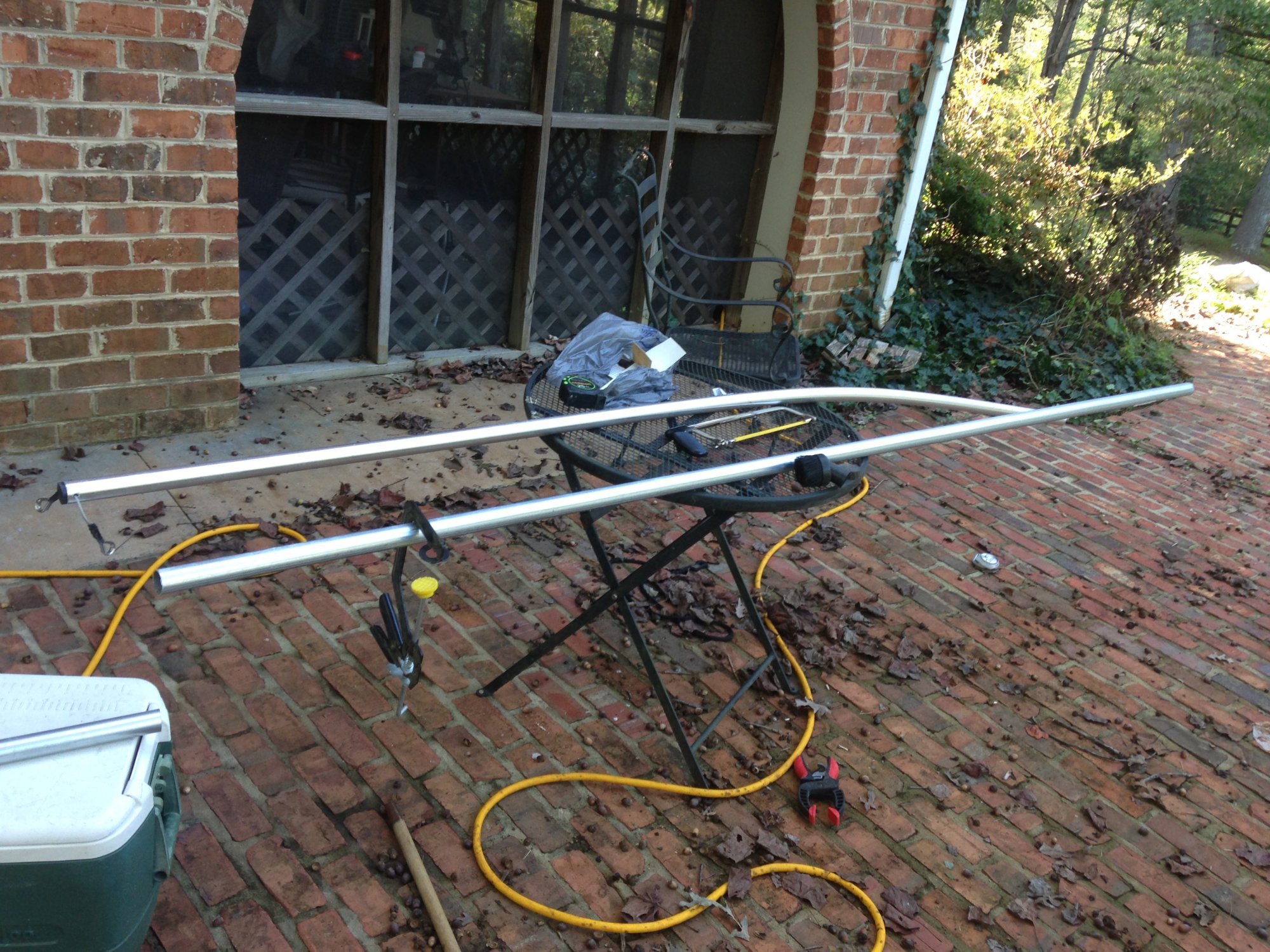

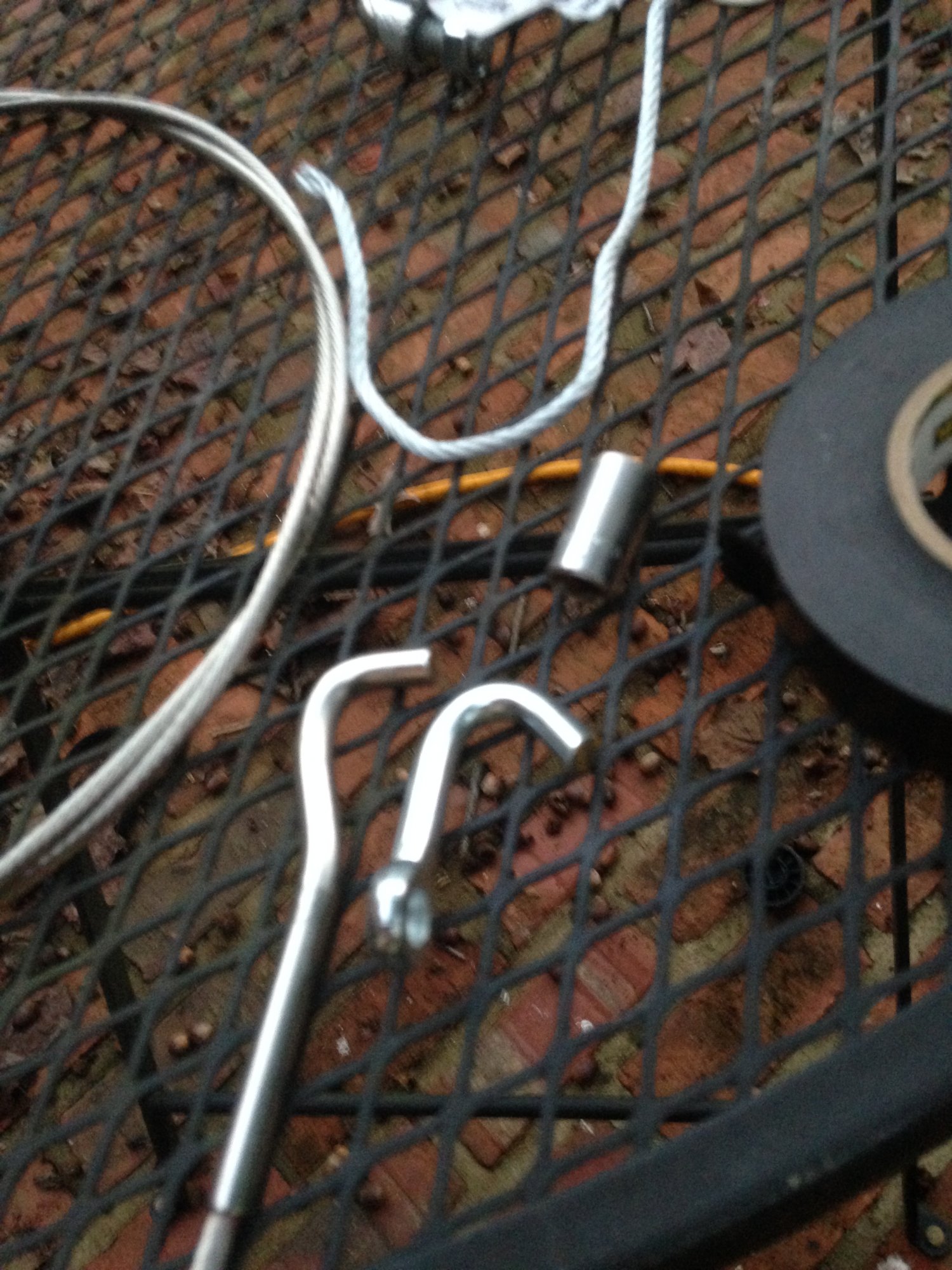

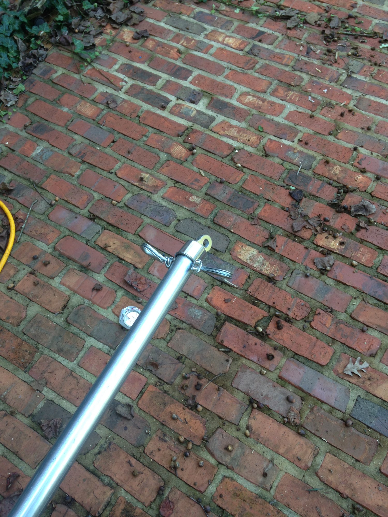

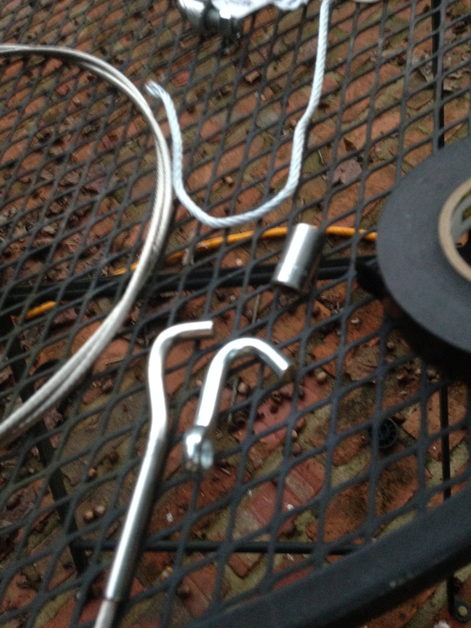

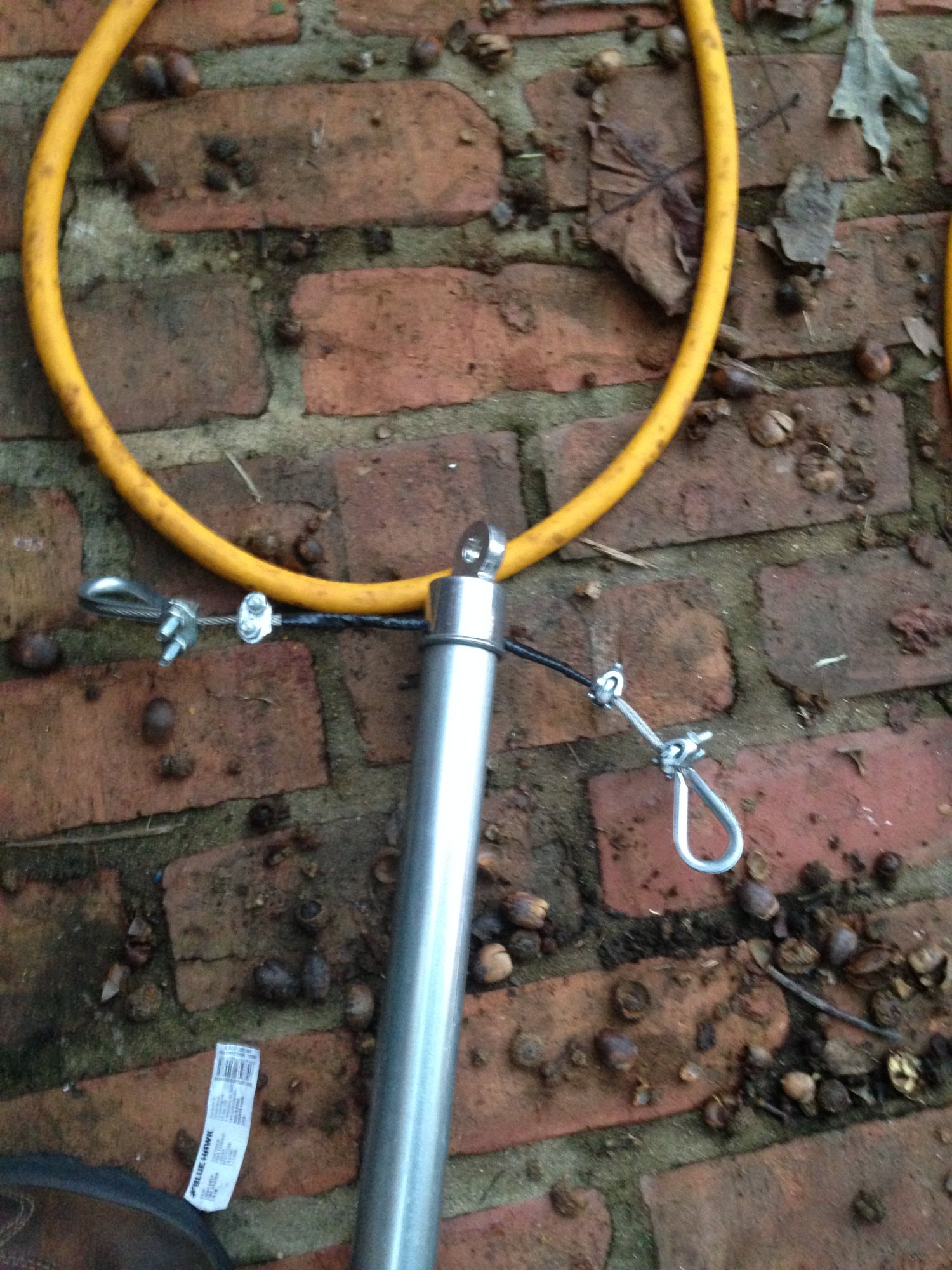

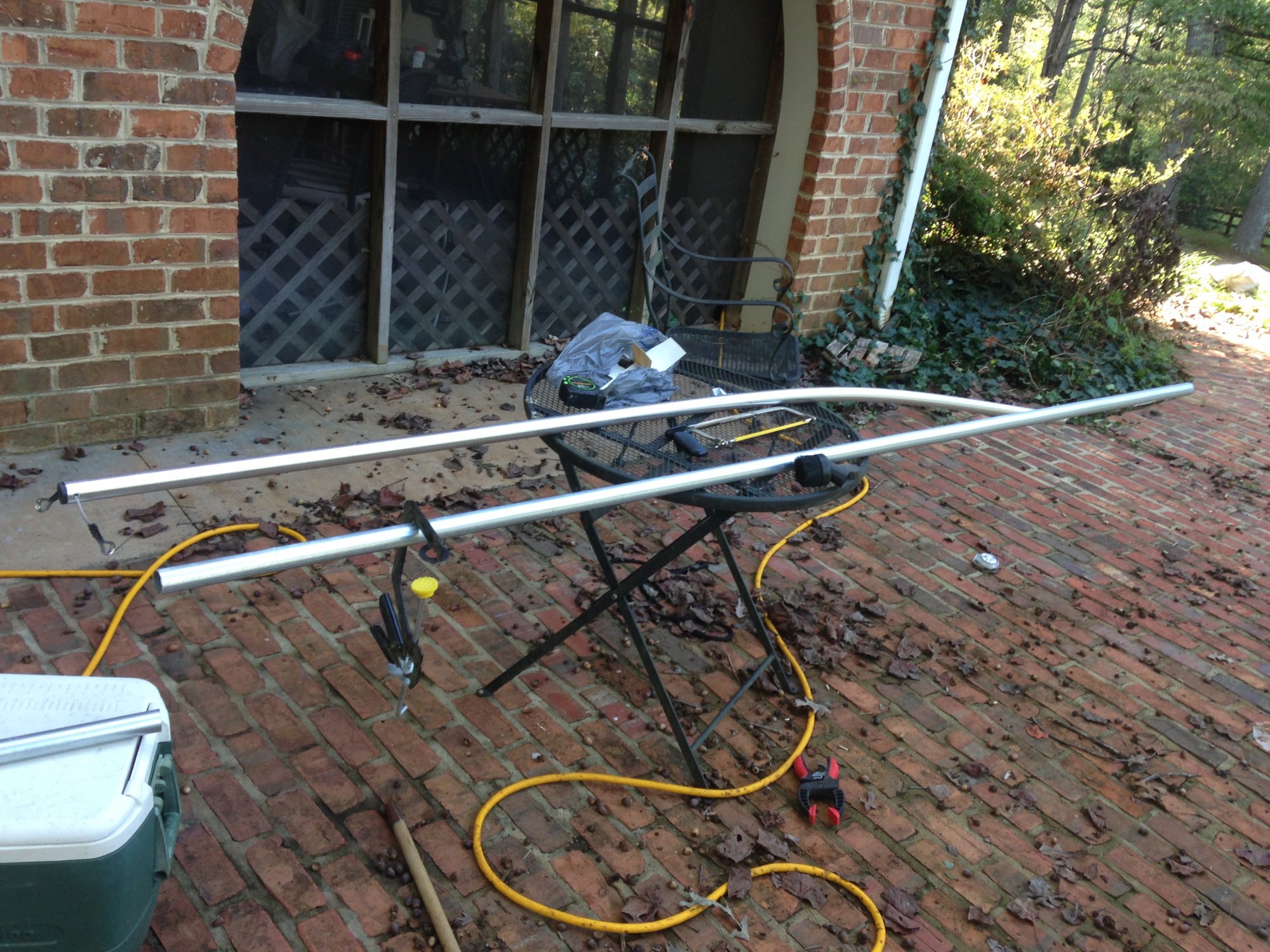

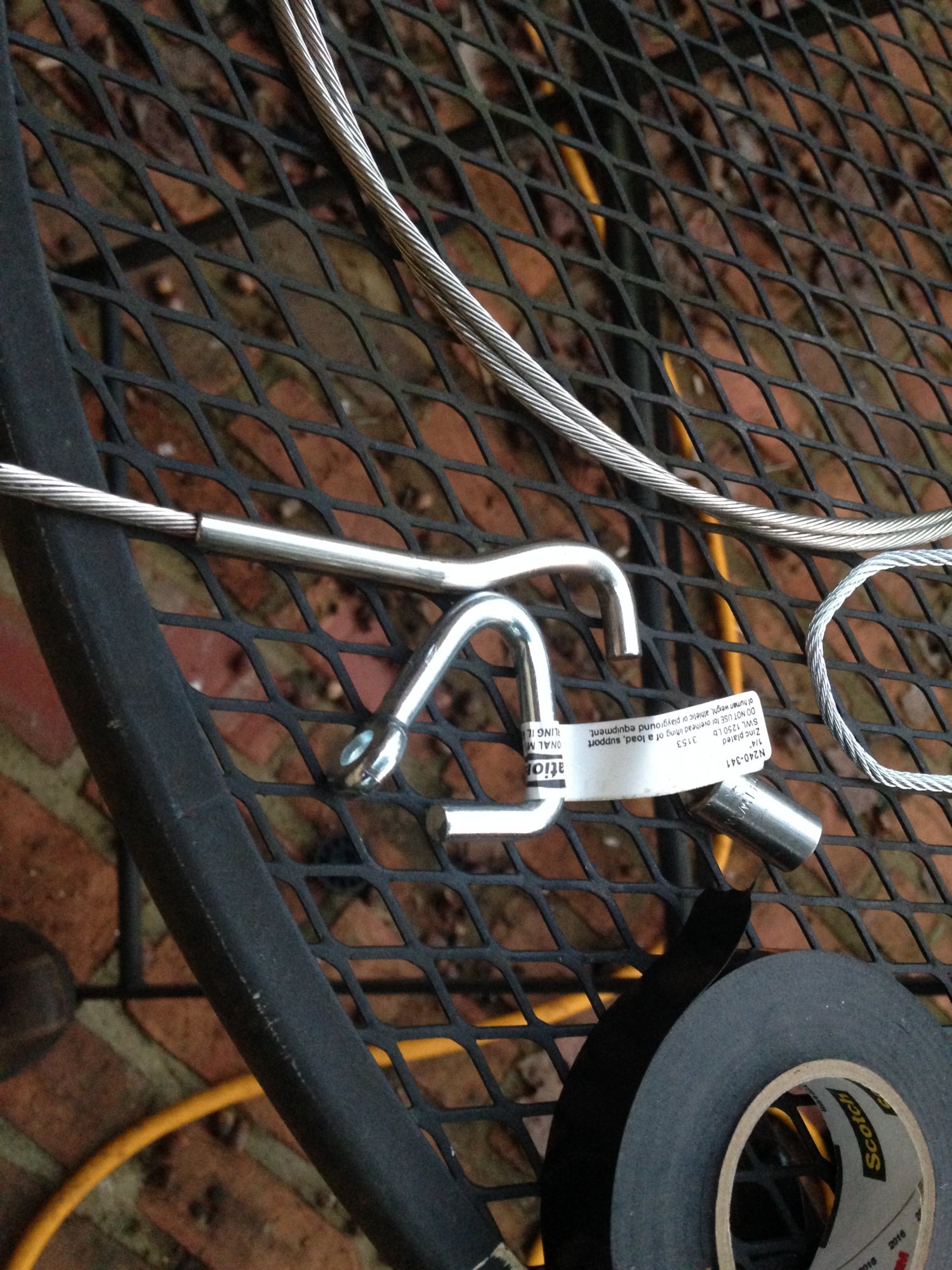

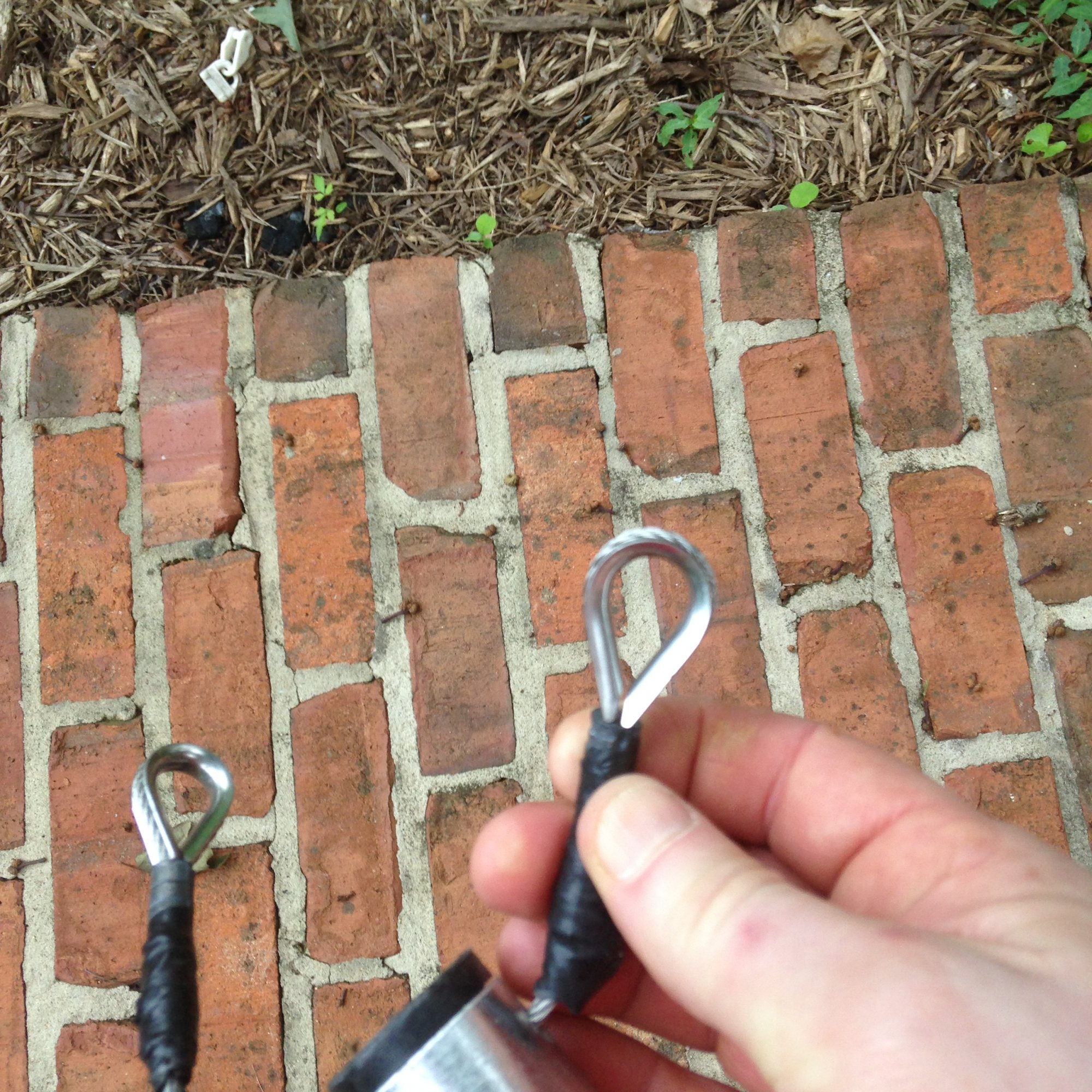

Here are some pics of when I had to build a new mast raising pole.... Like I said in the earlier post, the pole is exactly the same as a chain link fence pole... (Lowes or HD).
13,096
Sadly, I got more mast and rig repair pics if you need them.
