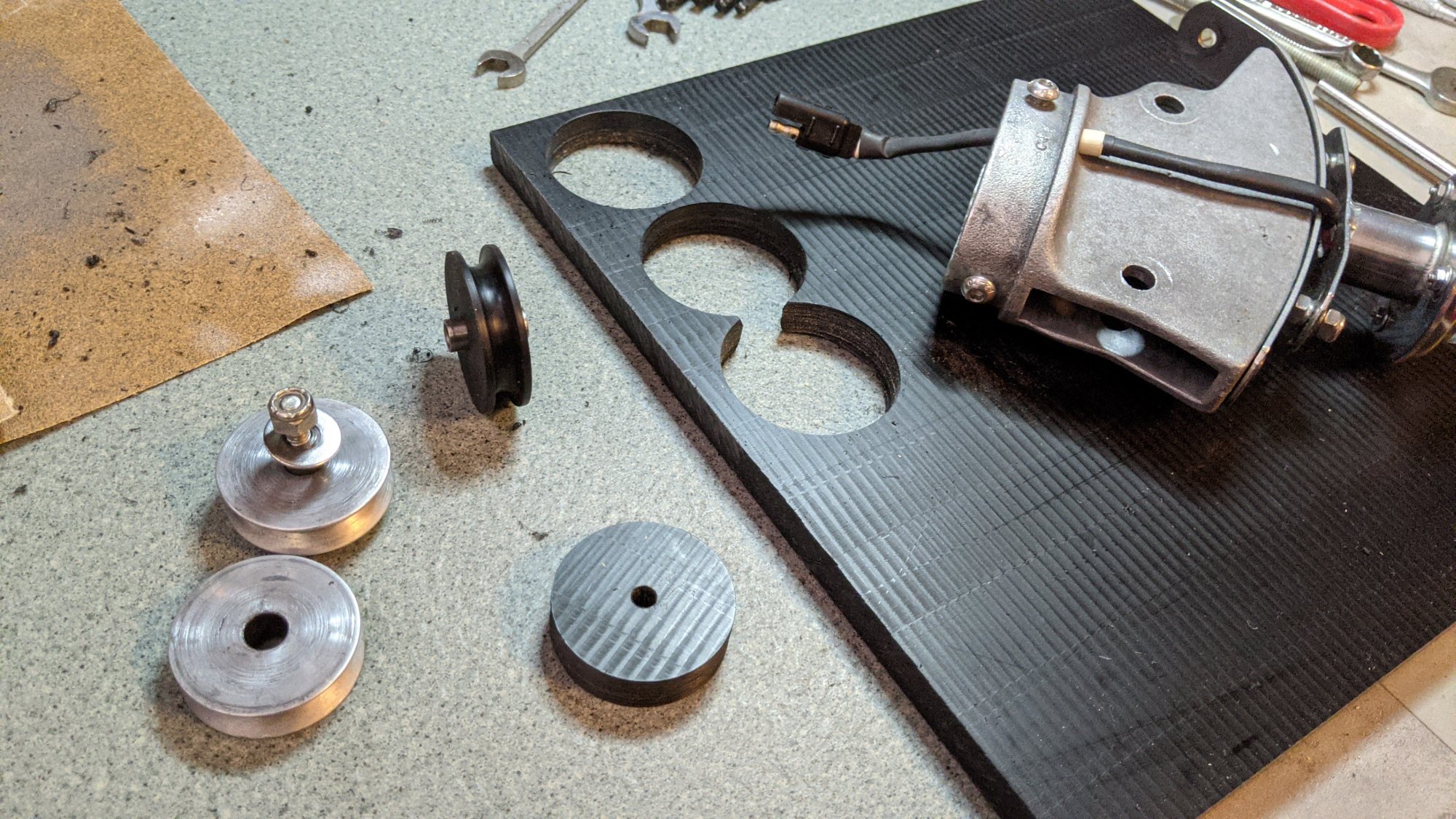

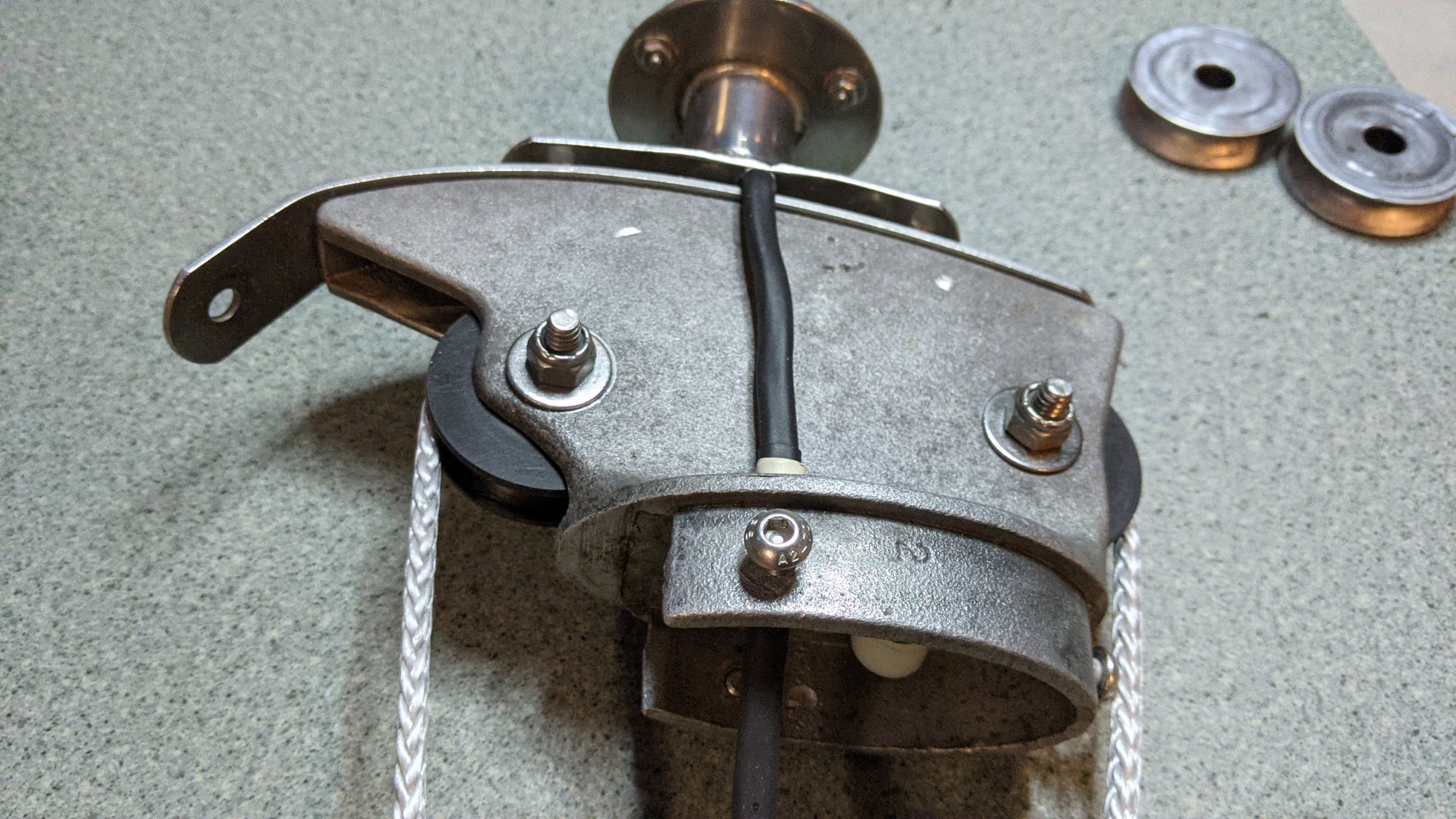

One of my little projects for the winter was to make new sheaves for my masthead which I hope will be a little friendlier to my dyneema halyard than the original aluminum sheaves. I cut blanks out of a sheet of delrin with a hole saw, then shaped them in my drill press with a round file.

May be OK inside the masthead casting though, no? If not, he can reshape the aluminum sheaves to make the channel for the line more rounded and flat-bottomed, instead of v-shaped.
Jul 27, 2011
5,134
Bavaria 38E Alamitos Bay
Depends on the Delrin some is UV stable.
OK. It looks like he’s used the UV stable type, which is black. My (limited) use of Delrin has been with the original (white 550) type, which does slowly deteriorate, and crack. I see it has been discontinued & replaced with 511P. Good to know about the stabilized version;). Always learning new things here:). Keeps me logging on!

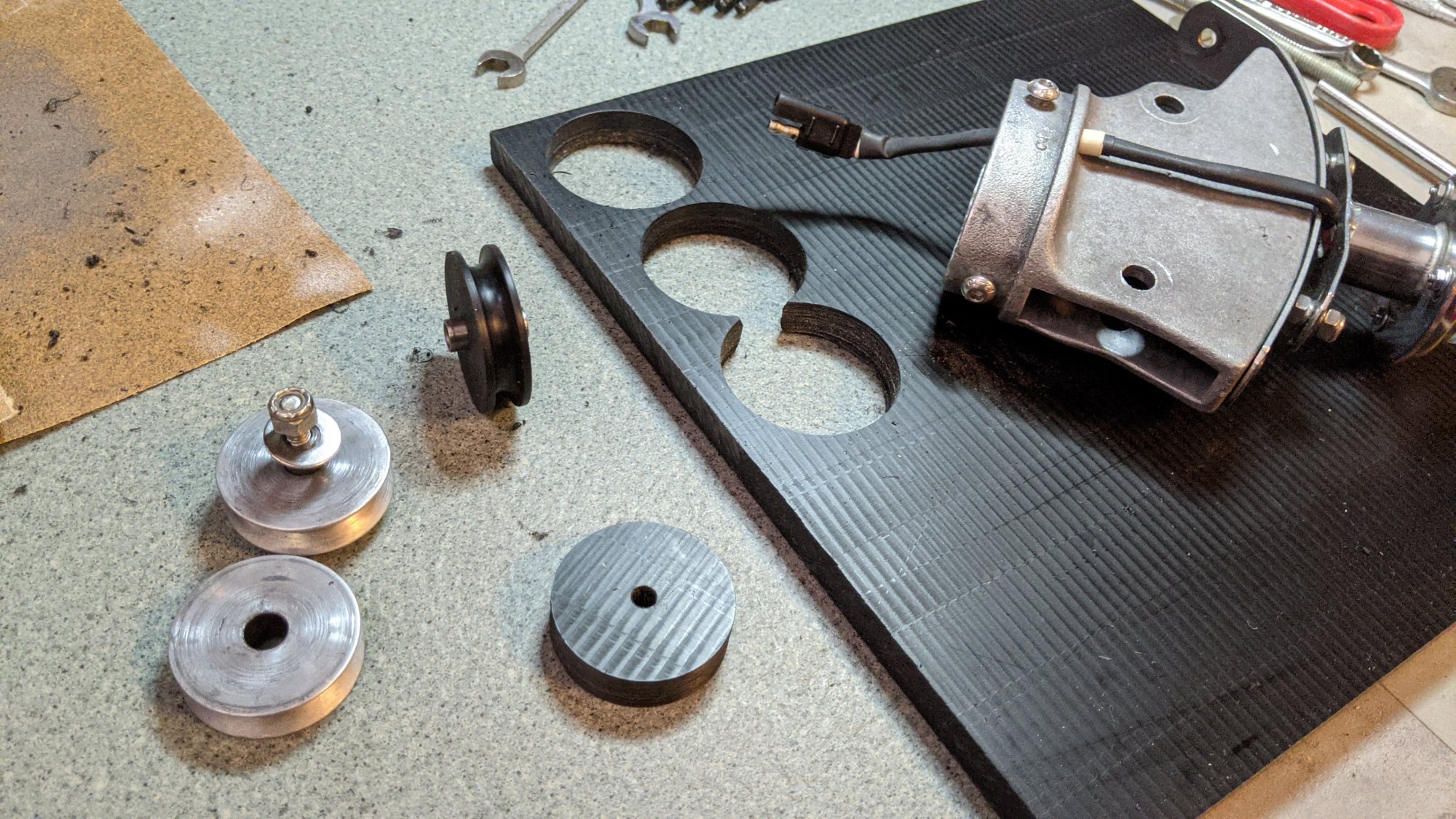

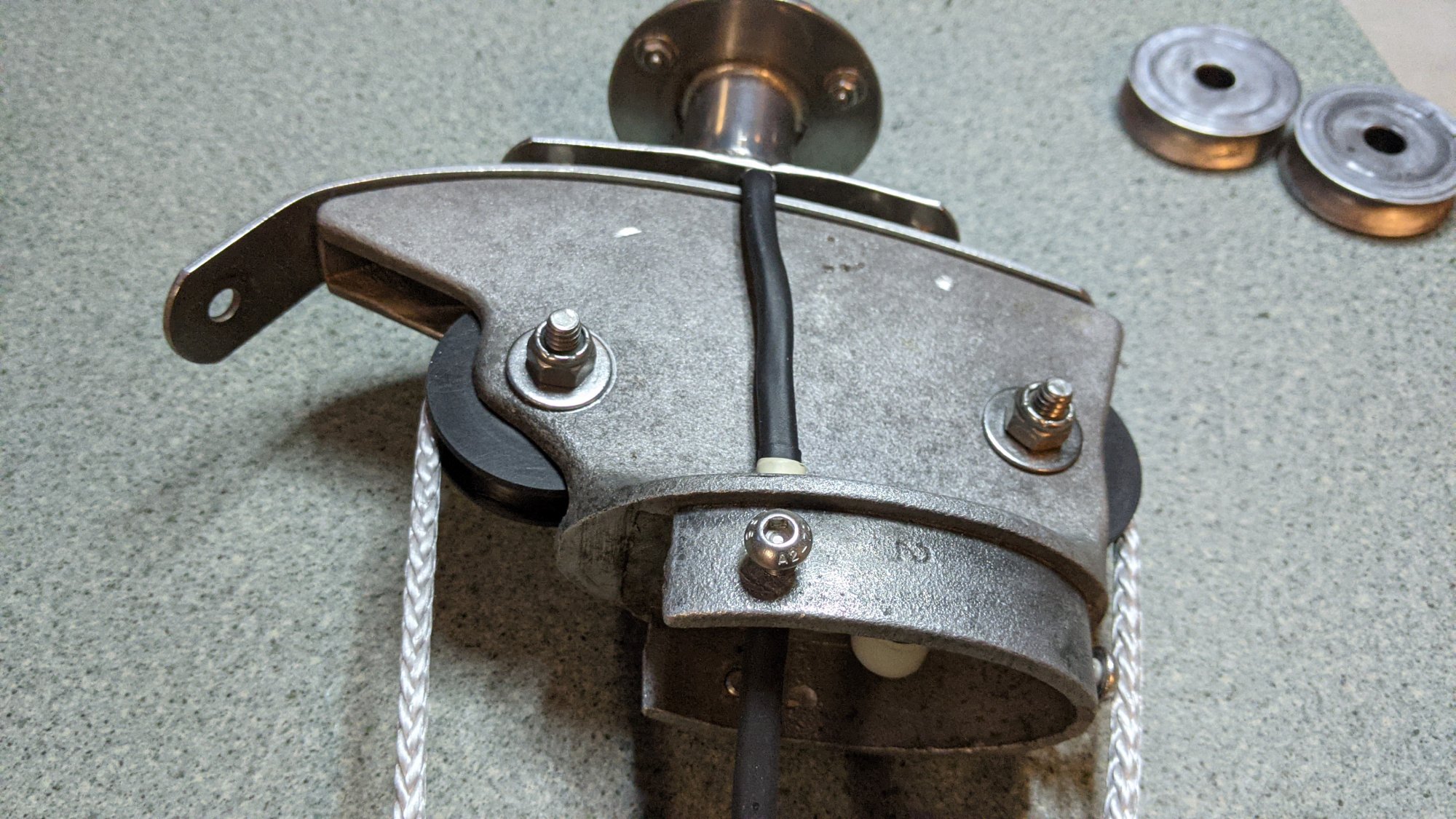

View attachment 189458 View attachment 189459
Just out of curiosity, what was happening with the original aluminum sheaves that you felt the need to switch them to the acetal copolymer sleeves?

Very nice inventive solution. Although the aluminum sheaves appear to have rounded bottoms, perhaps the Delrin will work better. Our originals are white synthetic material of some type. Likely need to replace at some point due to the wear over the years. Good idea of yours. I've got the tools to make my own as you did.
They were working fine. The halyard rides a little high in them, but it never caused any real problems. I just can't leave well enough alone.
The material I used is Delrin 150E, which is not one of the grades marketed as UV stabilized, but I'm not too worried about it. Maybe I'll lube them with SPF50 or something.
Good to know.
You may wish to keep them, perhaps making the groove a deeper so the halyard does not ride high and if, hopefully not needed, the delrin does degrade, you can simply put those back in.
One thing I did notice was the outer surface of original sheaves showed wear patterns on the outer surfaces that indicated to me that you could improve those by adding in a thin polymer washer to improve the way they work in that mast head. It they were mine, I'd put them in a lathe, turn down a recessed surface to insert a washer that would stick out only a few thou, keeping the sheave from rubbing against the mast head. Just a thought.
