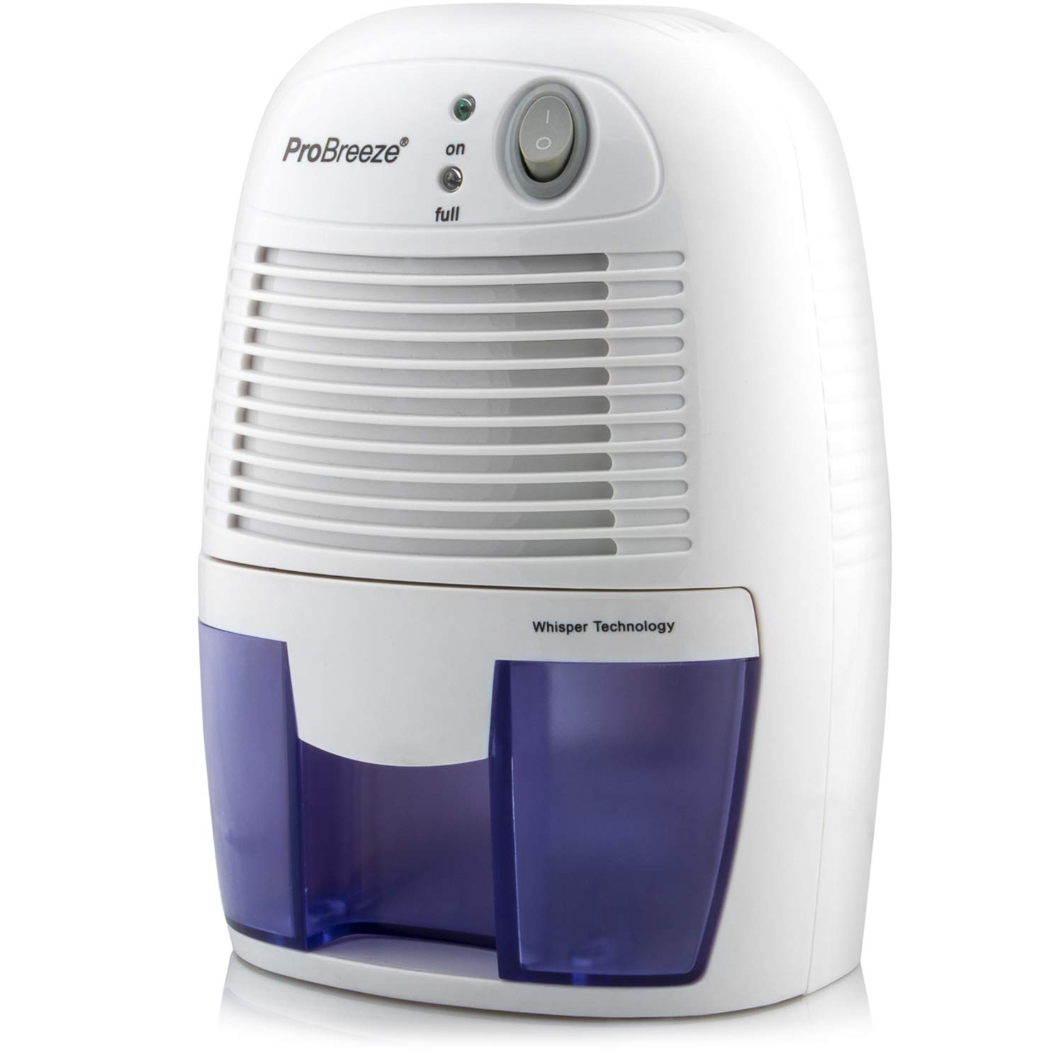

I have this one: https://www.amazon.com/dp/B01DC5PPWM/ref=dp_cerb_2. I used it in the boat while on a mooring in Florida for a few months. Like others, drilled a drain hole and led water into the sink. The unit says it runs on 9v dc which is provided by the brick inverter that is supplied. The fine print on the inverter said its output is 12v dc. So I hooked it up to my dc system that is powered by a single 100 watt solar panel. It draws about 2 amps at 12v, so I put a timer that limited the dehumidifiers run time to 3 hours every morning to keep the batteries from running down. Worked fine.

I have one of these. It will fill and stop in about 5-6 days during the summer. I'm looking for the right fitting to tap into the bowl so I can drain it into the sink in the head. 7 x 6 x 11 inches

I use these in both our boats, they are fabulous. I just drilled and tapped the water reservoir, and installed a nipple and a piece of hose, which drains down the sink. Both boats stay fresh as a daisy.
https://www.amazon.com/gp/product/B001QTW6KQ/ref=oh_aui_search_asin_title?ie=UTF8&psc=1
I keep one almost exactly like this in my Catalina 27. I took out the float for the auto shutoff and drilled a hole up high in the tank. That way it will just run continuously. I keep it in the galley sink so that when it drains out of the hole it just goes down the drain.
