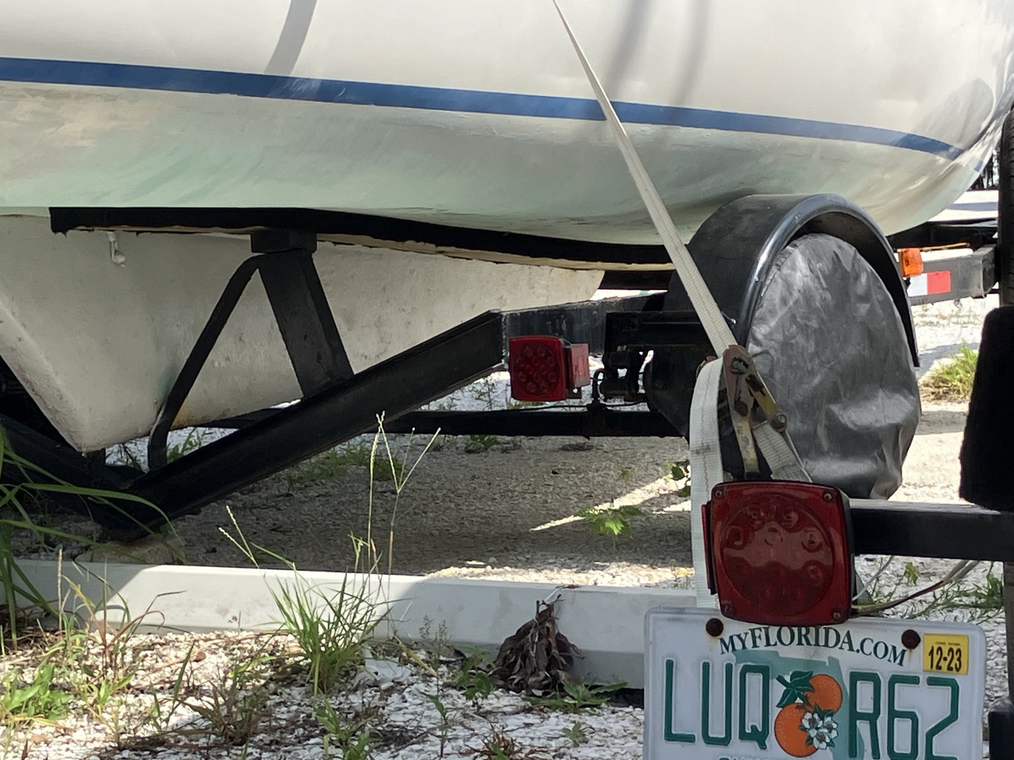

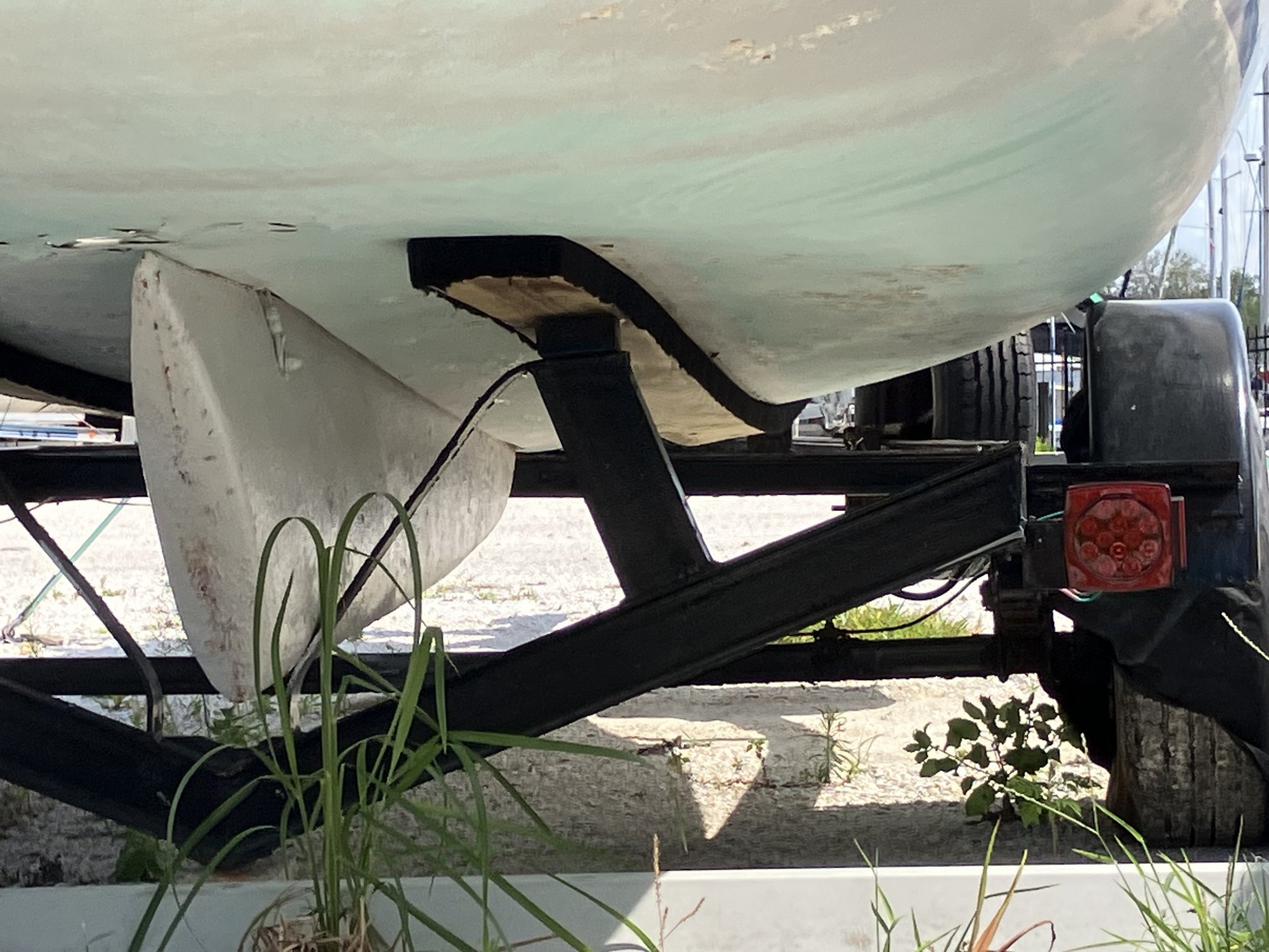

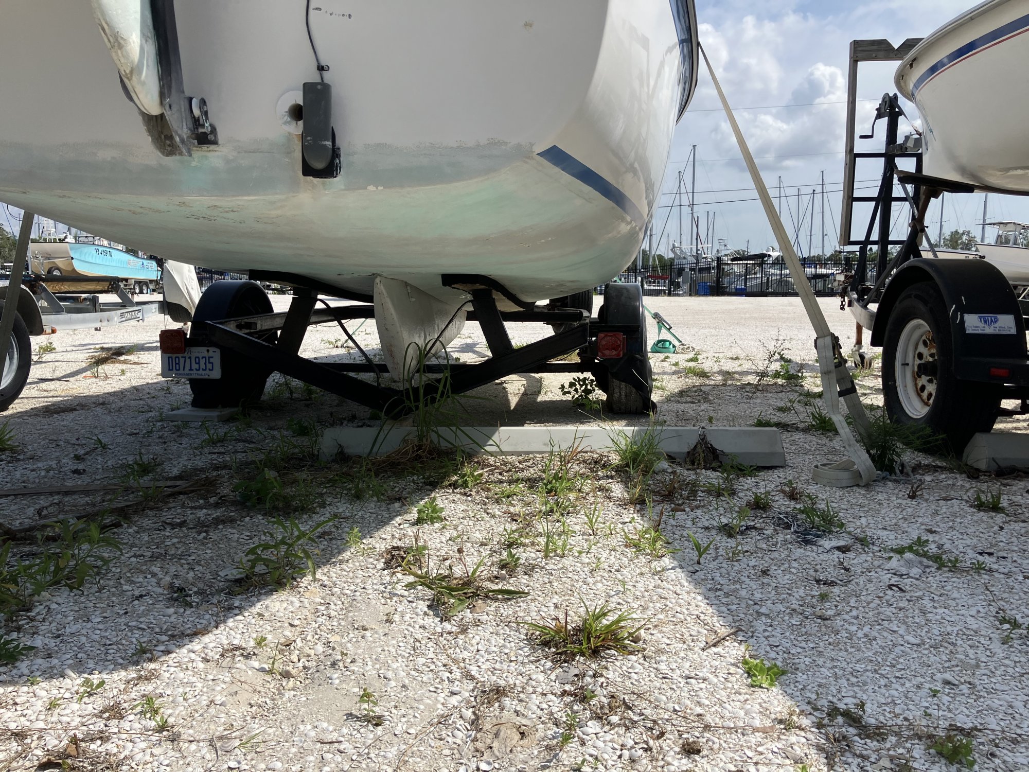

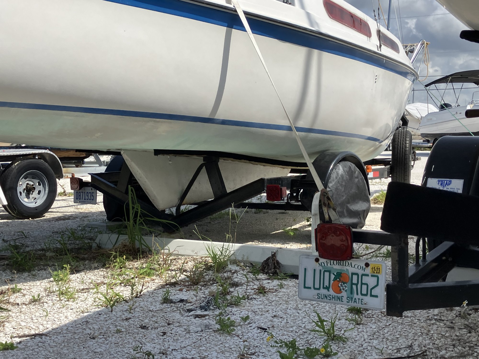

I need some advice. I’m looking at a used 1984 Macgregor 25S. It looked like a pretty nice, well maintained boat. It comes with the original, factory trailer. They want $5,000. My concern is where the bottom of the boat sits on the bunkers. On the Port side at the rear of the bunker the bottom of the boat is caved in or oil canned about 2 inches. On the Starboard side I would say it is about sunk in about 5 inches. Is this a big problem, or a small one? Should I walk away from this thing?

Yes, almost for sure walk away, especially at that price - which is closer to what you might expect to pay for a boat that is ready to sail with no serious work.
It might be the sort of thing that, if you got it for free, might be an achievable project. But, it is almost certainly not something you would want to pay for. The fact that they are asking $5000, itself, is a red flag that they are looking for someone who doesn't know what they're getting into. It reeks of dishonesty or ignorance - neither really signals someone you want to buy a boat from.
Depending on the exact cause, that "can" be repaired. It looks like the problem is that it was improperly supported on the trailer for a long time ... in the heat, causing the hull to gradually deform. The repeair depends on some specifics, but there is no good scenario that I am aware of.
I see that you are already thinking of walking away. Good Idea! While it is not unheard of for a boat stored on a trailer to develop some indentations, be aware that this is governed by design, engineering and adequate inside structure. The builder of that boat was considerably below Catalina in all regards. (Rigging was quite light on their boats, also.)

Honestly, it looks like the trailer's design does not fit the boat's... That style boat will have a rather flat bottom towards the back half... whereas the trailer's supports look contoured, upsweeping somwhat as an attempt to support the swing keel's casing. The trailer should support the bulkheads, same as when you position a crane's swings when lifting a boat out of the water.
You might ask the owner to drop it in the water, perhaps the hull will spring back to the proper shape. If so, then you can consider refining the trailer's support boards, and reinforcing the boat's bulkheads, so both are working together instead of being in conflict.
That said, it'll be easier to find another boat, one that has a conscientious owner who has already dealt with the glaring problem and would never thing of showing a boat with such an obvious issue. Good luck.

As a former MacGregor dealer , I will chime in. It appears that the trailer could be the original trailer. There are issues. The starboard bunk board should be supporting the hull all the way; however, you can see airspace between the bunk board and hull which is not good As for bunk board itself, it may have weakened or broke at top of the rear support worsening the situation. There is no third support nor are they adjustable either. The trailer needs a lot of repairs. As a result the hull is deformed which is not good. You do not know if the structural ability has been compromised. If you do consider this boat, I would suggest that you have the owner put the boat into the water and run the motor too.
With the boat in the water do check the starboard inside hull adjacent to the swing keel housing for any water intrusion inside.
The 40 year boat sold for appx. $10,000 to include trailer and motor new. Due to hull damage with repairs needed for the trailer, I would not offer more than $1200 to $1500.

Those are some good thoughts. I may try to get the boat in the water this weekend. What you probably can’t really tell from my pictures, is that the trailer is very short compared to the boat. There is a lot of boat hanging off the back unsupported. That is very possibly the origin of this problem. You would have to weld about a three foot extension on the back off the trailer, and make the bunks longer. Welding and fab work is right up my alley, but I’ll have to decide if I want to go down that road. The price would have to be right to even think about it.

There's some problems with this boat that some of the replies have not mentioned even though generally accurate and well meaning. As an owner of a Mac 22 S I'd like to mention a couple problems that hasn't been addressed even though obvious. I don't think you can buy a brand new trailer, a new set of sails, a new outboard motor for 5K. Looking at the picture of the oil caned bottom I don't think you have a problem because that is typical results when you leave the keel held up into the boat from the travel position for a year of non sailing on the hard. If you make a big thing about how bad it looks to you before you make the purchase you can probably take a few boat bucks off the price from the seller for the (potential) repair. Before you purchase the boat you shouldn't mention that storing with the mast up and clamping the boat to the ground will cause extra stress(weight) to the boat bottom. (although it's OK to strap the trailer down) It's a sailboat you will not see any speed over 10 miles an hour except when the boats on the trailer behind your rig (even with brand new wind).

I dont know that boat.. but to echo the post just above, thought I heard at one time that the keel should be resting and supported by the trailer. Ie, the heavy keel weight is supported by the trailer and not through the hull to the trailer bunks. Pictures in the first post sort of look like the keel is suspended off the trailer? I think likely your main issue buying that boat is that if you cant get everything working like its supposed to (and maybe the dent even comes out), when you go to sell, everyone who looks will have the same issue you are with the dent. Could be a good boat but should come with a huge discount over the asking price. This all assuming there isn't any structure damage and that its just a dent. Just another opinion..

There appears to be some flaking of paint at the aft end of the keel trunk, especially on port side Would check the fiberglass carefully for cracks in that location
