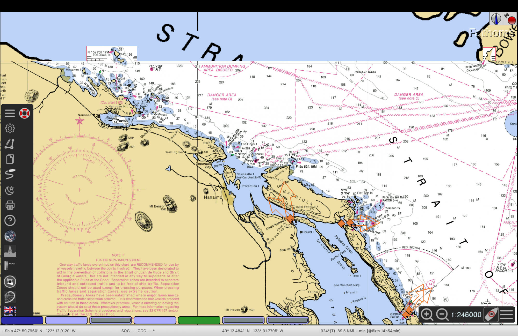

Here is OpenCPN on a MacBook OS system.
The orange dots and arrows show the current direction and tidal location. The chart stops because the FREE NOAA charts stop (this is a NOAA raster chart "RNC" - soon, all that will be available are Vector charts "ENC"). One must pay for the Canadian charts to continue coverage further north.

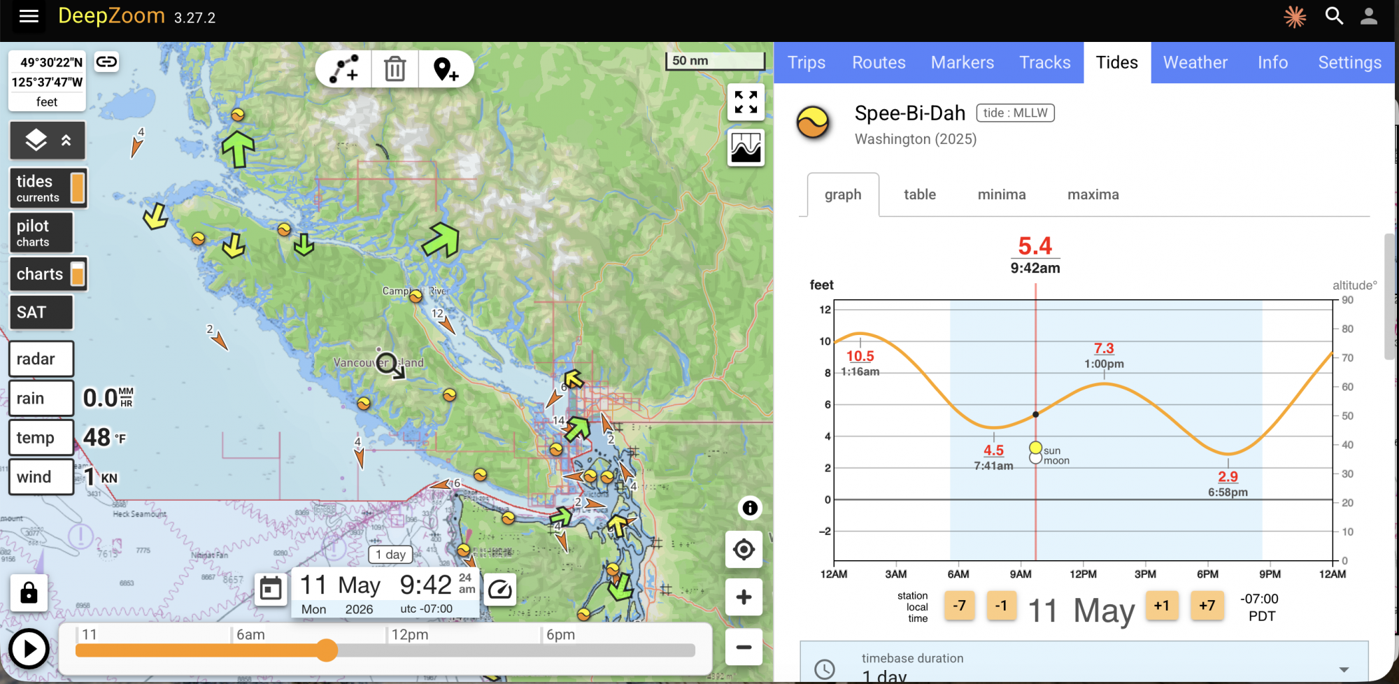

DEEPZOOM is online-dependent. The need for access to such data and weather forecasting, when you adventure north of populated waters, supports the expenditure of boat bucks for tools like Starlink. :biggrin:

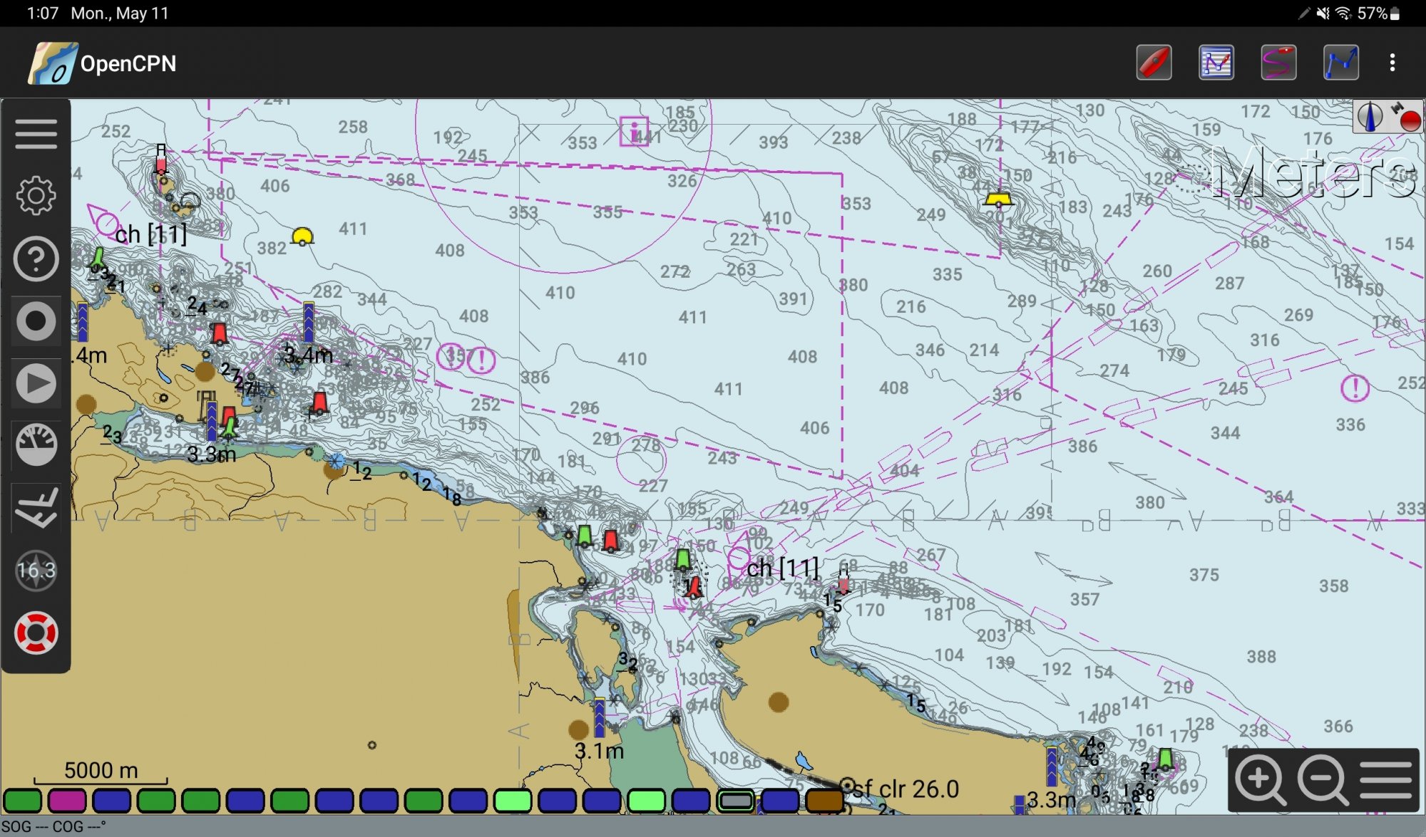

CHS ENC (vector) are available via CHS, BUT are very pricey(!!). However, o-charts (charts for OpenCPN) only charges 10€ for the whole Canada Pacific coast and these are identical to official CHS charts (and the charts do not expire... updating after 1 year requires 10€ renewal). Other chart sources are also available for CHS charting, such as Navionics, C-MAP etc. All cost. Updating of these are not simultaneous with official chart updates.
O-Charts at large scale (on OpenCPN for Android):
