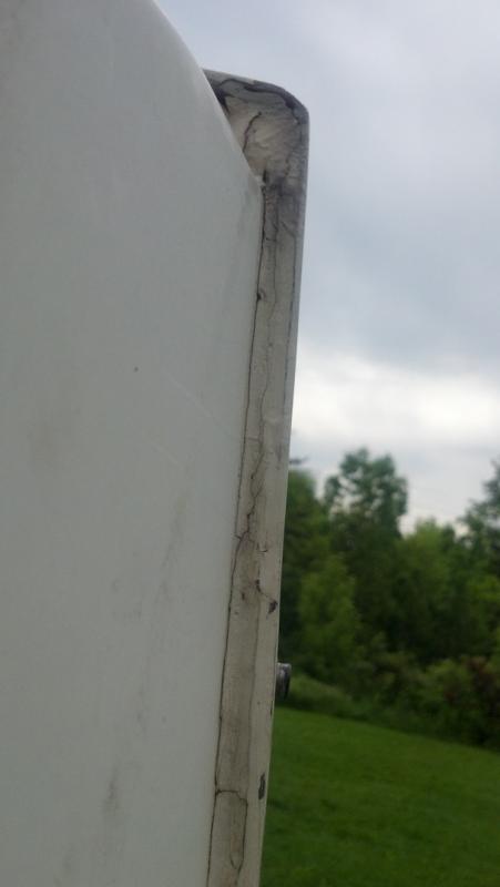

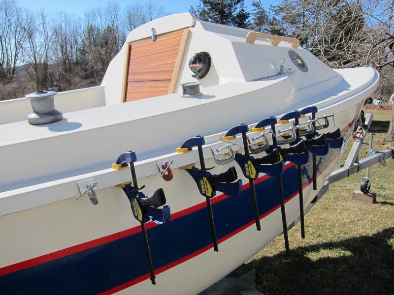

Well,I finally got around to this repair.I ended up using a cake frosting spreader and put sticky 80 grit sandpaper on both sides.Worked this "tool" up and down into lip joint and successfully cleaned out enough old adhesive to clamp up the joint tight.Then I was able to squeeze plenty of 5200 in.It now sits curing for a few days.I'll post some pics when I get a chance.Thanks for all the friendly advise.:D

Here's a shot of my handiwork.Going to let the 5200 cure for a week then remove the clamps.You can see the new compass installed my buddy gave me that he had laying around.I owe him one.:dance:

That is a sweet little boat! She looks just like brand spanking new in that picture.
I would seriously think about buying an Aluminum gunwale molding with the rubber insert for this boat though. That way, you could sail right up to a padded dock without bothering with fenders. I do this all the time with my O'Day 222. If your boat ever bounces off something hard like a navigation buoy, the molding would take the shock and prevent serious damage to that seam that goes around the boat. I hate to tell you how many of those darn things I've hit. If you've ever sailed in a river with a current, it seems as though these steel monsters just draw a boat to them like a magnet.

Good news,The 5200 worked very well and is holding fast.Looks like original fit.I left the clamps on for about a week to fully cure.Not so much as a creek when clamps were undone.5200 is amazing stuff!:D

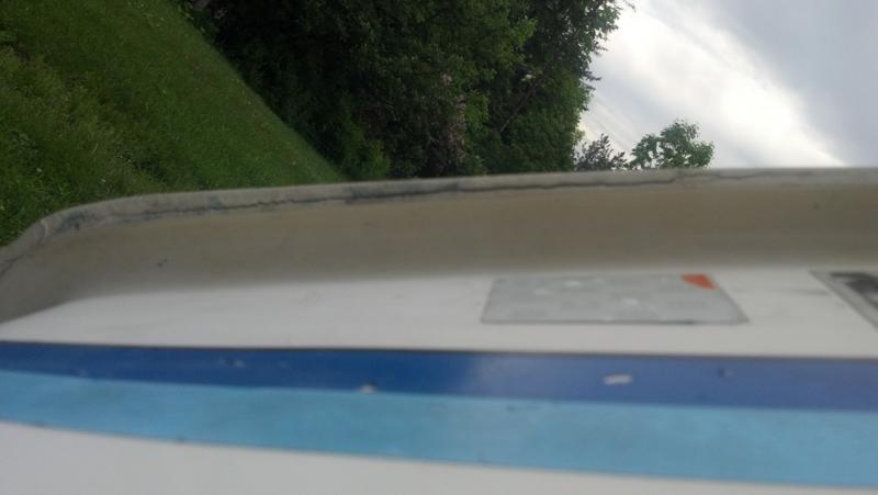

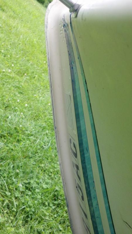

May 26, 2012
1
Oday DS II Burlington, VT
To remove or not to remove?
I'm a new owner of a 1984 DS II :) Thanks for the great advice here. I've got a similar issue with the deck/to/hull joint - not as pronounced of a gap as yours, oliversdad, but more of the joint is compromised. sunbird: did you clear out any of the existing bond before adding more? I was wondering if I need to clean any of this out, or if pumping in an appropriate adhesive (5200?) would suffice?
