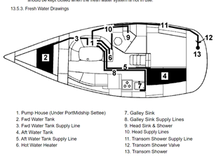

Just bought a 2018 Beneteau Oceanis 35.1 and can’t for the life of me get the deck shower at the stern working. I suspect there is an isolator valve somewhere but can’t spot it. Showers in the heads and shower room are working fine. Any ideas where I need to look ?

If you have a distribution manifold where there are on/off controls, I would look there.

Expect the isolator valve is behind the shower per your owner's manual. Might have to remove it to access the valve OR look for a water line and valve in the aft part of the boat.
