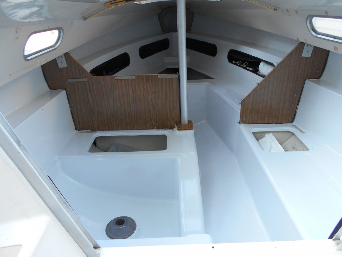

Being newer to sailing, (and not being overly familiar with the construction of sailboats) I guess I was just curious. I do believe the chain plates are still fastened the way Chrysler built this boat 40 years ago. I am just wondering after 40 years would it behoove me to beef these up a little bit?
You can see in this picture that the shroud attachment points have a pretty significant aluminum angle piece anchoring them to the wood bulkhead inside the cabin. So I guess they are probably not going anywhere. But the life line stanchions on my boat.....I just dont know that I would trust them if I slipped and thats all I had to grab on to. They have small (appx 3" x 3") pieces of flat aluminum on the underside of the deck. But the stanchion base and the flat aluminum pieces I described, seem to be clamping just the deck. And if you push on the stanchion itself there is a slight bit of flexing. I will have to investigate further to know if its actually the decking flexing. Or if its just a loose\damaged base.

As long as that wood bulkhead has not rotted from water ingress, you are fine. Once/if it rots however, it's time to replace it. You need to check for solid wood under the thru-screws now, and re-check for water on a regular basis after that.

Since you are turning this into a project, step the mast, have the standing rigging inspected and replaced, pull the chainplates off the bulkheads and inspect for corrosion and cracks. This also gives you a chance to inspect the deck penetration around the shrouds and repair any problems with the deck. Expect you may find that the wood core is wet and in need of replacement. Sound the rest of the deck to look for addition soft spots. A search of “re-coring boat deck” will find lots of guidance.
