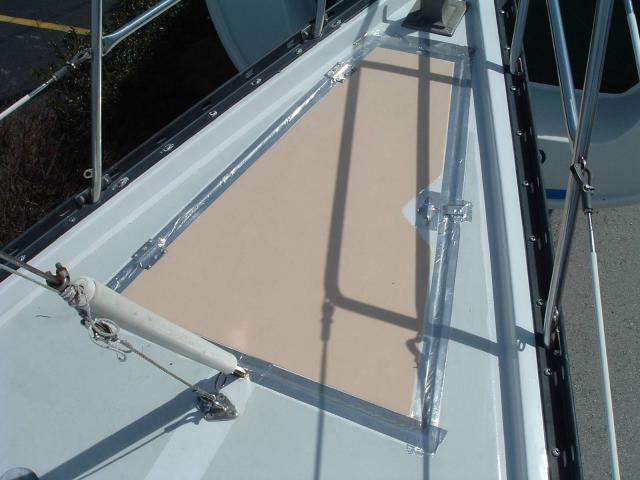

Years ago I used Interlux Toplac for the "white" part of the decks which has held up beautifully. Then two years ago I did the non-skid with Interlux "Interdeck". Both of these paints are one-part polyurethane but seem extremely durable. I first did the anchor locker and let it set through a winter to see if I liked the color and durability. Then in the spring I finished the remainder(the tape in the picture was to seal the locker for the winter, not part of the painting project).
