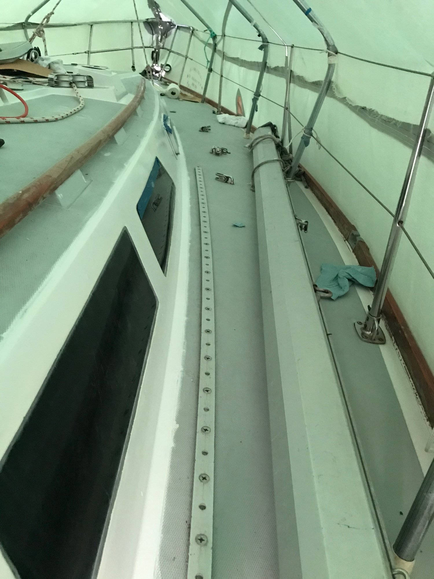

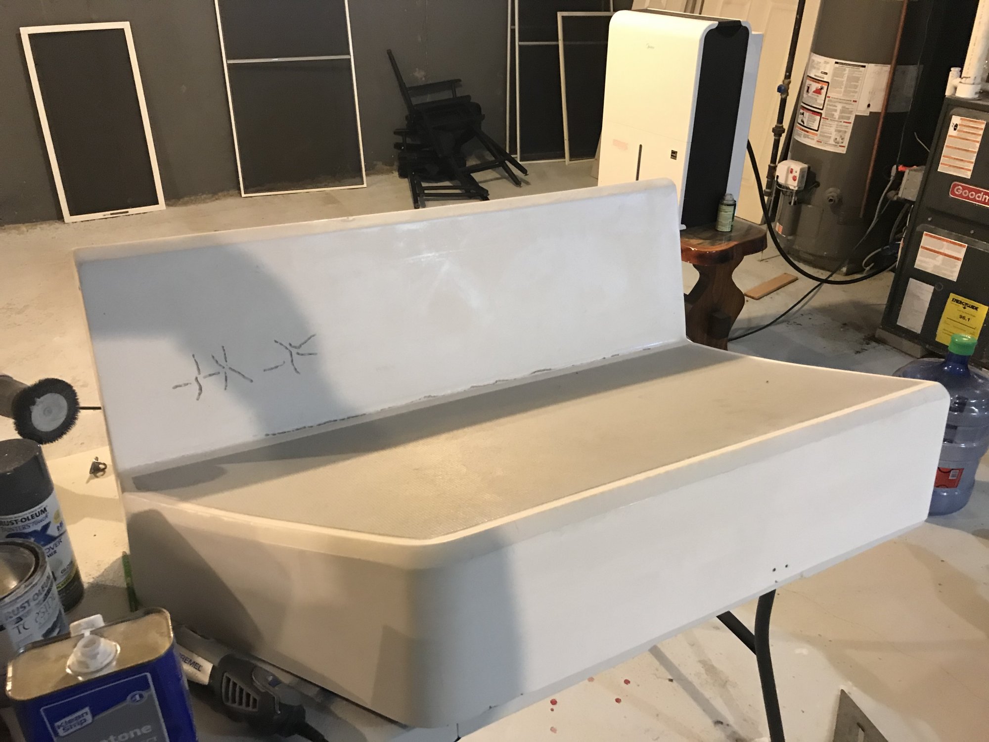

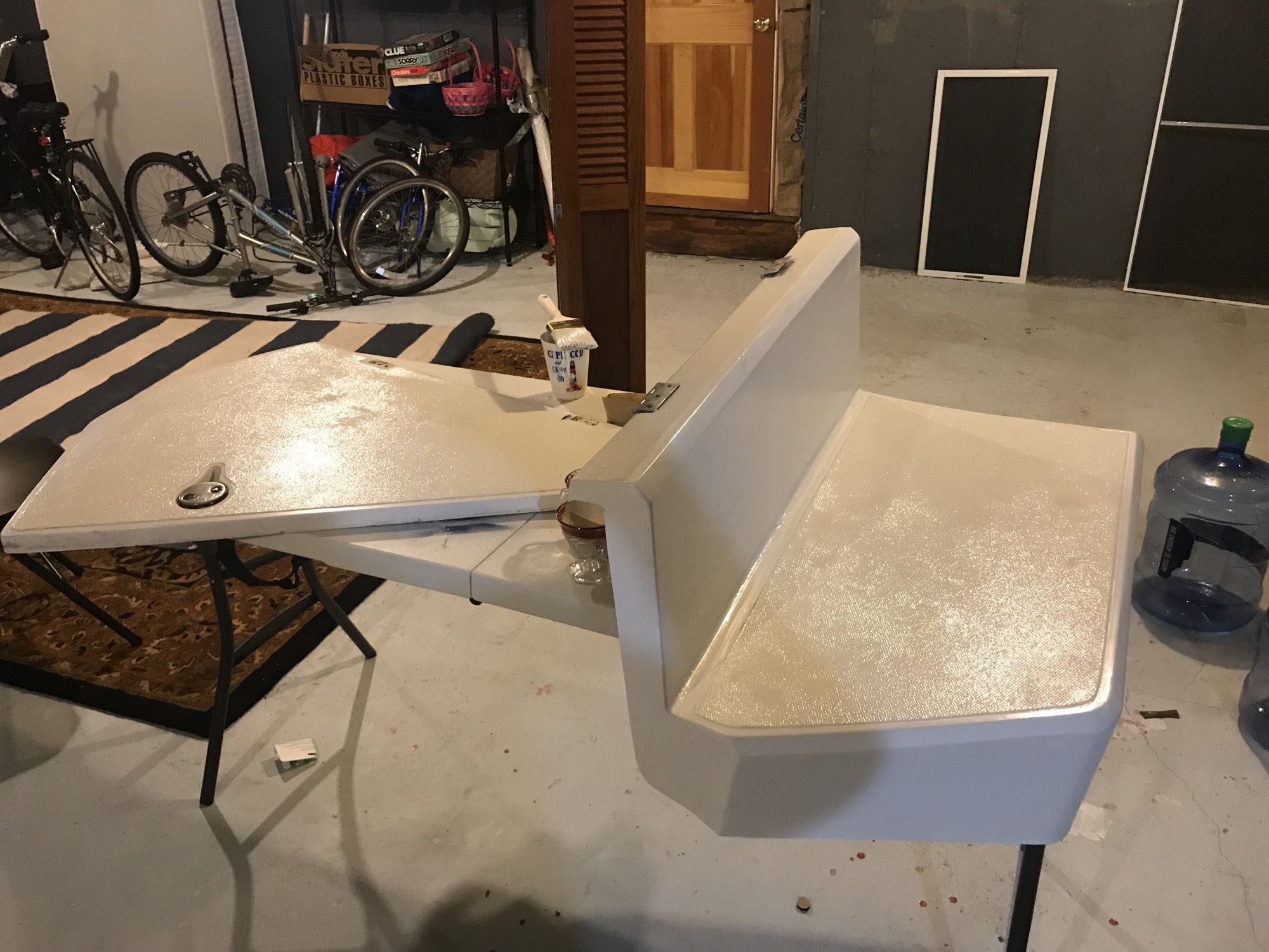

Yes, remove tape at end of day. I'm about half way finished with my deck. Rustoleum marine primer then Rustoleum Marine Topsides. Total boat nonskid on nonskid areas. I'll post some photos. Followed Boatworks today how to... it's a one part paint, good for a DIY. Roll & tip means if I make mistakes...repairs should look similar, very simple but time consuming job. Used Total boat fairing compound, 2 parts equal mixed, turns blue/yellow to green for go...like a bondo for boats, had to drill out a few cracks, screw holes, and some gelcoat repair. Hardest part was removing hardware, some I gave up and taped around job. Good luck.

My deck was used and abused by previous owners. Plenty of crazing, cracks, ect.
I used Pettit EZ primer 2 qts, 2 qts of total boat deck paint, 2 qts Pettit non skid(this non skid is too abrasive look for something a little more civilized, tnis thing will take your skin off. Theres no way too fix it since its already mixed)
80 grit for the smooth deck areas, then 220 then primer, 220,primer 220, first coat, wait 2 days, second coat. Tape off.
Wait a couple days, tape the painted areas do the nin skid. I did prep the non skid with bronze wool(metal wool will leave behind residue that will rust and ruin your paint) basically that was it. (it took 3 months average 6 hrs a day, depending on weather, ect to accomplish this task. Be advised.

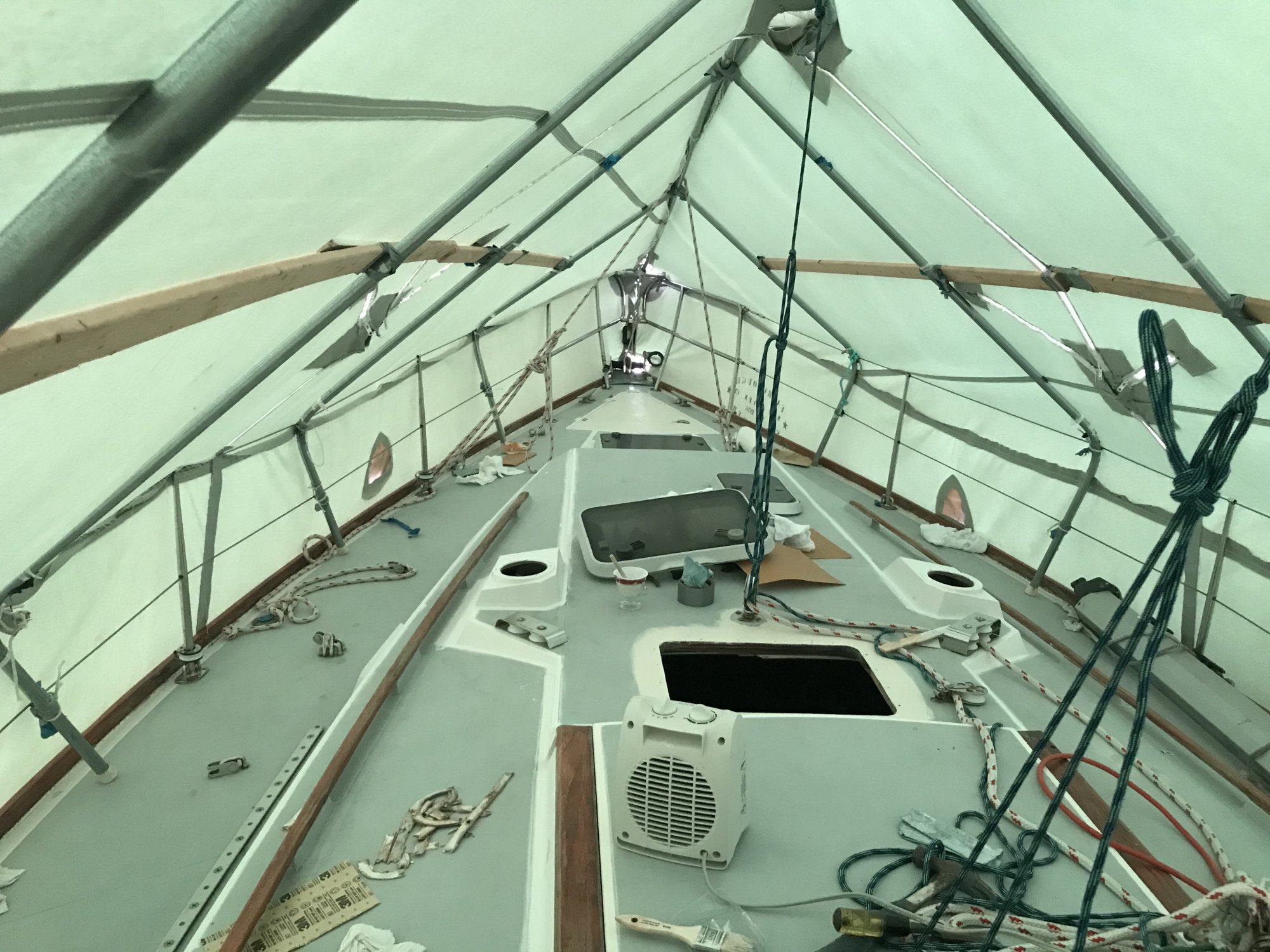

Painting deck myself. Motivation is marina quoted over $24000 to do the work. Probably more than the boat is worth. I didn't tape off white parts because nonskid will go over my mistakes. Recipe = Rustoleum-Primer-Topsides Total Boat Nonskid. Maybe I made a mistake, maybe I'm Michelangelo or Picasso, we'll see in a few weeks (months?) So far it's just time, cost is well under $500 and my time...well messing about in boats is as good as any other activity.
