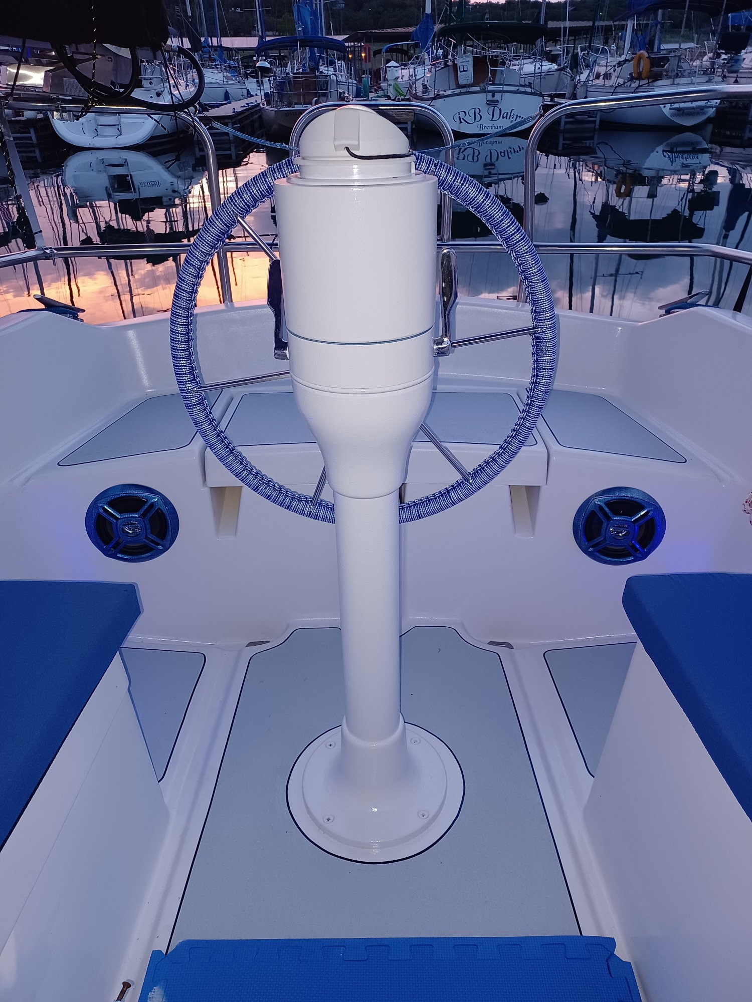

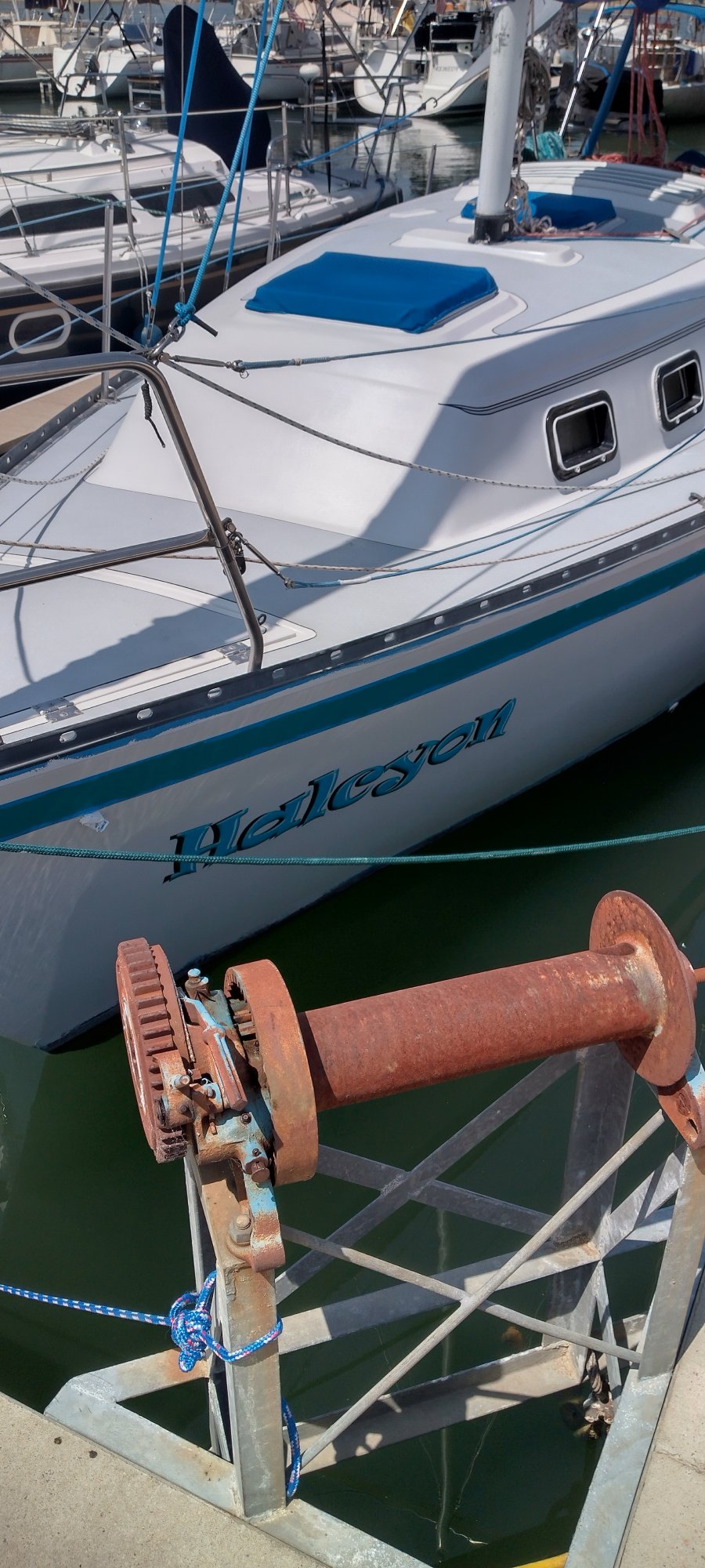

Feb 16, 2023
127
Hunter 27 cherubini 832 Lake Travis

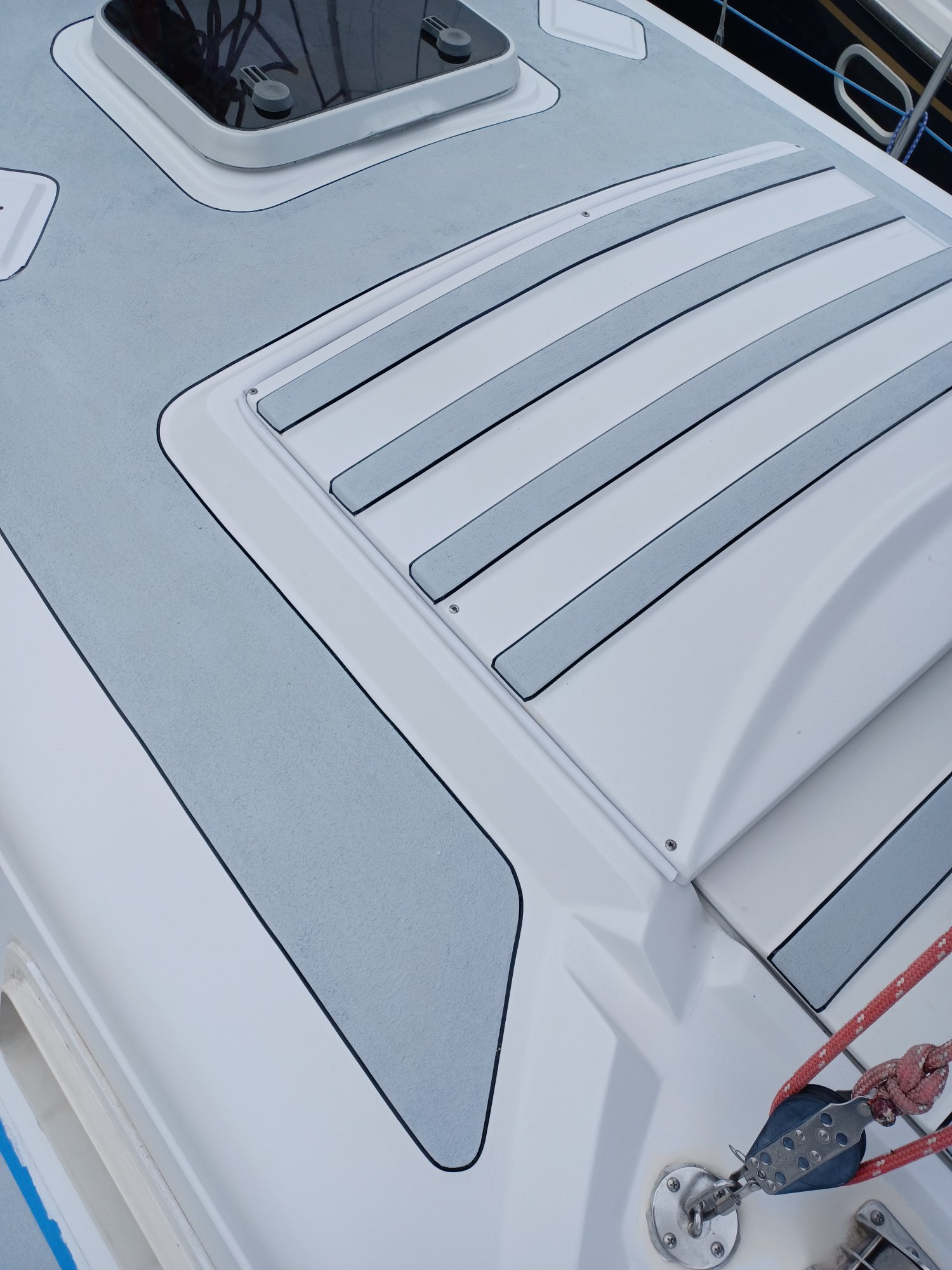

Check out this video it may help you with your decision since it contemplates paint versus gel coat and gives a multitude of pros and cons. Incidentally I painted my boat with polyurethane. I am including some pictures. Some before and afters.

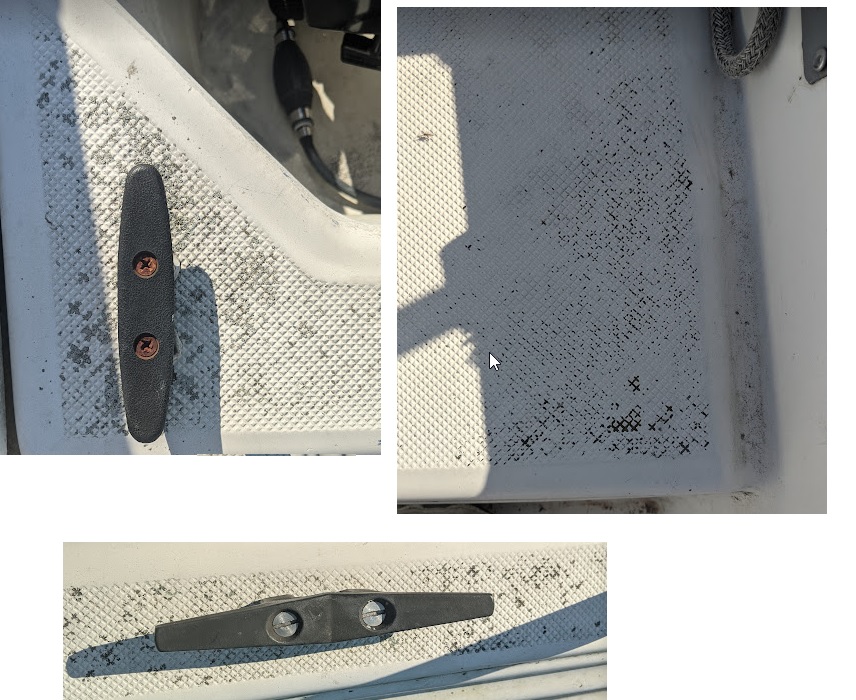

This picture shows some examples of the surface. I know the dark areas look like dirt, but it is degradation of whatever the coating was. Most of the deck looks fine, but these areas have gotten worse this year
Apr 5, 2009
3,288
As long as you have not worn through the gelcoat, you can buff it. I buffed my nonskid last year using Total Buff and a hook and loop carpet brush on my rotory buffer. I then waxed the surface with Woody's Wax which is a surfboard wax and it non-slip.
