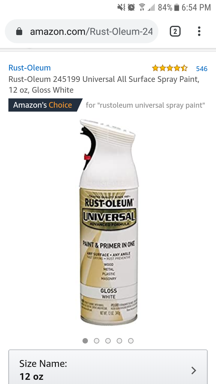

I made some repairs and mods and got rid of some luran so that i could put hydroturf or seadeck down. I painted afterwards with spray glossy white spray paint.
Rustoleum unversal glossy white.
Lay it on heavy, and close so it doesnt dry before sticking. Do 3-4 coats in about 15-30 minutes between them.
Week later you can compound to get rid of paint overspray dust.

At first, while looking for something quick and readily available, I laid down a good amount of Rustoleum Painter's Touch 2X paint and primer over the existing finish, which is a combination of Luran, fiberglass, and some other paint. It has adhered well, but because of the flat finish is catching dirt and scuffs like crazy, so gloss is making sense at this point.
I have read reviews of several products that look promising, but are brush or roller applied. I like better the idea of spraying, even at the added expense of working from 12-oz spray cans.
