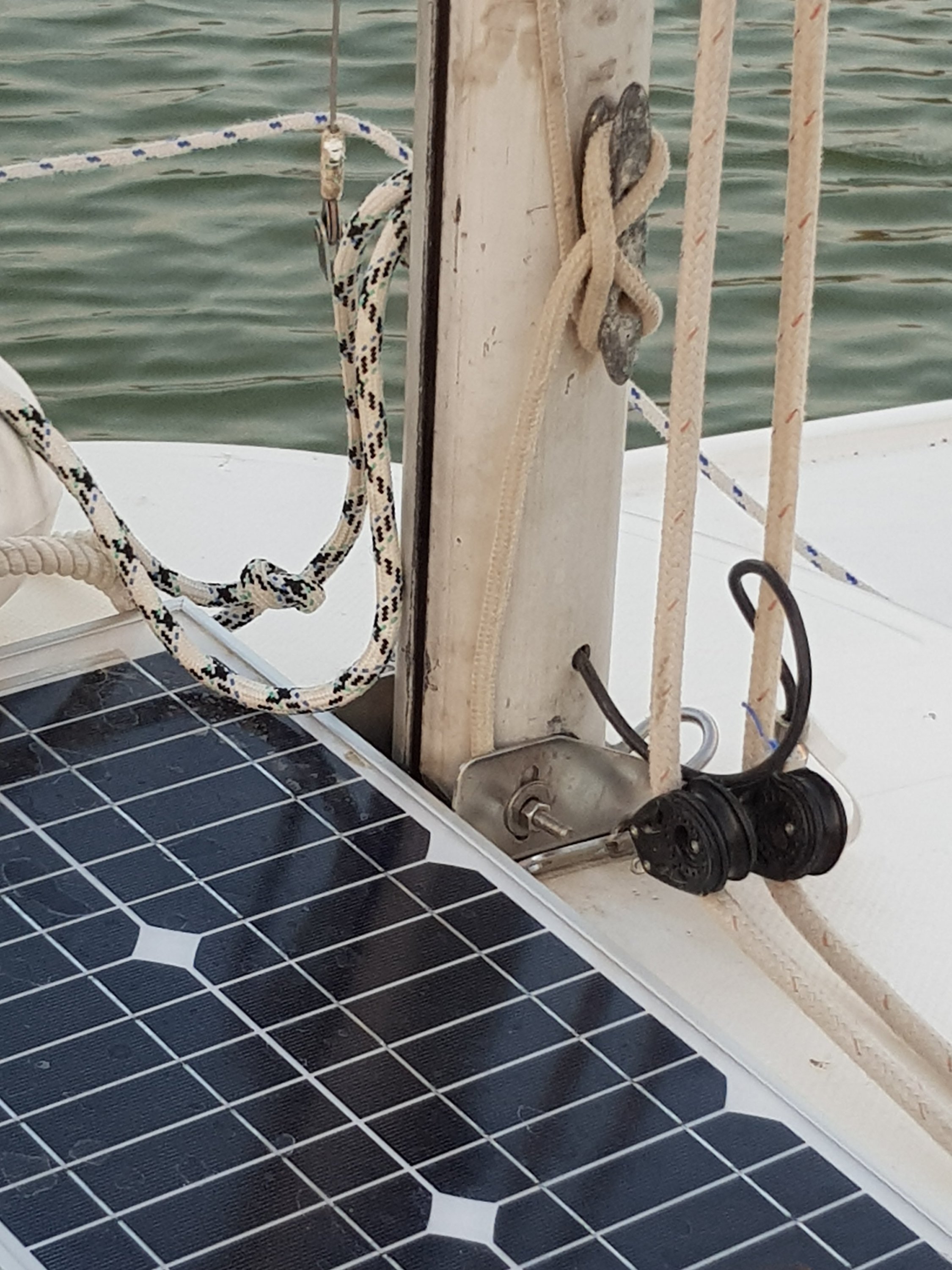

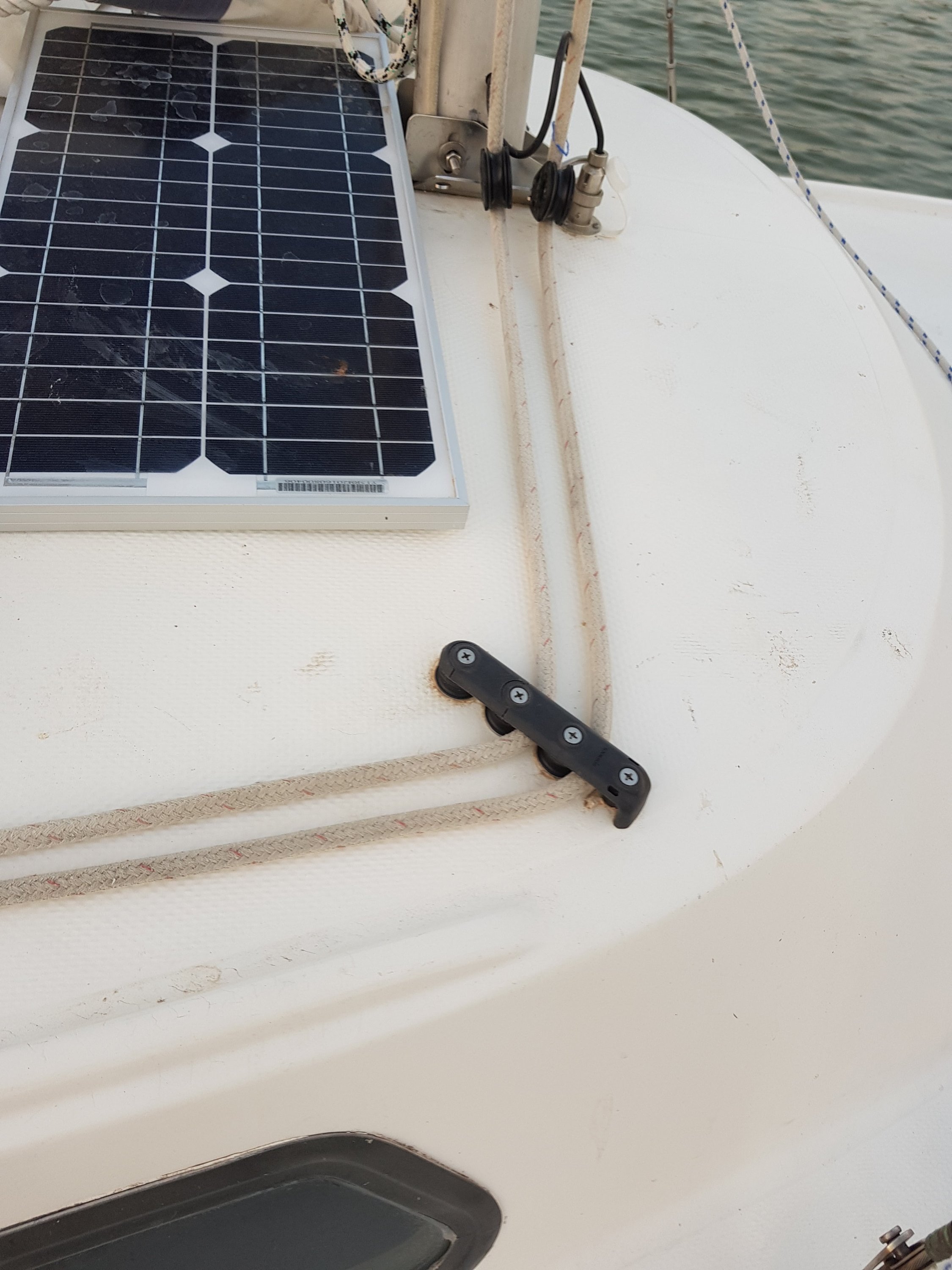

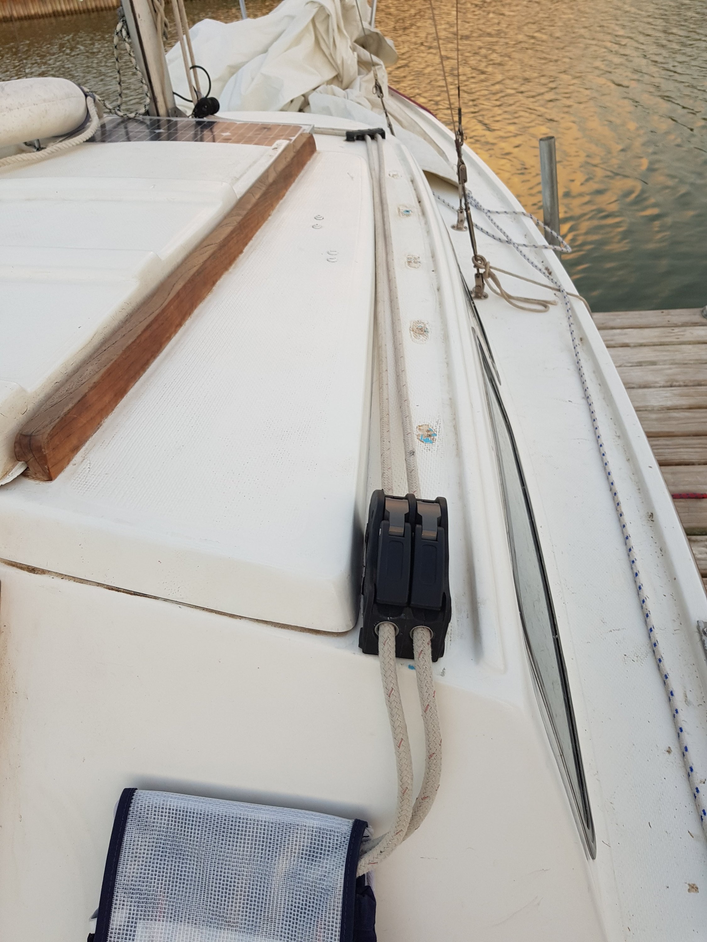

I started with one triple on starboard, CD base plate (6 holes for blocks), double clutch for Main and Genoa halyards this was my starting point, last weekend installed the boom vang and the line is over my head so no need to led the line anywhere, I'm testing a jib downhaul with a nice failure, but I think I 'll led the line by a block on the genoa track while I find the stanchions.
