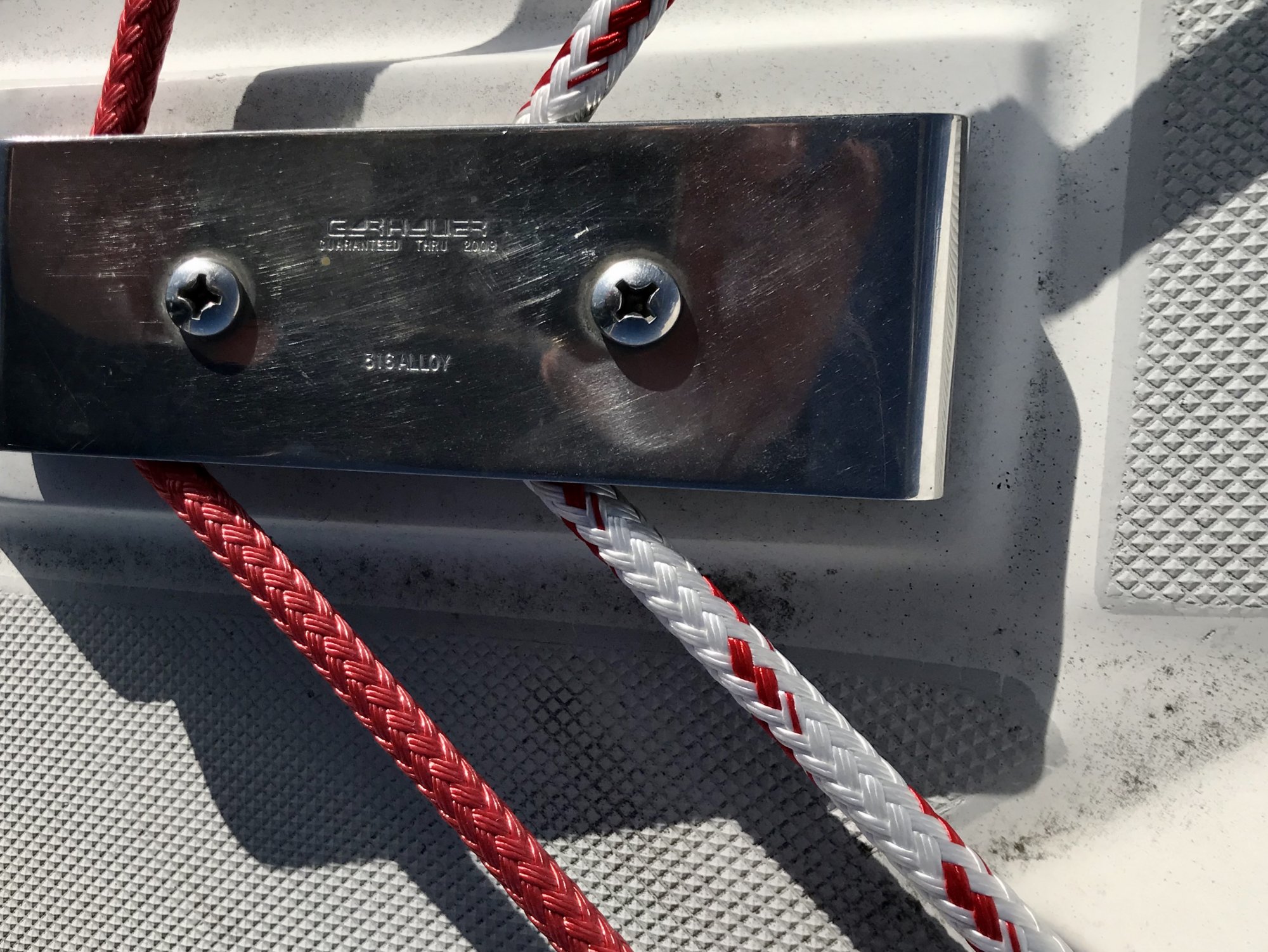

Looking to run lines for my Cunningham and out haul back to the cockpit. I have this current two block deck organizer on the port side, would like to make it a four block like on the starboard side. Ideally, I’d use the same manufacture but can’t see who this is. Anyone know the name?

Yes, Garhauer. I changed my twos into fours. I use their blocks and traveler as well.

Stacked. No new holes to drill. Reeve the lines with the most tension through the lower, inner blocks.
