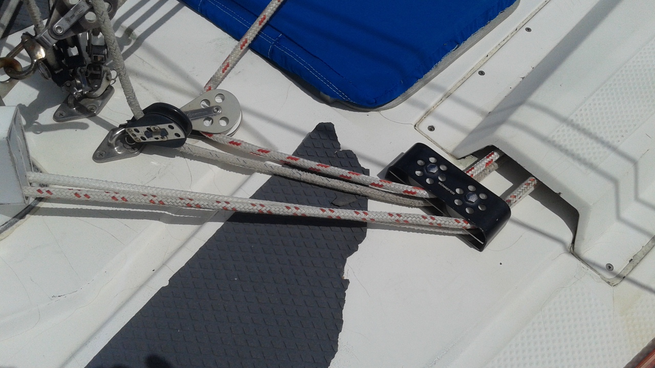

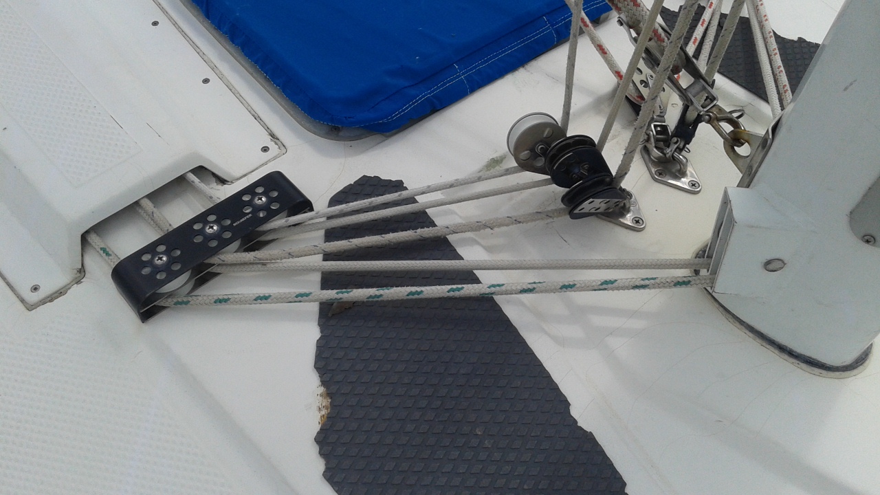

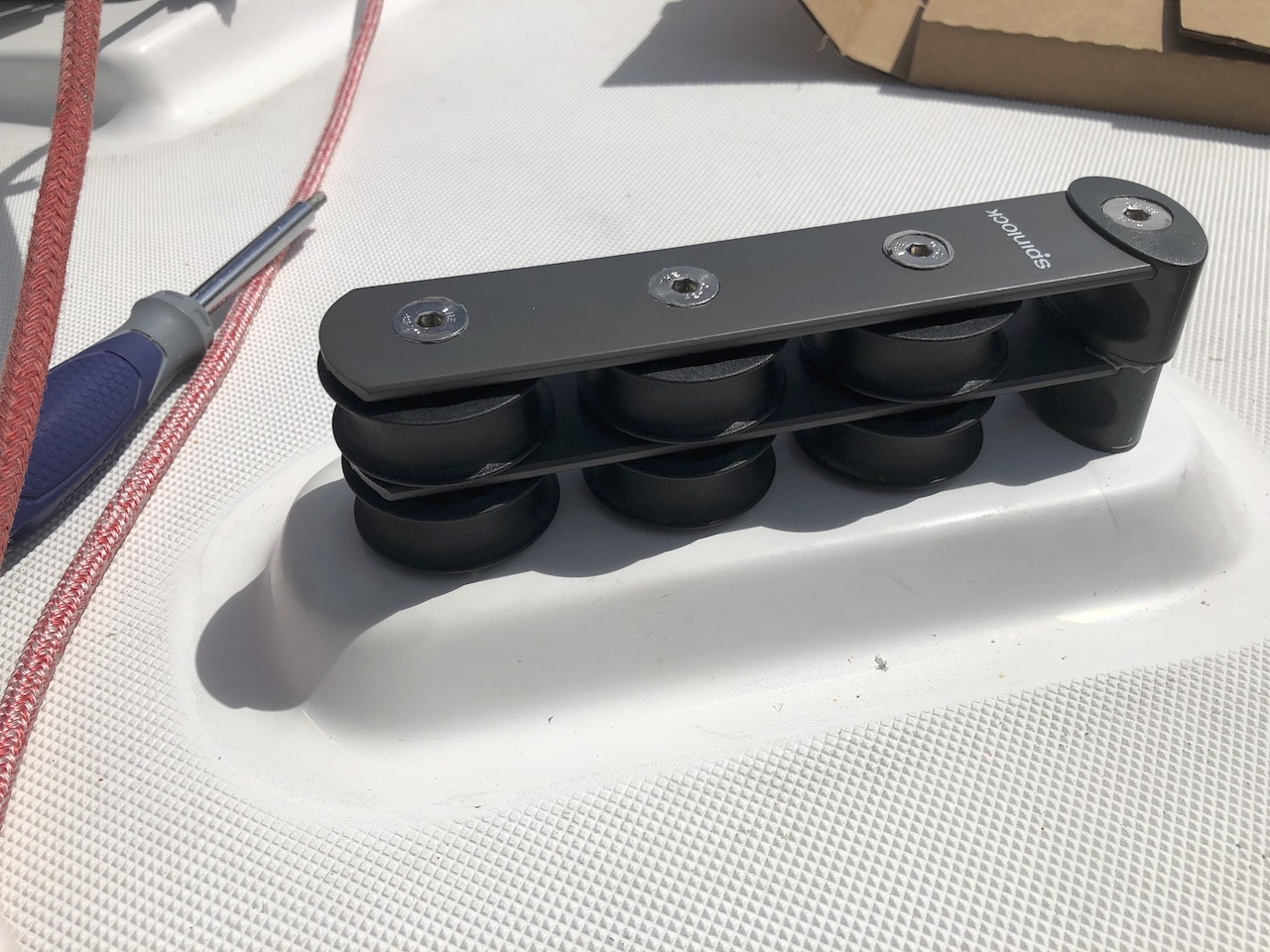

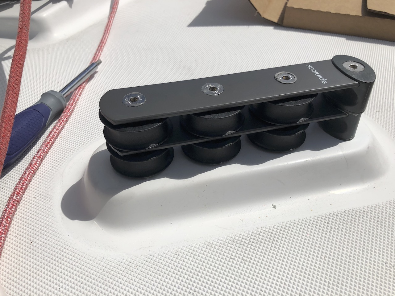

If that is the organizer that you have, or if the spacing works, those can be double stacked as well. There are several different sizes and configurations available.My 3 sheave deck organizers serve all the running rigging I need to run to the cockpit. My topping lift ties off onto a cleat on the mast and have not had a need to bring it the cockpit. You can install a 4 sheave deck organizer like the one below if there is room.

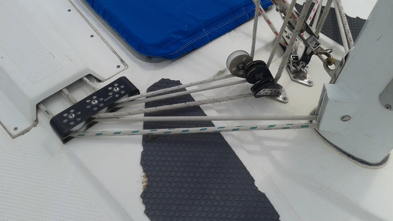

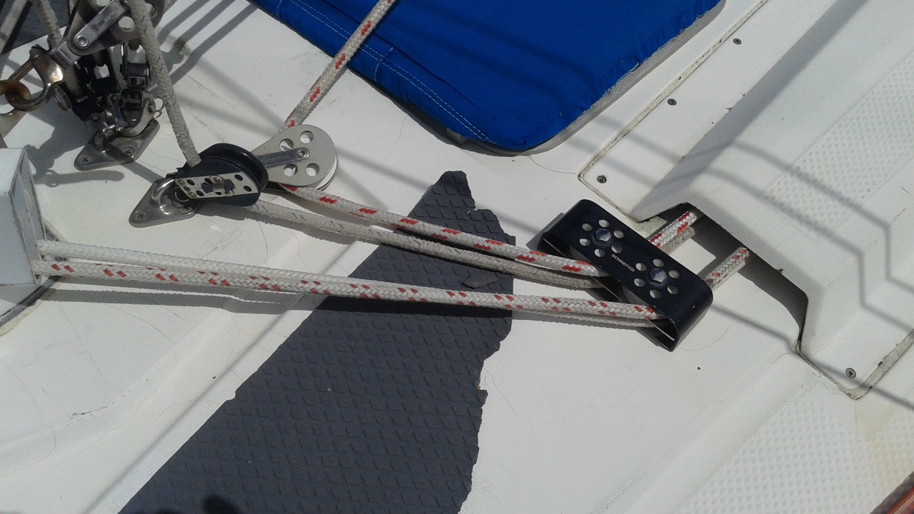

can folks share the arrangement and organizing schemes for their lines and deck organizers? My 1984 Hunter 34 had a hard life before I got it and a lot of the running rigging had been cut away or lost. Thanks in advance.On my 34 I have installed 2 Schaeffer deck organizers: one with 6 sheaves on starboard side (5 are used) and one with 4 sheaves on port side (all 4 used). If attachments point don't work for you, just plug them up and drill and tap new ones. There is an aluminum backplate for that under the fibreglass. Has worked well for me for years. Good luck

Thanks so much for your help exactly what I neededOn my 34 I have installed 2 Schaeffer deck organizers: one with 6 sheaves on starboard side (5 are used) and one with 4 sheaves on port side (all 4 used). If attachments point don't work for you, just plug them up and drill and tap new ones. There is an aluminum backplate for that under the fibreglass. Has worked well for me for years. Good luck

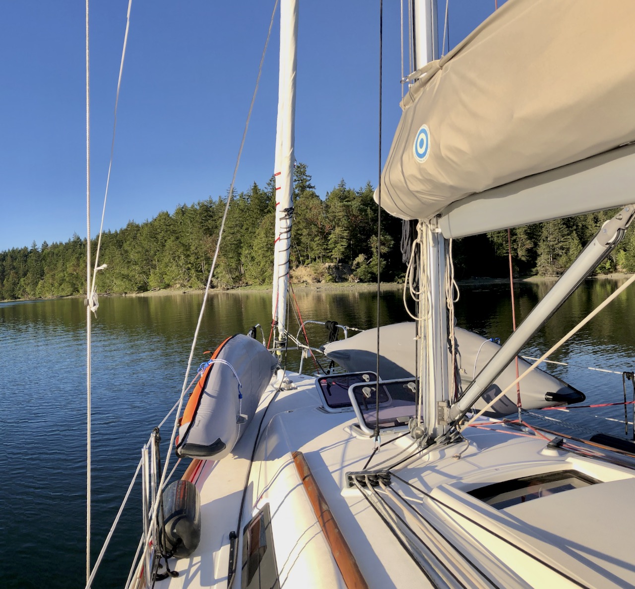

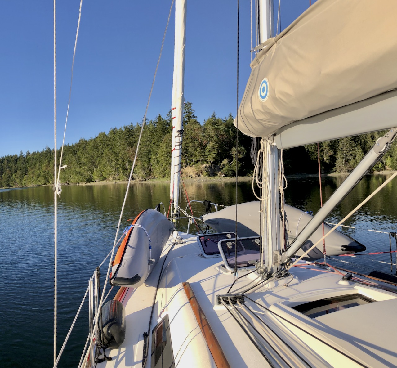

Thanks for your helpMy 3 sheave deck organizers serve all the running rigging I need to run to the cockpit. My topping lift ties off onto a cleat on the mast and have not had a need to bring it the cockpit. You can install a 4 sheave deck organizer like the one below if there is room.
