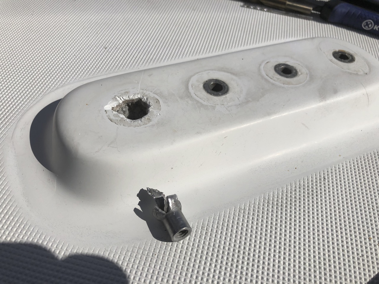

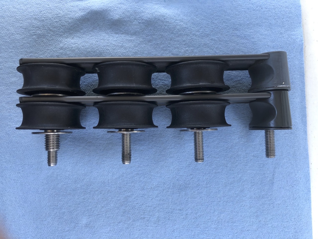

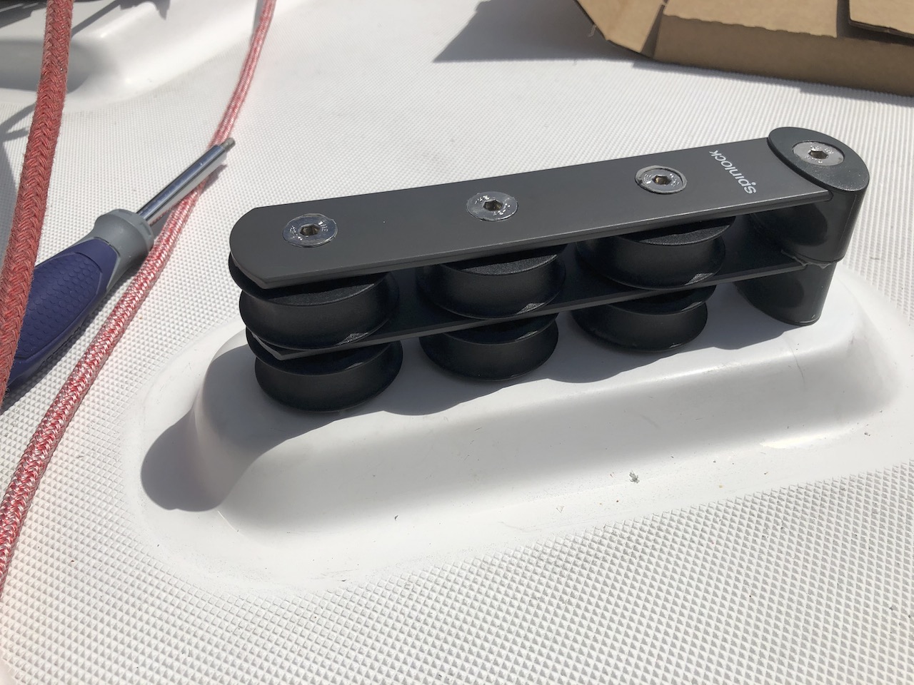

I originally posted this thread in Ask All Sailors, it covers my experience with a stripped threaded anchor embedded in the deck of my '14 Oceanis 34. I'm not sure how I would have been able to make the repair with a direct Beneteau replacement part... I ended up filling the cavity with epoxy and embedding a threaded insert for one of the four screws that hold the organizer in place.
