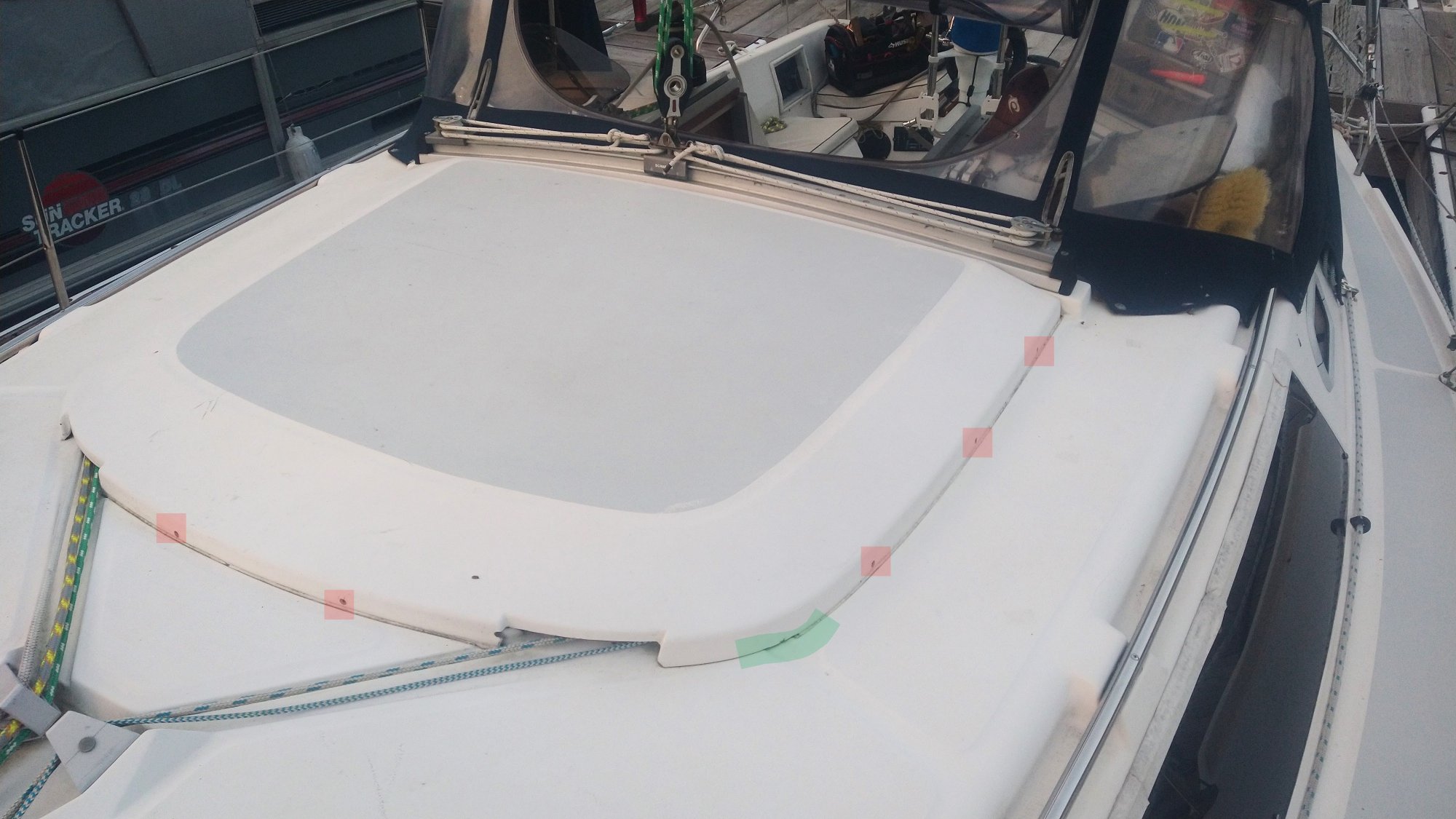

Hi. I need to repair/replace my deck organizers that are hidden under a dress panel on my deck. Can anyone share some insight about the removal of this panel? I've removed perimeter screws (red highlights) and cut the sealant bead that you can see pictured. When I apply prying persuasion at the forward line entry point and weep channel (green highlight) it feels like there's something still holding several inches inboard. I can see the panel flex slightly and the bead of 3M 4000 separates ever so slightly, but there's something I'm missing.
Do I need to remove the traveler and look for more fixture points aft? That wouldn't explain the forward end's resistance to upward pressure. I'm afraid of applying too much pressure and cracking the panel.

Hi Belzoni,
I have a 1994 Hunter 37.5, and my spray hood looks very similar to yours. It is held down by the screws and sealant. I did not need to remove the traveler to take it off.

@PAC3142 Thanks for this info. I guess I just didn't aggressive enough with the sealant. Will go all around it with a scraper blade on my sonic tool.
I'm going to go after it again this summer. I'll plan to just replace the sheaves. But if I find that I need to replace the whole thing, I'll get in touch.
