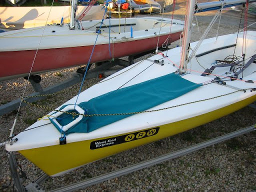

I'm interested in learning more about this system from those who may have experience or observations. I currently have a more traditional sock to launch the asymmetrical on my Merit 22 but always looking to try new ideas, and this intrigues me. especially as I commonly sail singlehanded. This isn't a very good example but there's a limited amount of info to be found online. thoughts??

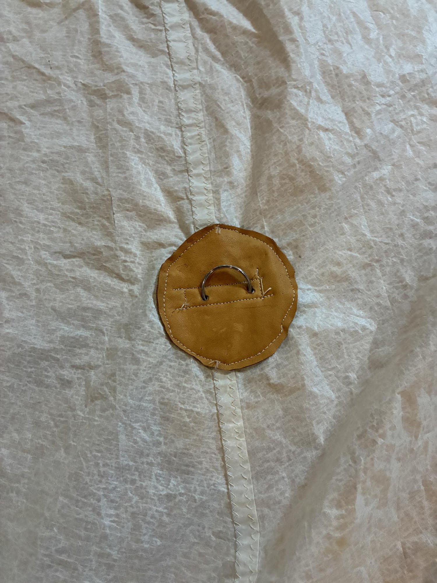

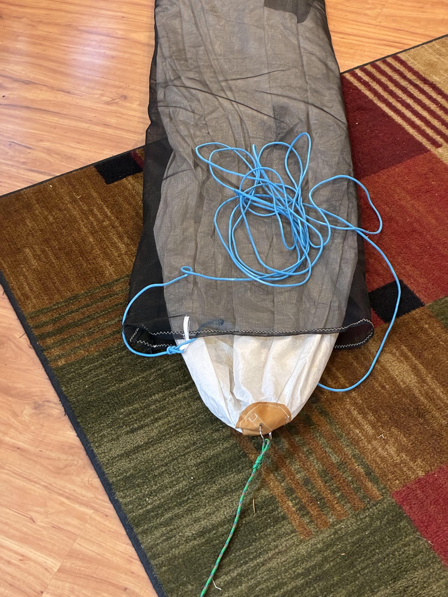

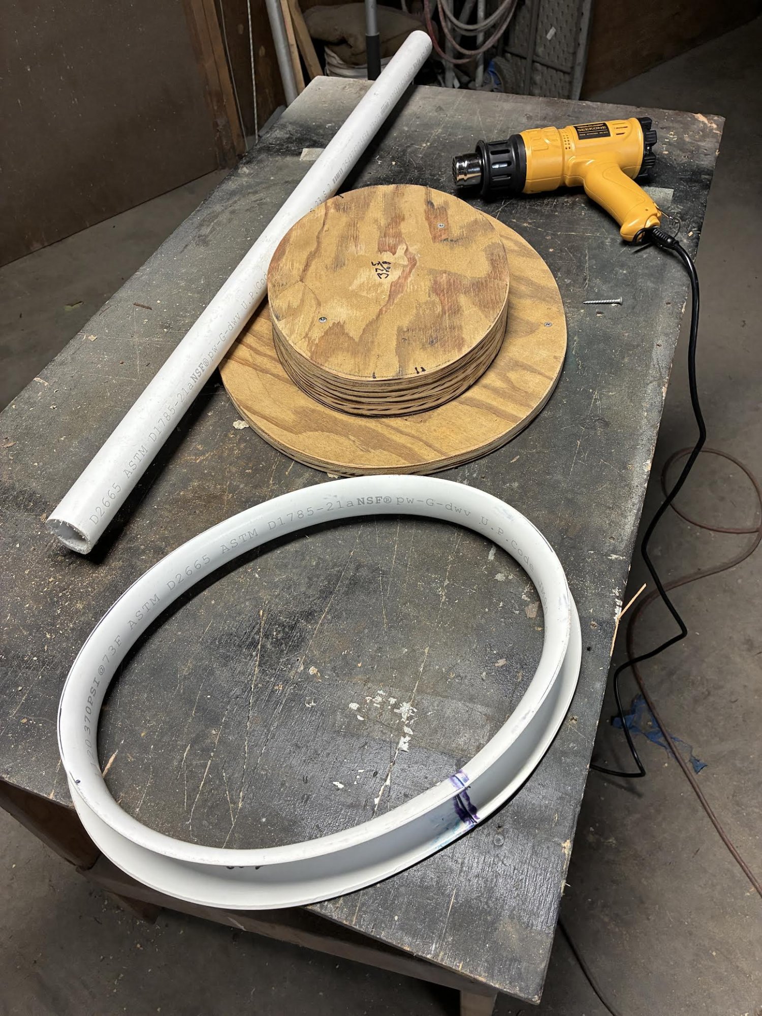

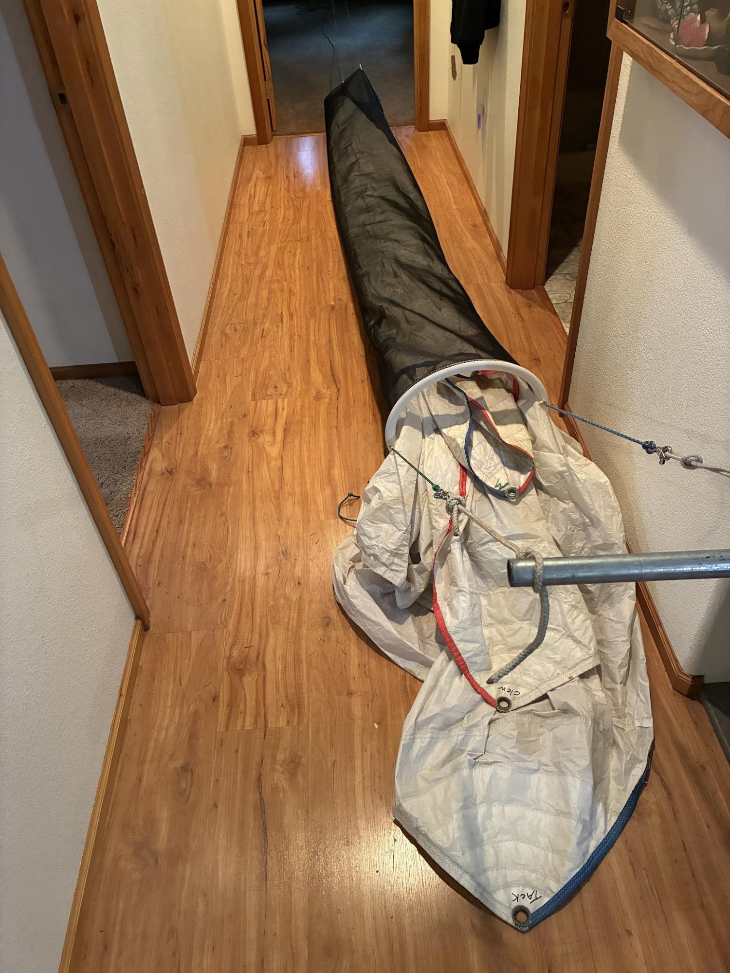

I had a few tired old spinnakers laying around so I dug one out to play with for this project. if it works out as well as hoped then perhaps I'll set up my good A spin for this, but until then I can play with this one at little cost if things go sideways. I built a new, and slightly larger form (38" circumfrence), to mold the pvc chute around. as you can see I took @jssailem suggestion and purchased a heat gun, which works really well for this. I set it on ~900* and have had no burning issues at all wile also getting the job done much quicker than the torch method previously used. I'm also using a heavier vinyl covered polyester for the 12' long tube. much too heavy for a std vertical spinnaker chute setup but this "cat proof" window screen seems about right for this deck mounted version. the belly button is split leather and two pieces sandwich the sail to support the heavy 1 1/2" split ring for the retrieve line.
Just need a few warmer days to pull the boat out and get the mast up in the driveway to finalize a few things and test it out now.
