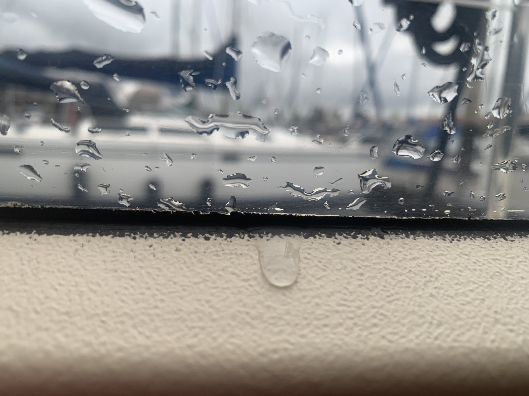

We purchased a 2018 M-H 31 from Speciality Yachts in Vancouver ~ 6 months ago (November 2023). I knew about the fixed port leaking problems in these boats, so I checked for this carefully before purchase and found no sign of current or past leaks. And the broker professed ignorance of any such history in this boat, which they had maintained since new. But about a month ago I discovered small leaks on both sides. I had Quality Windows in Seattle remove what they called the “secondary seal” (the outer most seal) and then re-seal. The job looked great, but within 10 days I found one small leak on the port-side window nearest the head. Image attached. Where there’s one leak there will likely be more.
Not sure what to do at this point. I’m considering starting from scratch and buying new M-H 31windows from the Sailboat Owners Hunter store, which I probably should have done initially. Has anyone had experience with these new windows? Or any other advice.
