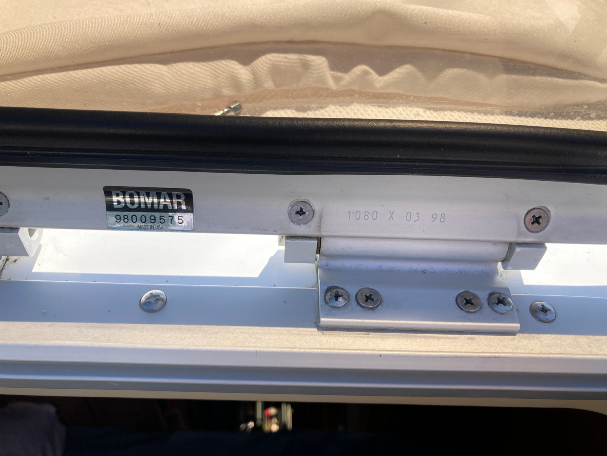

If not Lewmar, check Bomar. You'll find the ID on the underside :
I have both Lewmar and Bomar on my boat and they are almost identical.

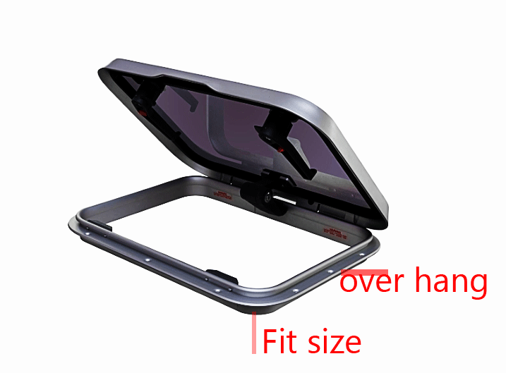

I would chose 30. But what do I know. My logic suggests that maybe your measuring the over hang that protects the seals from waves.
I Photoshopped.
