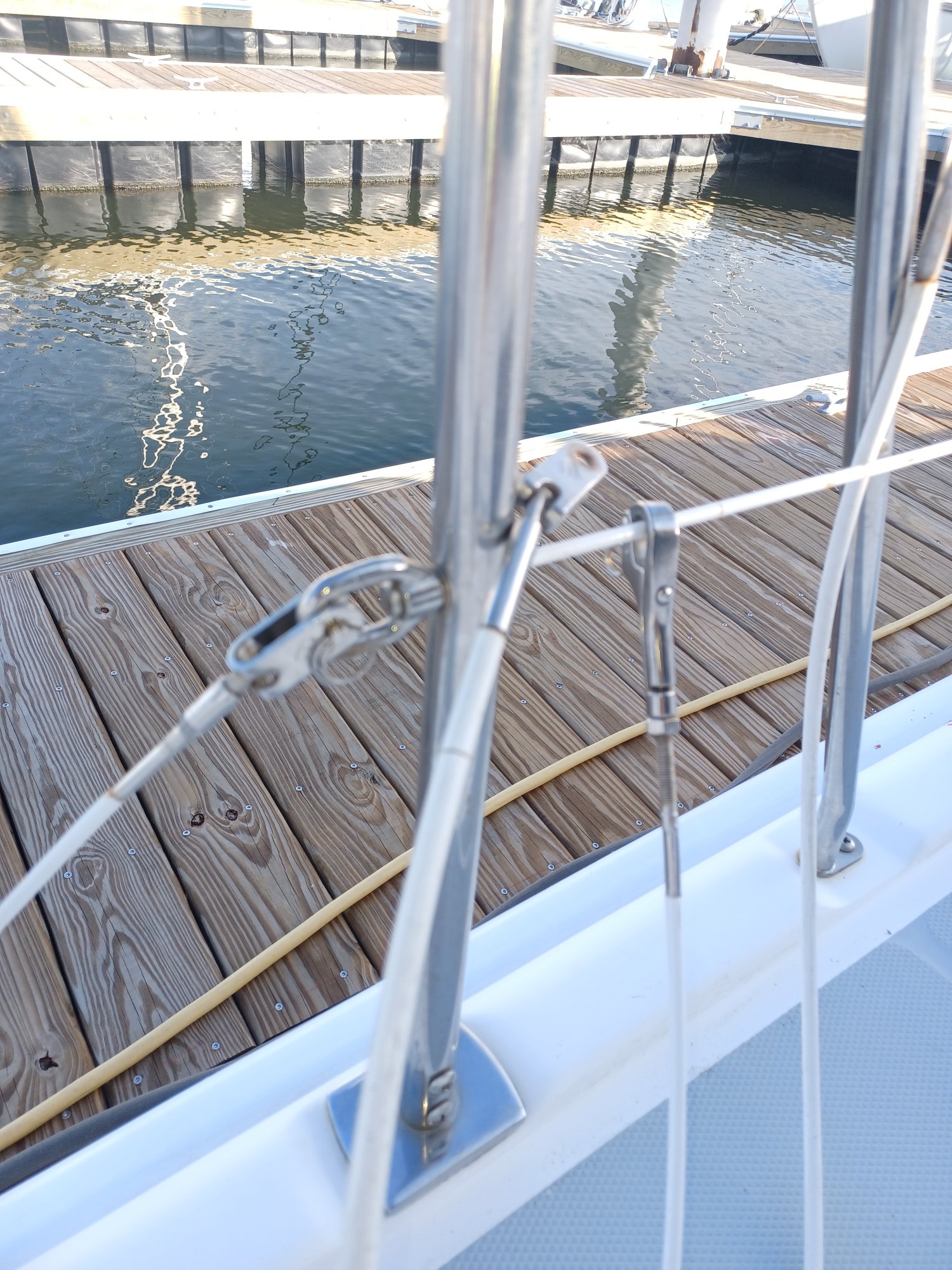

deck hardware: what is this called?

I lost the pin to this guide wire anchor. You can see what it looks like on same item lower left. Anyone know what it is called, where to get it?

Remove the pin from another guy wire and take to store and get one. You may be able to take the cable with you with the fitting on it.

Buy a variety pack . On our boat they are used everywhere. Differant diameters and differant lengths. Please do not go cheap . Buy marine grade stainless steel . Many look the part and will rust out quickly. thereby making removal an extremely frustrating experiance

Simply measure the hole which will determine the size of the clevis pin needed. Looks like a quarter inch size
