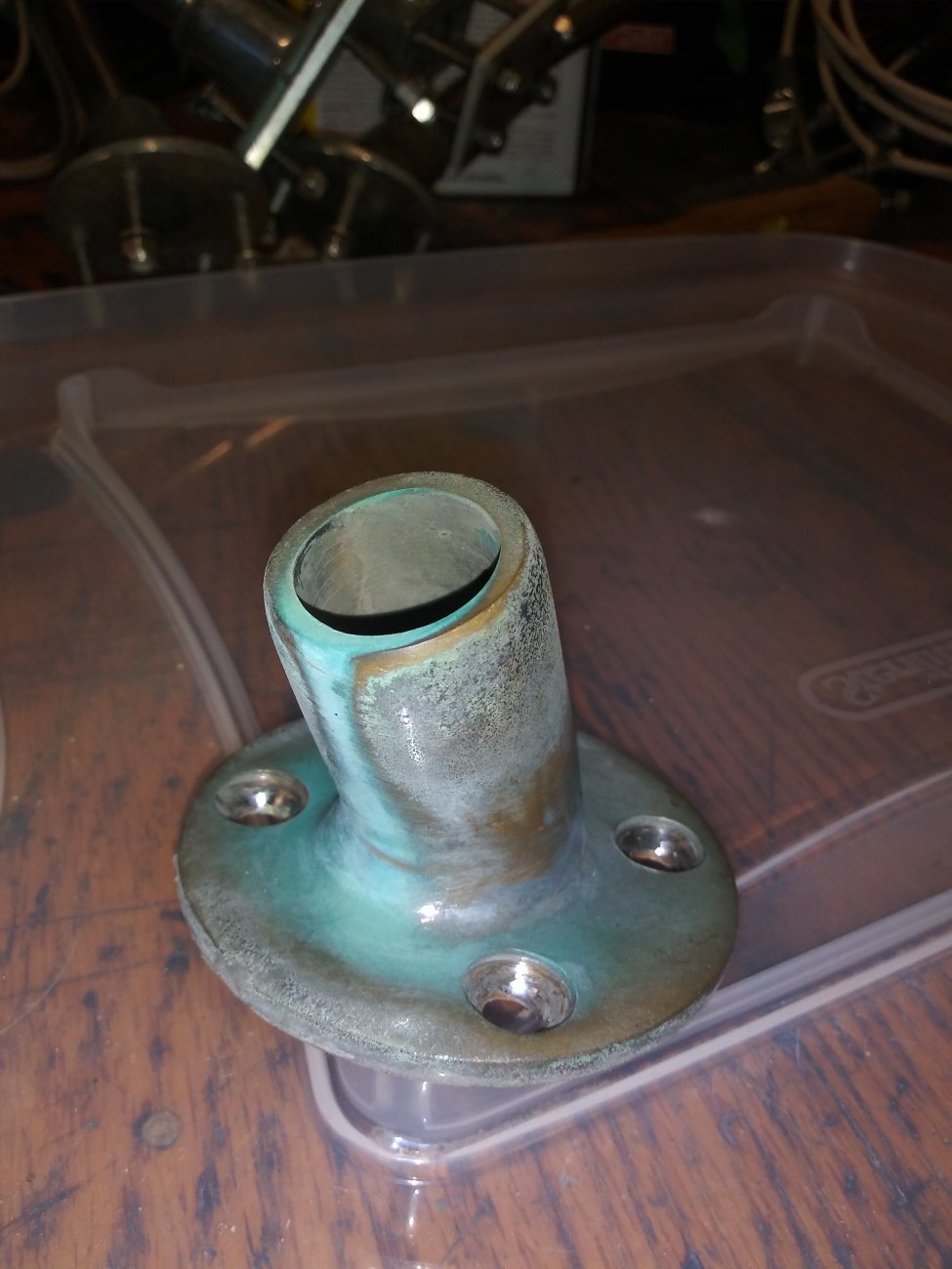

Whats the best method to make this stuff look decent again? Not sure what they are even made of. They have a very thin coating on them, but I am not sure what the coating is either.

Looks like chrome or nickel plated bronze. The plating has worn off from weather and aggressive cleaning.
You may be able to get them replated.

Like @Charlie Jones s/v Tehani said, you can put a nice shine on that. Even a wire brush on a hand held drill will make it look better but a dremel with a polish wheel would be ideal. Once it is how you like it, a thin coat of spray polyeurethane will help keep it looking nice for a few years... then you will have to repeat. On the other hand, patina looks okay IMHO so let it go green all over.

Each to his on definition of "Decent" looking.
From that picture...
It appears that water filled the inside and overflowed for years. What will stop that in the future?
Note: Metals and their alloys "Oxidize". The key selection for a Marine environment is to reduce that oxidations to a design acceptable rate. Cleaning exposes new metal to oxidize faster.

About a decade ago I took the original chrome-over-bronze exhaust fitting in and had it buffed and re-chromed. Came out 'like new' i.e surface like a mirror.
Local shop that did a lot plating for car restoration and custom work did it. Price was reasonable. It was a kick to chat for a minute with other customers about their vintage cars and motorcycles!
As they say: Your boat, your choices.
And..... If its been many years/decades since these bases have been off the boat it is time to epoxy-fill-redrill and re-caulk all of the fastenings anyway.

I think it all depends whether you want all bronze fittings or chrome plated bronze fittings. A combination of the two does not look very shipshape, IMO. Of course, the biggest problem with bare bronze is that if you want it to look sharp, it requires constant polishing, whereas chrome just needs a quick wipe every now and then.
Neither has any bearing on the strength or longevity of the fitting, so you only have to choose which looks better to you. Expense wise, if your time has any value, it would probably cost about the same to remove and replate as it would to remove the chrome from the bronze.
