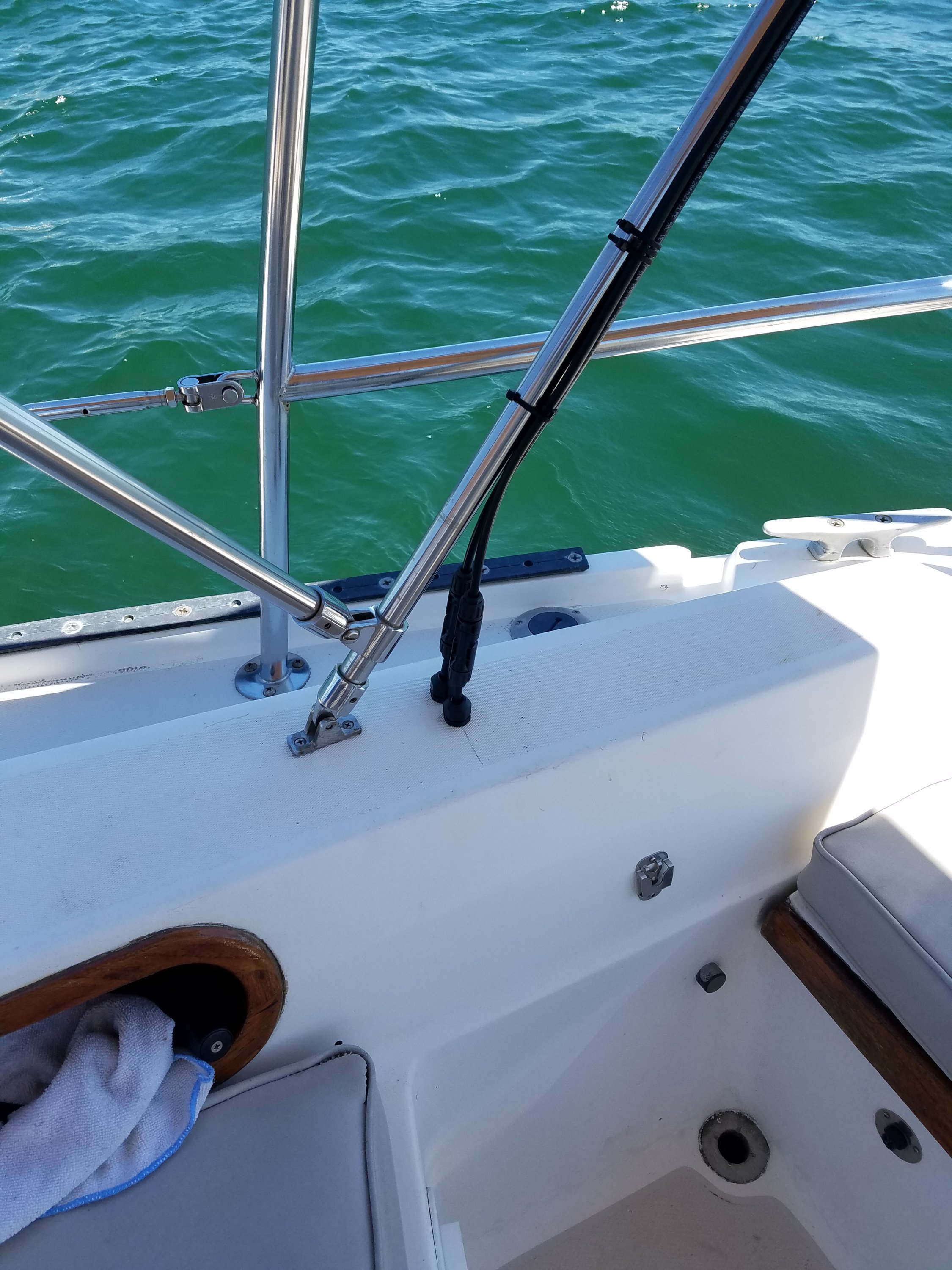

I used MC4's for my solar connections, worked easily and beautifully!
