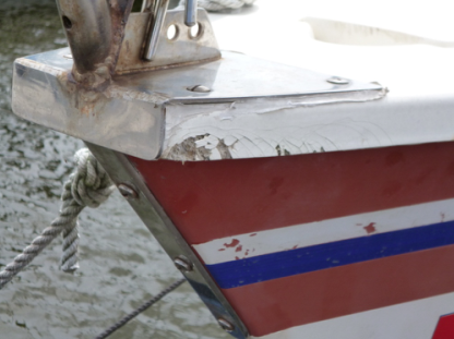

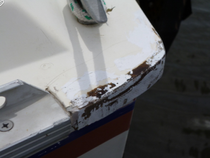

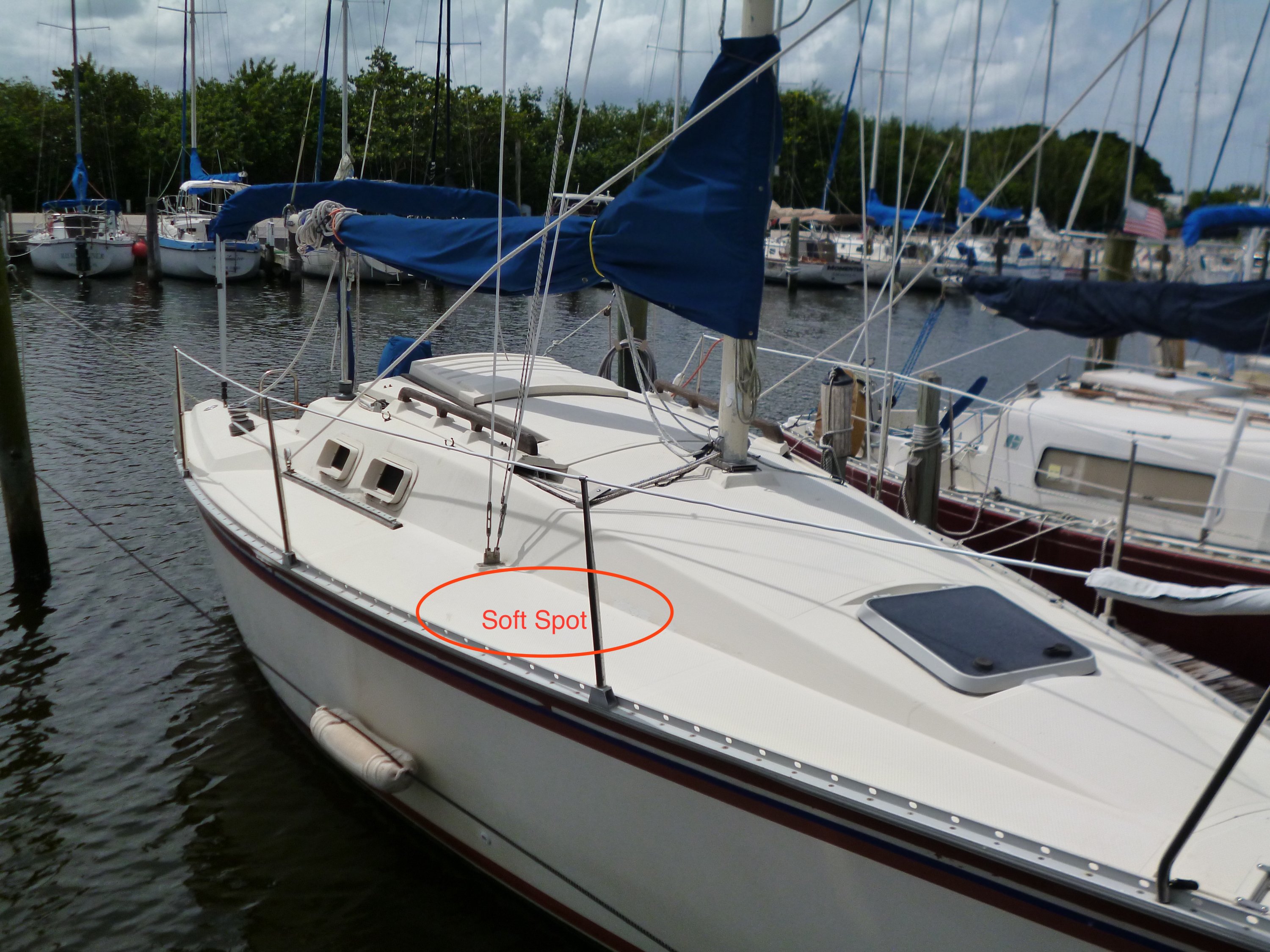

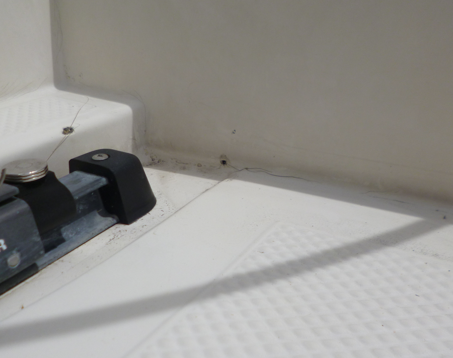

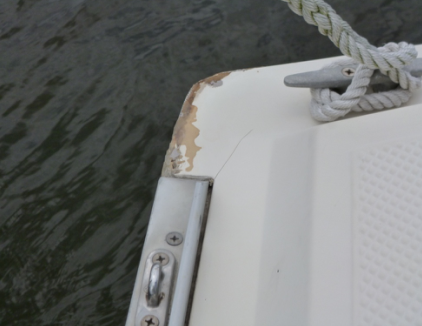

Thank you for the advice! Here are some pics of the areas that need repair. Nothing major but a lot of minor spots. Bow, transom and cockpit benches. Some spiderweb cracks, too. There is also a soft spot starboard mid-deck.
