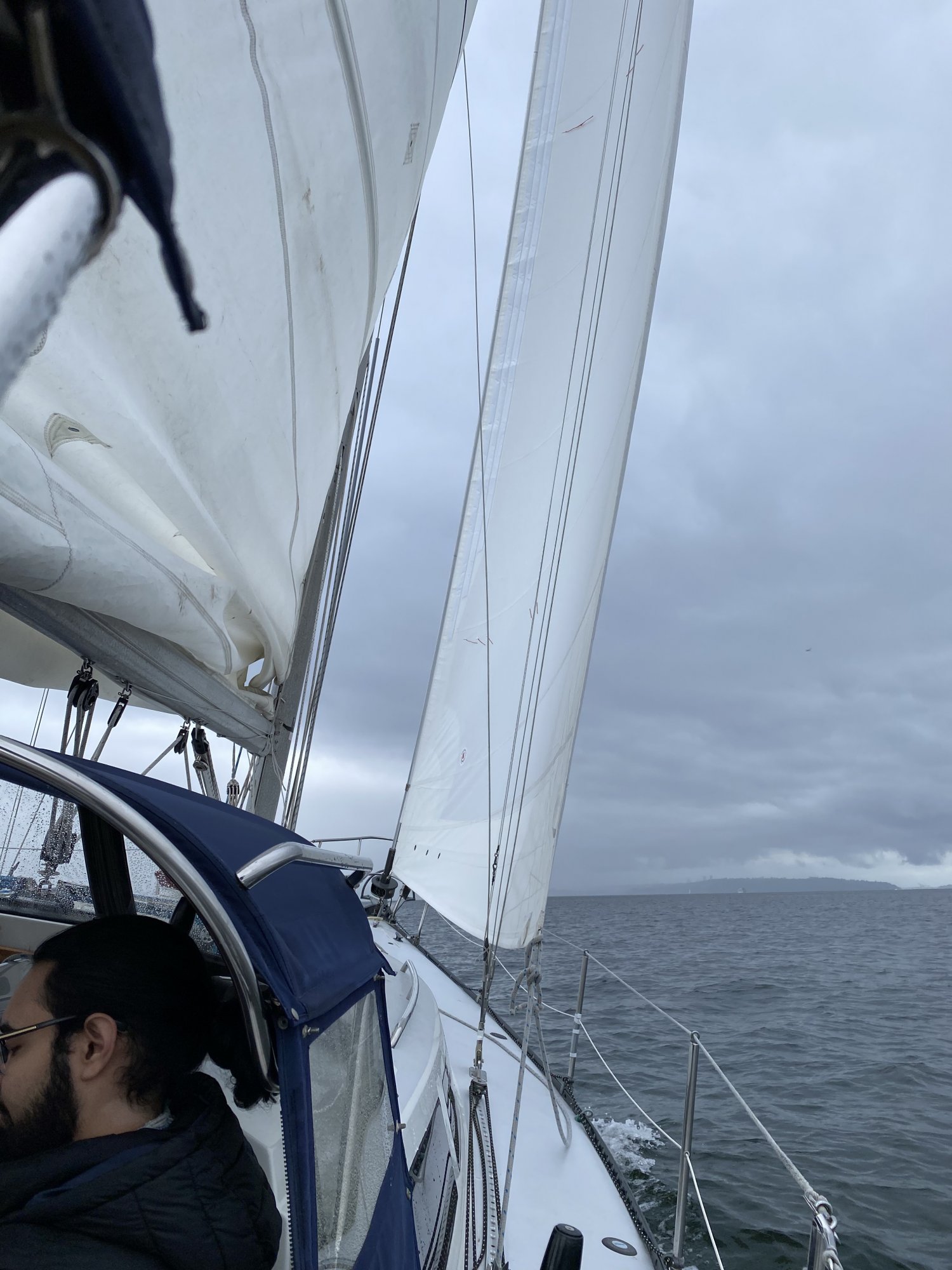

I have a similar experience currently with my new 125 genoa, also with three rows of telltales, on my masthead C&C 37. Going to weather yesterday, I was able to achieve a steady 40deg angle but couldn't seem to get the twist out of the upper end. Leech about 15" from spreader while the foot was at the shroud, lower yarns parallel, mid/uppers not so much; helm balanced. Cars are not all the way aft as the control lines aren't that long: will a broader sheeting angle flatten the curve at the top of the genoa? Hoping this contributes to the OP's discussion, too.

If you’re near the end of the control line it sounds like the cars are pretty far back? If so you could try bringing them forward a bit. That should close the leech in a little and take some of the twist out. When you say the middle and upper yarns weren’t parallel do you mean they were showing luff or stall? Luffing would indicate too much twist, but stalling would indicate the opposite.

You concern about the "twist" of the upper 1/3 of the Genoa is controlled by where you set the car.
  • forward position causes the sheet to pull down on the leach and allows the foot to be fuller
  • aft position stretches the foot flat and allows the leach to twist off as it is not drawn down.
  • You can provide additional adjustment by using a tweaker to pull down or pull in between the car and the sail clew.

Thanks, great responses. Just getting to know the new 125. And of course I should’ve known that cars forward would reduce twist. Wind was 15 avg and I had a reef in the main. Couldn’t seem to get the leach as close to the spreader as my 110. Will move cars fwd and report.

Back to the OP’s question, I found the advice here useful today on a rainy sail. Once I moved the cars forward, opened the leach, AND sailed to the upper/mid yarns (so happy not draft stripes), I found trim to be much easier.
