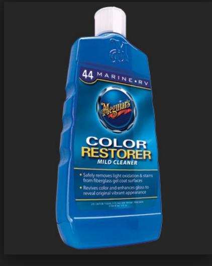

As far as gel coat stains on the hull, my first go to is :
It's an extremely fine cut polish and you could rub until hell freezes over without danger of cutting through the gel coat.

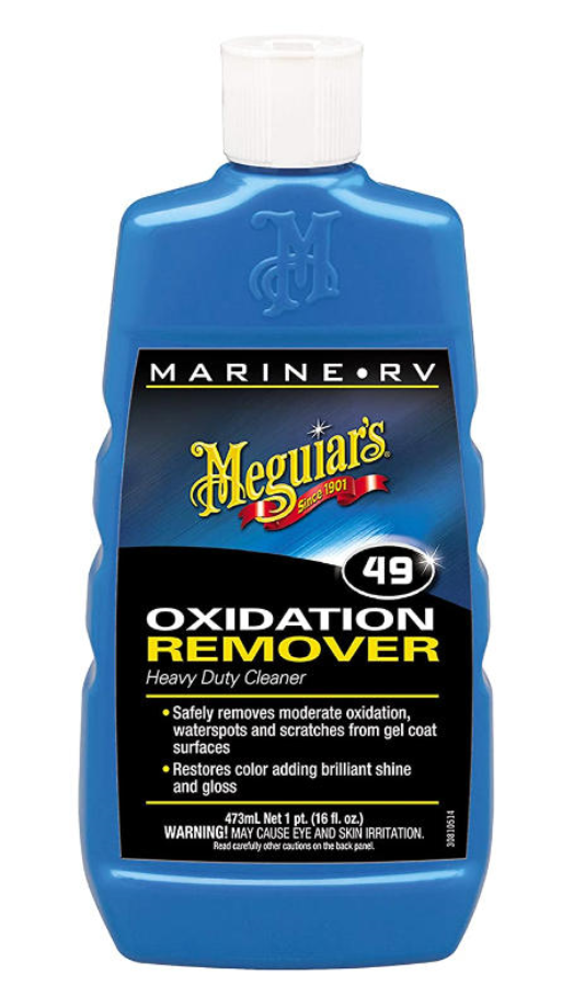

If the stain is tougher, my next choice is :
This is slightly more aggressive and given enough time, I think it could cause gel coat problems regardless of what the label says. I use it to complete gel coat repairs. Quickly removes a 2000 grit surface and leaves a mirror polish. It's the quick removal of the 2000 grit surface which makes me a little bit more cautious when using it.

The Meguiars products are great. I was hunting around for my #49 Oxidation Remover and could not find it, so tried the 30% vinegar. Saved me a lot of buffing.
