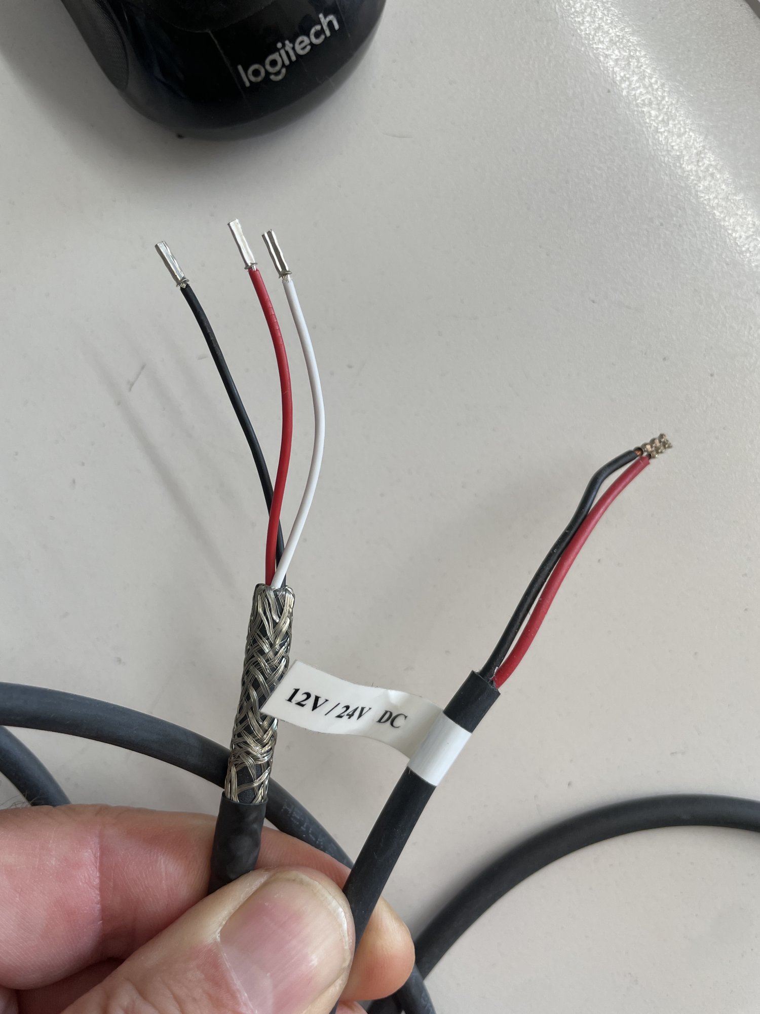

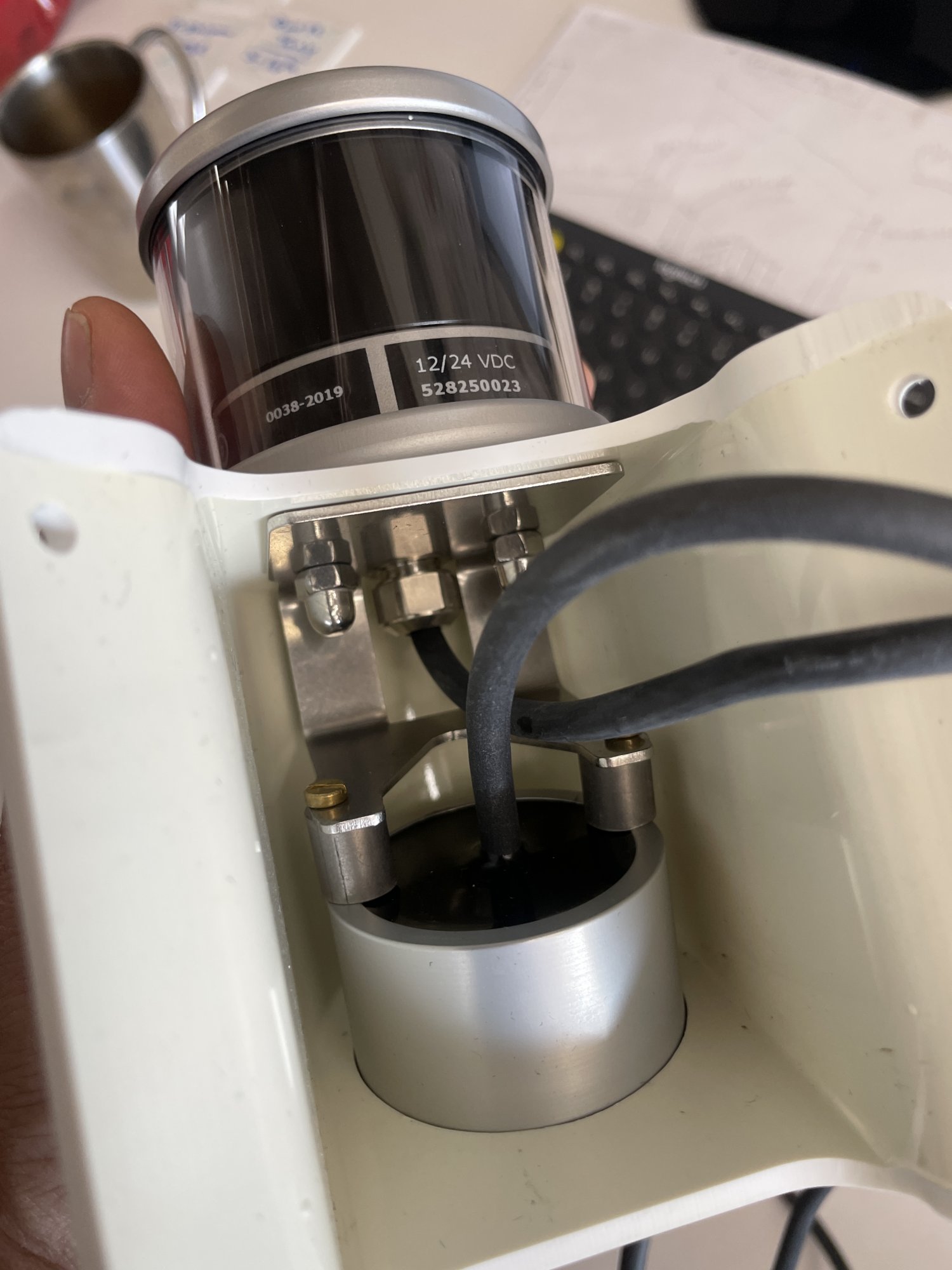

My new to me deck/steaming light combo has a round wire coming from the steaming light that contains a red and black dc wire, however the deck light has a separate round wire that has a dc red, black and white wire. They are LED lights and there was no wiring diagram included. I've not yet come across a three way DC wire yet with a white. Were the two lights meant to be wired to an ON-OFF-ON toggle switch and the white wire is used as a common ground?IMG_2623.JPGIMG_2624.JPG Sorry dont know whats up with this funky image formatting.

I see the steaming lights on the Peters + Bey website, but I'm not seeing deck lights there. Do you have a model number for the deck light portion? Is there a chance that the deck light is actually an AC capable product (which might make sense given the three wires AND the braided shield in the wire sheath). Or maybe an some sort of "AC/DC" combo product (I.E. disregard the braided shield and the white wire for a DC installation)?

I kept searching a bit more...not the identical product, but probably related...
The liner notes for this Peters and Bey spotlight say:
"If no dimmer is used, please connect the white cable with the red one (dimmer with +phase)"
It feels like there is a "dimmer" feature which you may not be using.

Huh interesting. I was going to ask if it might be a dimmer wire. I came across other LED installation (non boating) that mention a white dimmer wire. I didnt think that would be appropriate for a deck light but maybe? Its the T-580 deck/steaming light combo. All the documentation so far has been sales type brochures. You would think for the price you pay for these lights, they would toss in a gold leaf freaking embossed wiring diagram. Comes with absolutely no documentation.

So, i had a 12 volt battery here at the shop and decided to do a potentially costly experiment. I connected black and red wires to DC 12 V battery. The light came on for only about a second and then turned off. If i then connected the white wire with the red wire to the 12V + wire, the light stays on. So, yeah im guessing that was correct, dimmer switch wire. Is a deck light dimmer a thing? Now im trying to decide if i should get one to use with it?

Your images appear to show that you have enough wires to do the task. Run the red wire to one light and the other red wire to the second light (positives). The 2 black wires are common to ground. Attach the white wire to the dimmer. If you need an additional wire, use one of the black wires, but label it and use colored heat shrink to show it is not ground. You can run a pigtail between the two lights to your single ground wire.
Note this is a setup for LED bulbs. They take negligible current to run, so you will not be over-taxing the wires.

I want to point out that there is a shield wire around the 3wires for your deck light, which might tell that the dimmer is sensitive to interference if not shielded. How it will behave without a shield in the mast? I do not know. But putting one from the base of the mast to the switch/dimmer would probably be a good thing!

Typically, RED is DC POS, Black (now Yellow) is DC NEG. On my 1985 Catalina 30, there are 4 wires up the mast: 1 common DC NEG, 1 DC POS Anchor, 1 DC POS Steaming, 1 DC POS Deck light. If the white wire on your light is for dimming, you will need to run an additional wire down to where you control your mast lights from.
