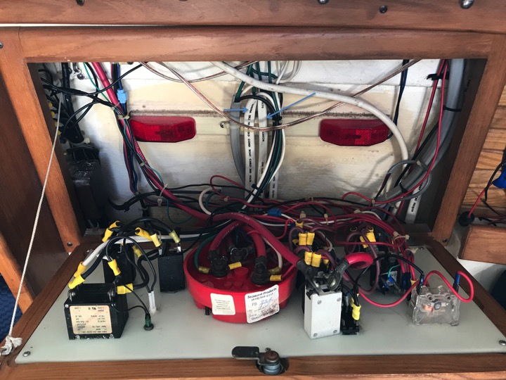

I got a PM noting my electrical diagram showed MRBF fuses and the progress photos I posted shows ANL fuses. Darren asked if there was a reason I changed.
I needed the wires to be close to the wall of the battery compartment so they would fit between the battery and the wall. The MRBF fuses had them too far from the wall so I switched to the ANL fuse blocks and turned the lugs over. I connected the ANL fuse blocks using a copper bar as shown by Maine Sail in his How to Install a Battery Charger article.
Here's an updated diagram and one of the detail in the battery compartment.

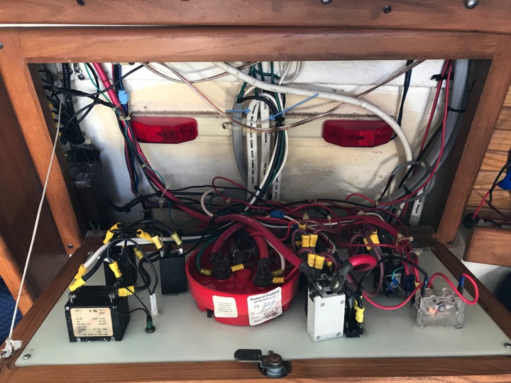

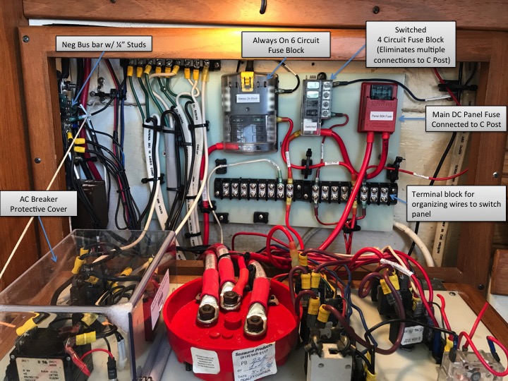

Time for an update as my electrical upgrade is almost finished.
DC distribution panel - Instead of back lighting I added a 5" Marine Beam red/white dome light over the panel. As I identify or add new circuits I will move loads to the terminal strips and run wire from terminal strips to switch.
Before and after photo

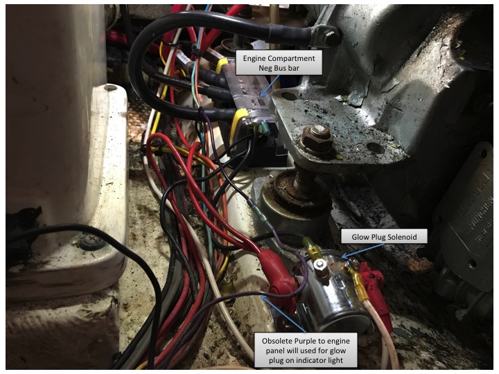

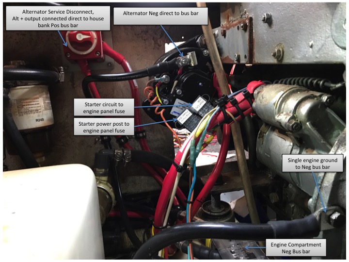

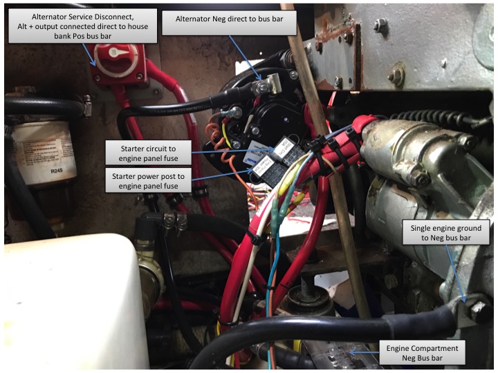

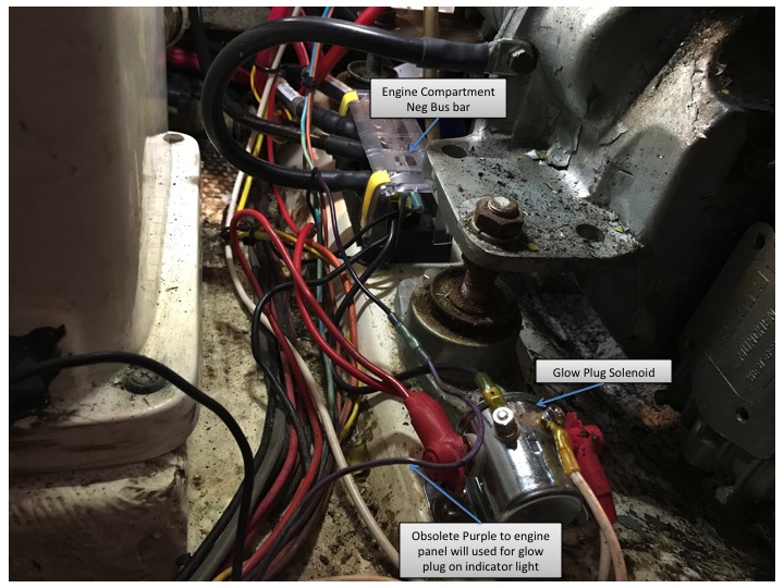

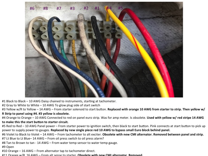

Engine compartment. Added CMI IR 90A alternator and rewired. Still need to neatly bundle wires but that won't happen until after I can fire up the diesel and be sure all is working as it should.
No before but here are a couple of after photos.

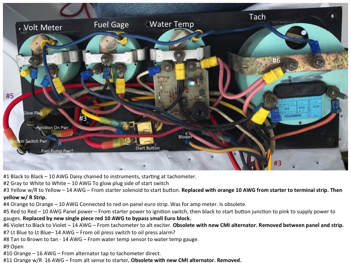

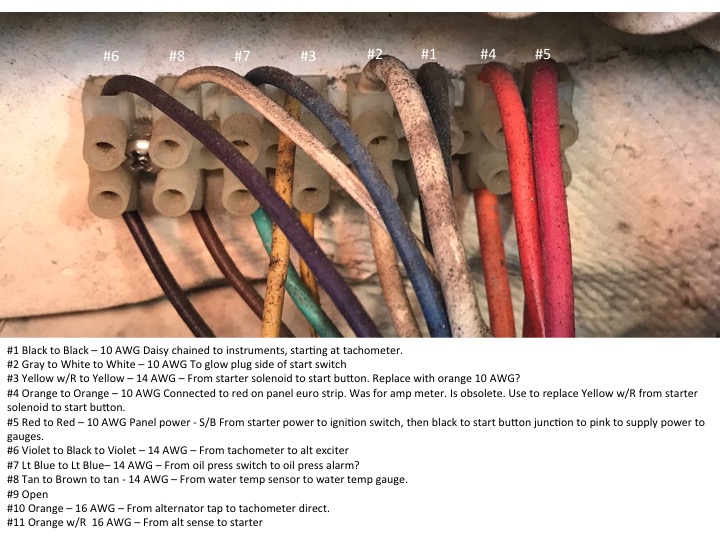

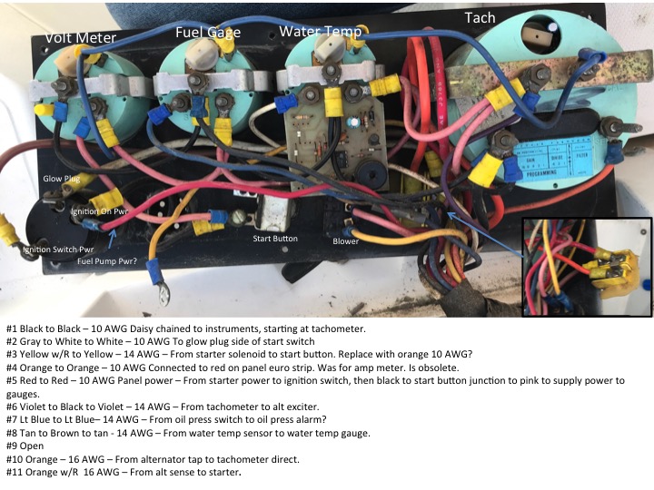

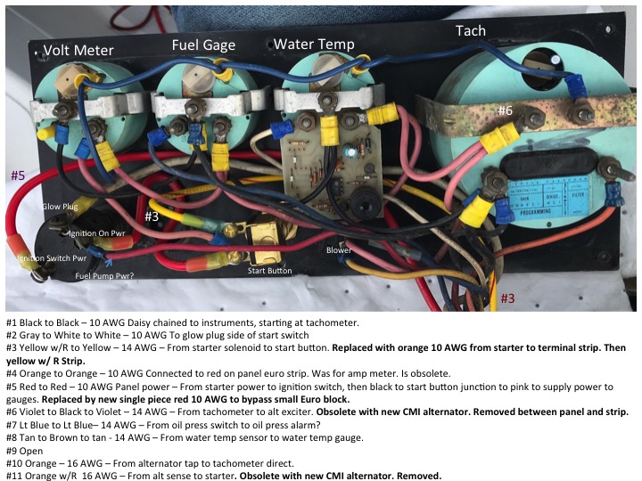

The engine panel still had the alt output running via the orange 10 AWG wire to a small euro strip behind the panel connection to the 10 AWG red power wire back to the starter. I corrected and removed some other wires made obsolete by the new alt.
Here are some before and after of that work.

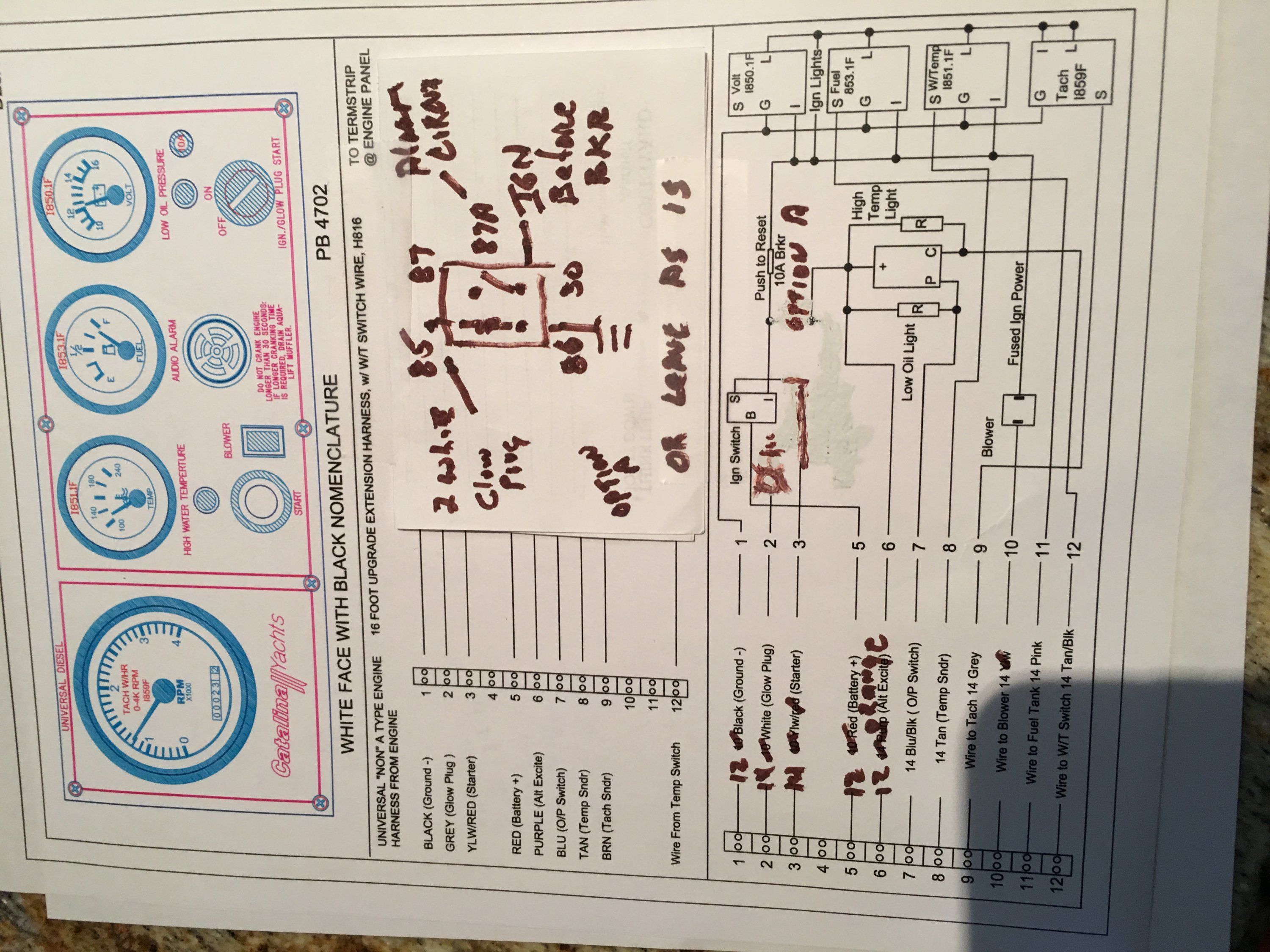

I started the wiring replacement from engine to engine panel today. Much to my surprise I found a #10 wire with exposed ring terminal could up an zip tied to the top of the lazerette. Turns out it goe to the starter lug and start battery — what were they thinking to leave a live wire like that. Also found a #16 Red that goes ?????
Les, I did find at least three wires that did not go through the terminal block behind the engine panel. One is a #14 or #16 red wire that is attached to the Ign On stud of the ignition switch. I marked it Fuel Pump? as I can trace the fuel pump wire back towards to engine panel but am only guessing from there.
I know the Tach sensor wire and fuel gauge wire are the other two that bypass the terminal block.
Could that be the #16 red wire you found? It's shown on the last photo.

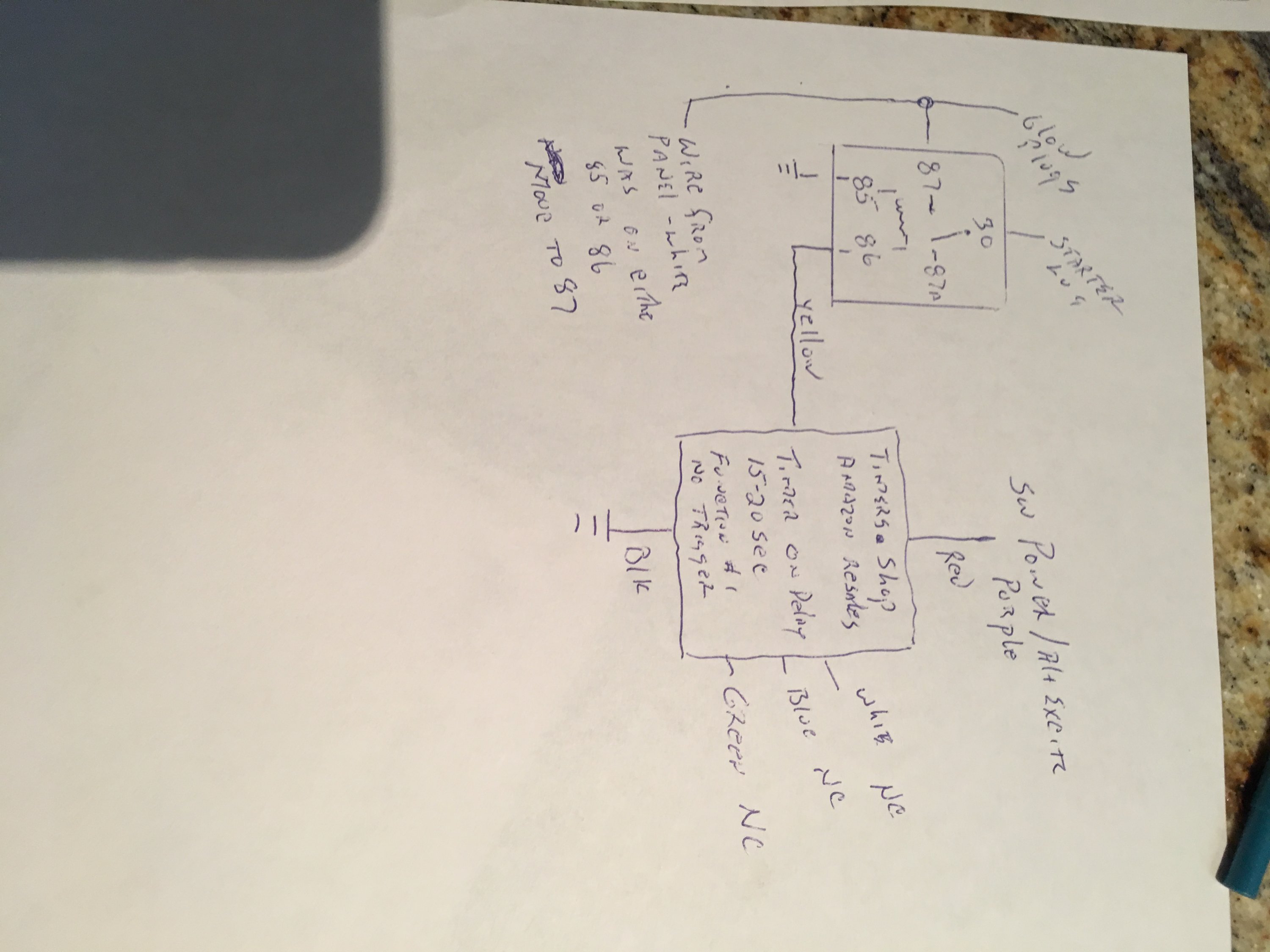

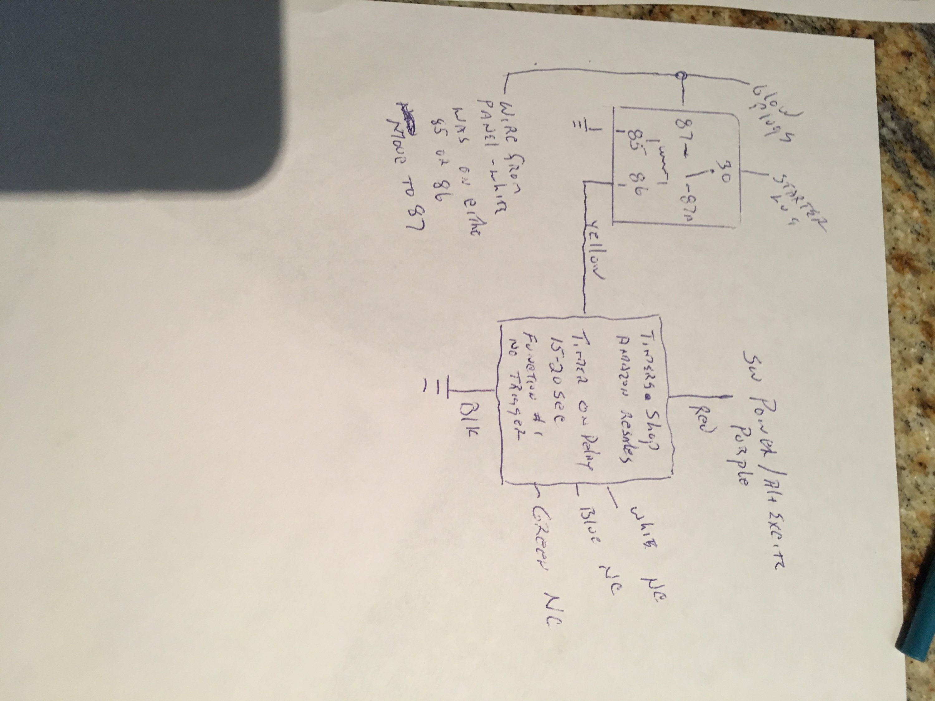

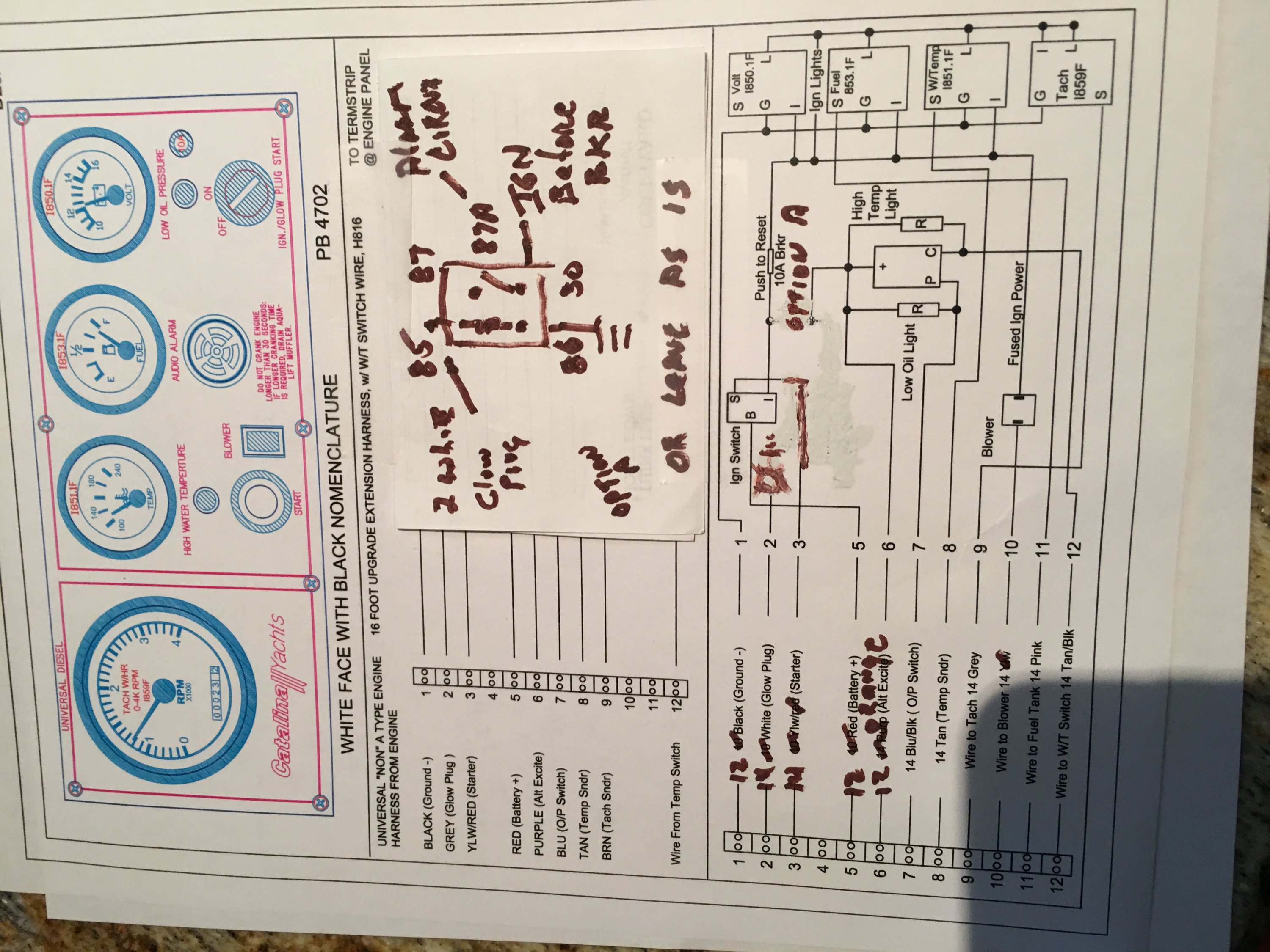

I don’t have a fuel gauge at the engine panel. I have, tach, water temp, Hobbs, amps (disconnected). Going back in will be tach, water temp, Hobbs, and oil pressure. I’m changing glow plug toggle to a glow plug on led, and putting a timer down by the glow plug relay, the NC position on the relay will run up to the panel to provide power to alarms. This way I will hear the buzzer for a short period between glow plug timer timing out and engine start.

I'm interested in how you do the glow plug timer for the relay. Sounds like something I would like to copy.

I’ll sketch out the circuit and post here
Les
May 20, 2016
3,015
Crude but should get the idea across. PM me if you want to chat further. The relay at the panel is just to silence the alarm when glow plugs are on ( which should be 15-20 sec after you turn the key). If you don’t mind the horn leave it out (and leave power connected to ign sw).
