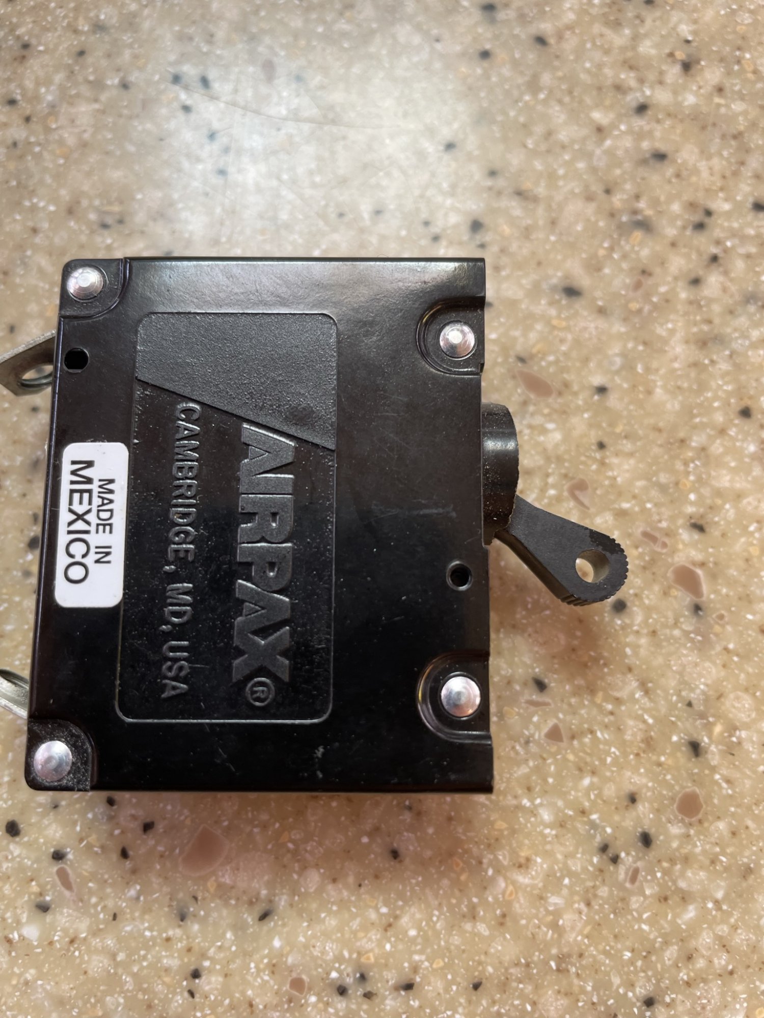

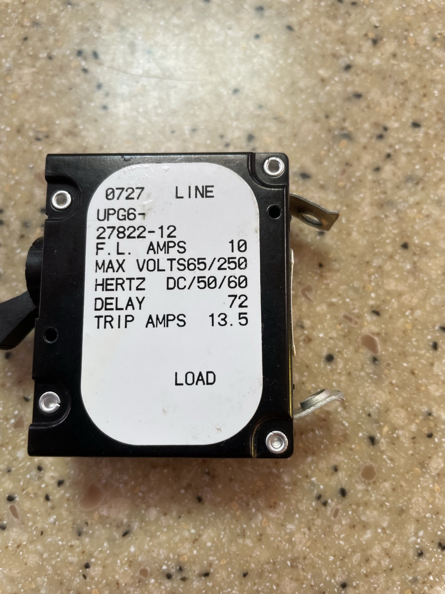

I have experienced two failures in DC circuit breakers this summer. One a 5 amp and the other a 10 amp. It hasn’t been a circuit tripping type of failure. More of a mechanical failure where the toggle just flops and will not engage.
The boat is a 2008 Hunter 38. From those I’ve talked to this seems to be a short life given that the boat sits unused on the hard from October to late April.
Has anyone experienced these kinds of failures in what I believe are Blue Seas breakers? I’m wondering if this is normal or whether there is some kind of product defect.

Definitely not a device or appliance. First one was a 5 amp breaker that controlled knot meter, wind and speed instruments. New breaker installed and working just fine. Second one yesterday is a10 amp breaker that controls water pump. It did not trip, it just went limp like the internal mechanics fell apart.
in looking on line I see postings that the estimated life is supposed to be around 30 years. Given that my boat is laid up at least 6 months a year I’d expect the life to be maybe even longer.

I reached out to Blue Sea. They are very responsive and we are working on a solution. Very impressed with how quickly they responded and Their willingness to help.

Quadrille38, according to information from Eddie Breeden when he was still actif the panel on the H38 is an Ultra panel. are you sure the breakers are Blue Sea? I have a breaker that is frozen in the on position. Luckily it is only for interior lighting.
I’m not sure and need to confirm that actually. Will Be checking this weekend.
