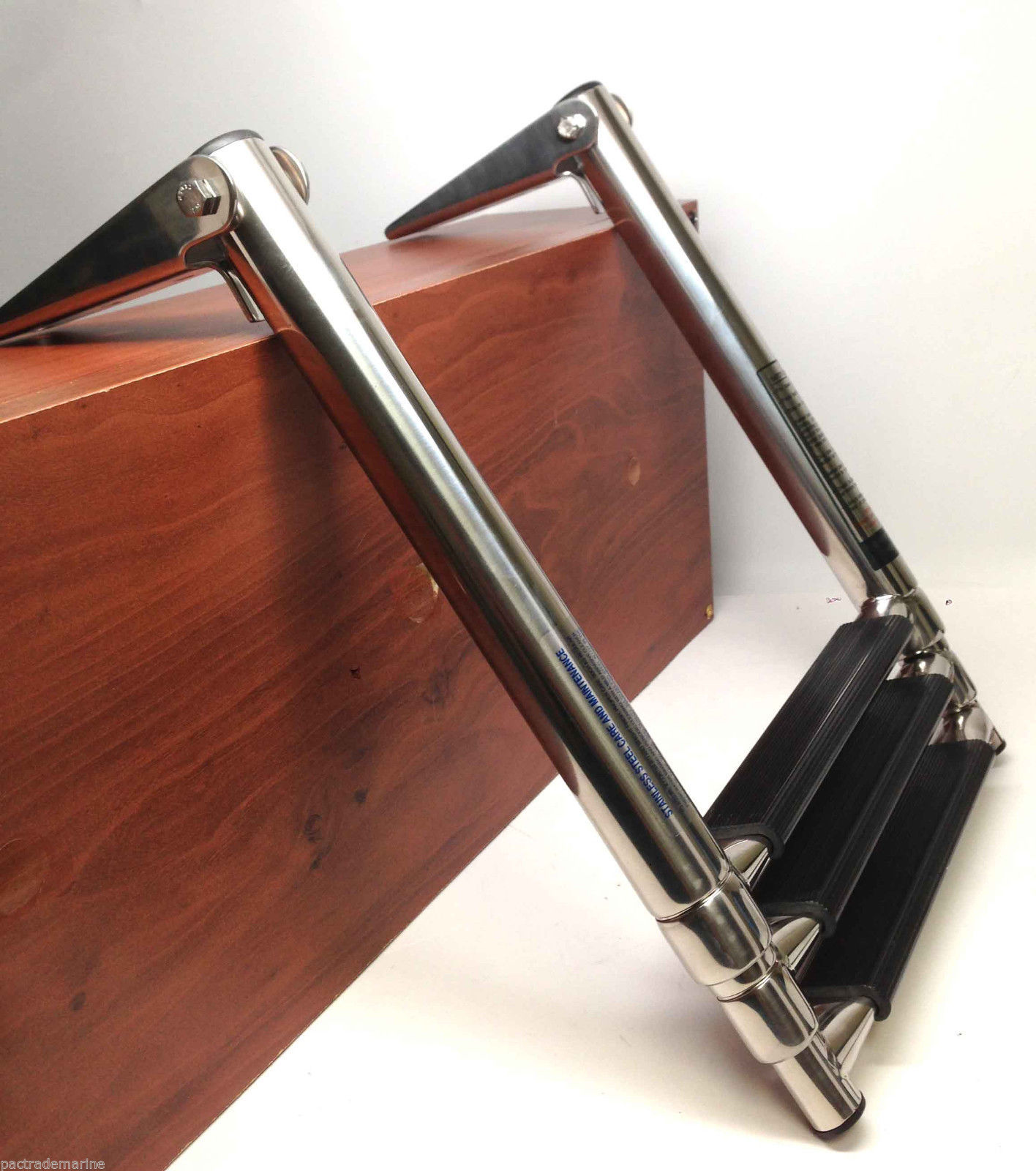

OMG--found my ladder already. $56 is a steal.
http://www.bonanza.com/listings/-Ma...&ad_type=pla&gclid=CPHqwMjR6tECFYhbfgodQFkJ-Q
I am wondering because of the rub rail lip on the transom of the DS1, this ladder might reek havoc on that extruding lip---thoughts? Maybe I could rig up some heavy duty rubber pieces to go between the ladder rails and the transom to make up that inch or so extruding rub rail.

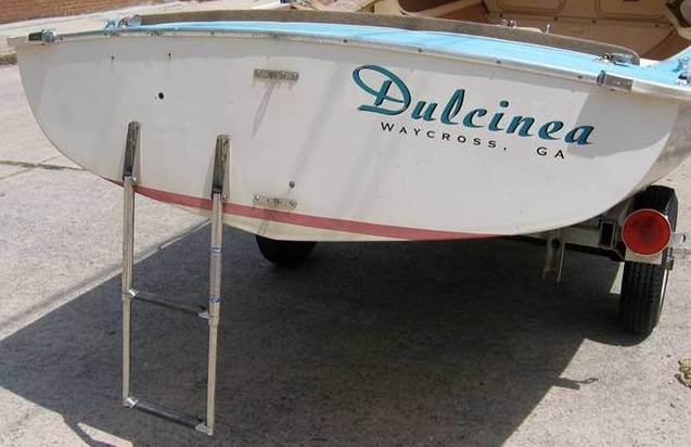

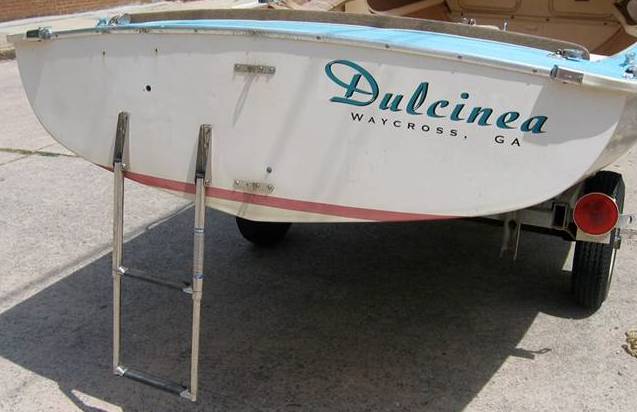

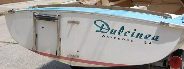

Here is an idea for mounting a ladder on the stern of a Day Sailer, from a DS 1 Owner (not me, I have a DS II).
Other than not covering the boat name, I'm not sure why they mounted the ladder in such way as to block use of the kickerpit?
