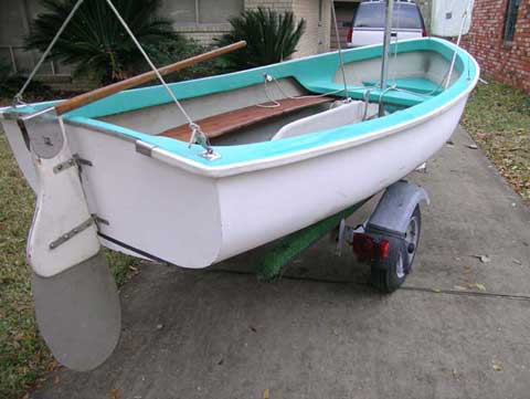

The DS III is not a "Day Sailer" in the eyes of the Day Sailer Class Association, so you can build a new rudder or buy a similar one without a problem of matching "class-required" dimensions. The higher freeboard in the stern is the biggest reason for the DS II not being "class-legal", however.... I don't know off the top of my head how much higher it is. (see below for dimensions of gudgeon locations on my boat)
Tha DS III rudder was supposed to be the same as the O'DAY 19 rudder from what I've heard. So, there is another source of info. You could just make a deeper blade to fit the fiberglass rudder top that you have..... but I don't have the blade depth for the DS III. Pictures below may or may not help. The 1984 DS II rudder (white fiberglass blade) that I show was not class-legal and O'DAY got in "hot-water" with the DSA over it. However, that may very well match the blade depth of the DS III rudder. The yellow DS II pictured is mine, you can get an idea of the rudder depth from that (for older rudder on a DS II).

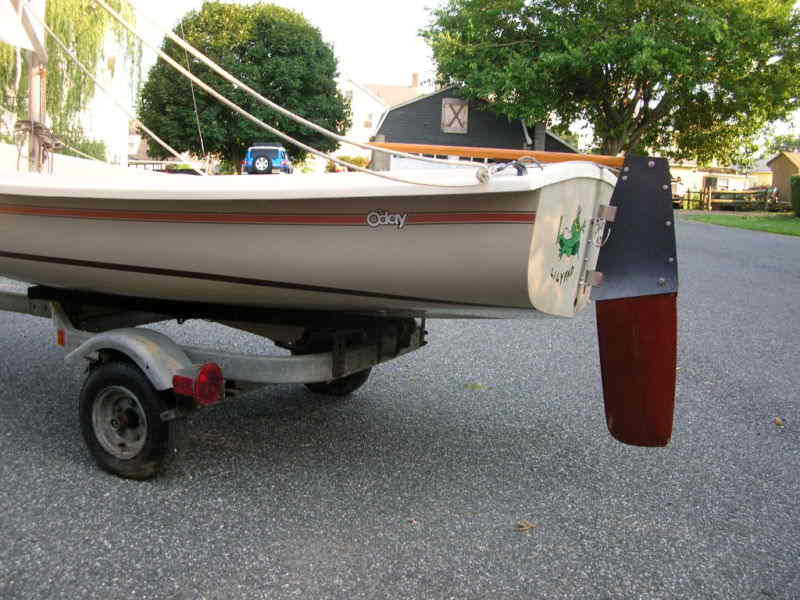

Hah, you think your confused, listen to this!
I'm absolutely new to sailing, but I found I wanted a nice 12 footer, so I bought a nice little 1984 Widgeon. Not knowing anything, I noticed a big difference of my rudder with other Widgeons. It's identical to the brown bladed one in your photograph! A DS III ?
I intend to sail with it. Over the winter I stained and varnished the blade, it looks like wood to me!
What's the down side of using it?
If it is a rudder from a larger boat, it could affect the overall balance of the boat, that is the relationship between the rudder and centerboard, causing the center of the underwater area to be too far aft causing a "Lee Helm" (boat tends to fall off to leeward as it sails) a small boat like the Widgeon should have a slight "Weather Helm" that is a tendency to turn into the wind as she sails. The weather helm effect should not be excessive, but if you let go of the tiller the boat should gently turn into the wind.
HOWEVER, the 1984 WIDGEON did have a rudder like the rudders shown above (aluminum top part, wood or fiberglass blade) just with a smaller blade proportionably. The 1984-86 Widgeons had a wooden blade. Earlier Widgeons (1963-83) had a rudder that was fiberglass for the top part and aluminum plate for the blade. Rudy at D&R made quite a few copies of this rudder design using a wooden top part (bright finished) before I think he found the old O'DAY rudder mold.
See pics below for Widgeon rudders. The one of the wood blade rudder that is labeled is actually from a 1984-5 Javelin, but the Widgeon rudder was basically the same just had a smaller blade (looks like they just shortened the blade to fit the Widgeon).
Apr 11, 2014
36
Oday Widgeon Worcester, Mass
Well then see...there was a good reason I was confused. Mine has the big aluminum housing and the wood rudder and it is shorter. I thought it was a cut down DSIII.
