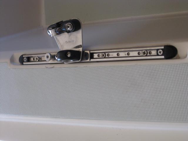

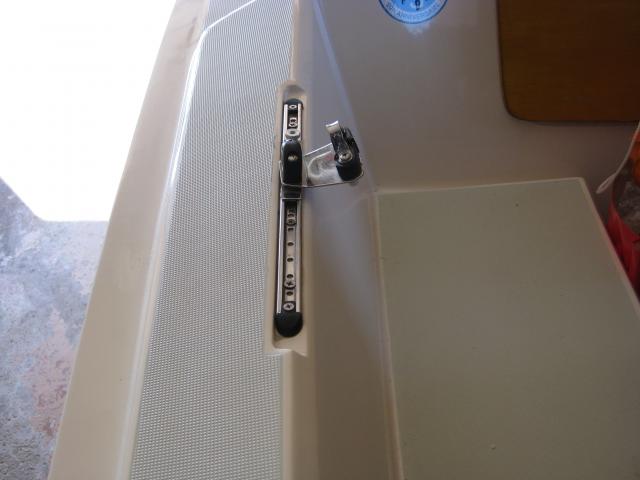

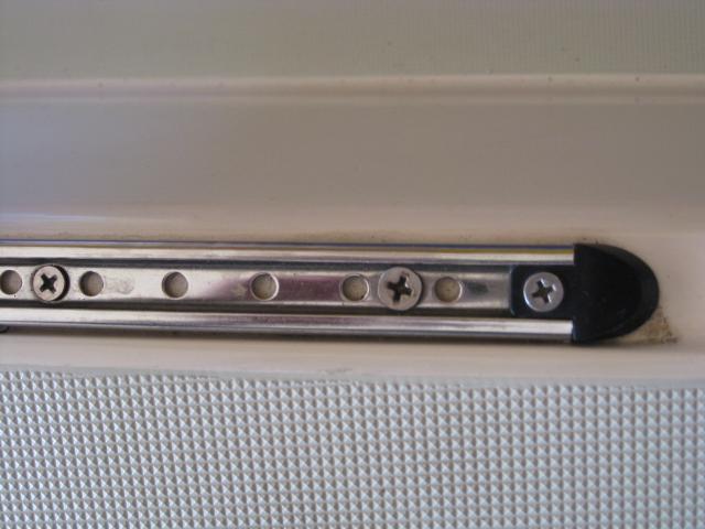

I have a 1987 DS3 with the original Garhauer swivel jib cam cleats and recently purchased new Ronstan jam cleats to replace them. The jib track has "stoppers" at each end which are no problem. Due to the inset of the jib track with the deck, the cleat&traveler could not be removed at either of the track. The problem I've discovered (or created) is upon removing the first bolt in the track, the bolt acted like it stripped out. As I applied pressure upward to get the bolt to thread out, all was going fine until I got the bolt completely out and heard the infamous 'plunk' of a nut on the inside of the hull. :confused: I wasn't expecting the track to be held down by "freestanding" nuts on the underside. The DS3 has 2 round inspection hatches, 1 on each side of the centerboard trunk on the cockpit floor close to the cuddy opening.
I thought I had a 10 minute job to replace the 2 cleats, but I can't proceed knowing the jib tracks would be compromised by this bolt issue. Each track has 4 bolts in addition to the stoppers at each end. The stoppers provide some mount strength, but they are smaller screws not bolts.
I would be much obliged if anyone has any ideas on how to secure the jib tracks.

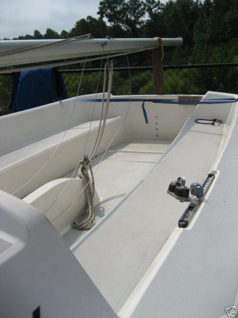

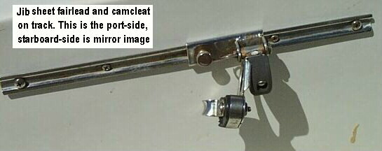

Even Rudy is surprised and a bit disappointed, that those trackes were not backed up by a metal strip glassed to the underside of the deck! On my DS II there are bolts at each end of the track that also act as stoppers. The middle of the track is secured by 3 sheetmetal screws. I replaced the screws last summer with larger, flathead screws after the originals had stripped out. I'll include a pic of one of my DS II tracks and a pic I found of a DS III. The pic of my boat was prior to my replacing the screws.
