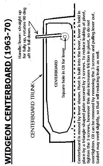

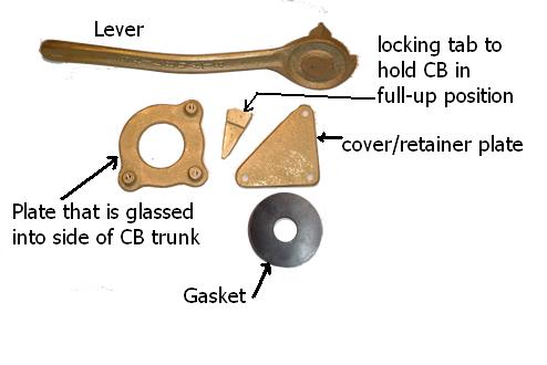

Be aware that when you remove the lever, the CB will usually fall out of the boat!! The shaft on the lever holds the CB in place.
The diagram below is actually from the Widgeon Manual that I created, but the CB on the DS I is basically the same (although, as I mentioned in my private message, the SLI and CCSB Day Sailers use a slightly different, but not too different setup).

I guess I am trying to make this thing way to complicated. Looks simple if you understand that the centerboard has a square hole or something that allows the lever to lower and raise the CB.

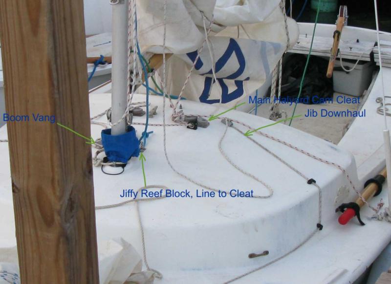

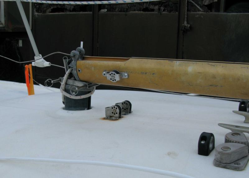

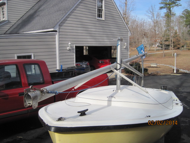

going to try and post a photo showing the two pc mast on my Sunfish. The two ends of the mast have a hinge. Got the lower unit out today. It nests into a cast fixture mounted on the keel. It would seem to make raising the mast a little easier since the movable mast is about 4 ft shorter than most. The photo shows the lower mast in place. The upper mast is just tied to it for transit.

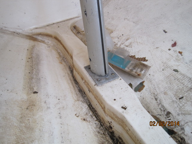

I've only seen one other Day Sailer with a hinge that high. That is not the standard hinge placement. It looks like it was hinged there to allow dropping the mast without having to remove the boom for going under low bridges. The lower part looks normal for a DS1. I've seen similar hinges on catboats to allow going under bridges. The standard mast hinge is much closer to the cuddy cabin top. Attached is a picture of my boats cuddy cabin top showing the mast hinge (boom is sitting on it for trailering). The other picture of my cabin top shows the mast up, the hinge is covered by a boot to keep the jib sheets from snagging on it.

I guess that this is one of the differences between the ODAY Daysailer version and the Sunfish version. There are very few but this is definitely different.

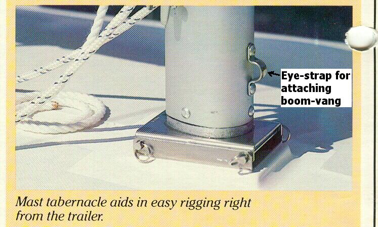

That setup of your mast hinge is not stock for the SLI Day Sailers. I actually thought the SLI built boats had a standard hinged mast, with the hinge bolted to the deck and a short strut or mast section below deck to connect to the step inside the cuddy, but maybe they offered the one-piece mast as original to the O'DAY built boats on their "racing" version of the boat. Your setup appears to be an attempt to copy the "Masttendr" setup on the Compac brand catboats, and is not a standard DS I setup.
As to the DS II ,the DS II had the one piece mast (stepped through the cuddy top) as standard until around the 1981 model year, with the hinge as shown below as an option. Starting with the 1981 or 82 models (I'll have to check my research) the hinge became standard although the mast still was 2-piece (ie: through deck like the one-piece). For the 1984 model year the hinge was bolted to the deck with no opening in hte cuddy top (see pic below of DS_tabernacle), I think they used a piece of mast below deck to support the hinge, but the mast did not actually penatrate the cuddy top. This continued to be the standard as O'DAY transitioned to the DS III during the 1985 model year and was standard on that model until production stopped in 1989 when O'DAY went bankrupt. PEARSON Yachts-Small boat division became the builder in 1990 and I think built a few more DS IIIs before that company became SLI (SUNFISH-LASER) and they utinmately switched to the DS IV (aka: SLI DS I, now built by CCSB).

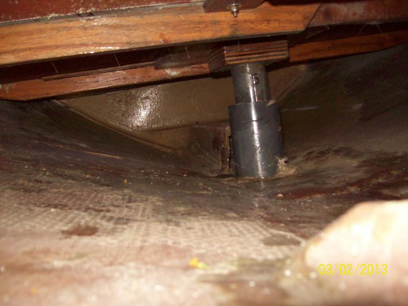

Oday Daysailer II, Rhodes 19, Mariner 2+2 Dripping Springs

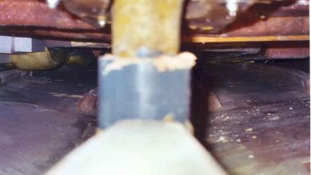

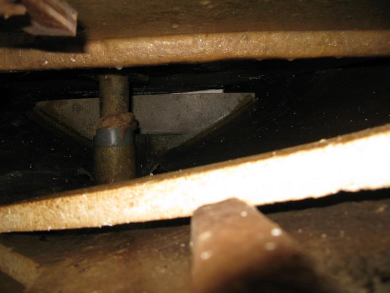

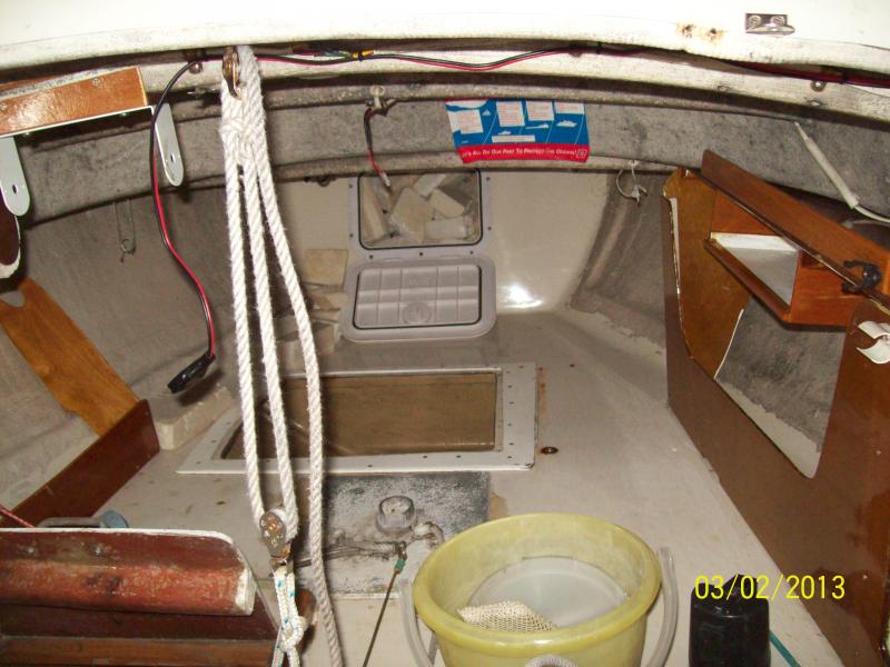

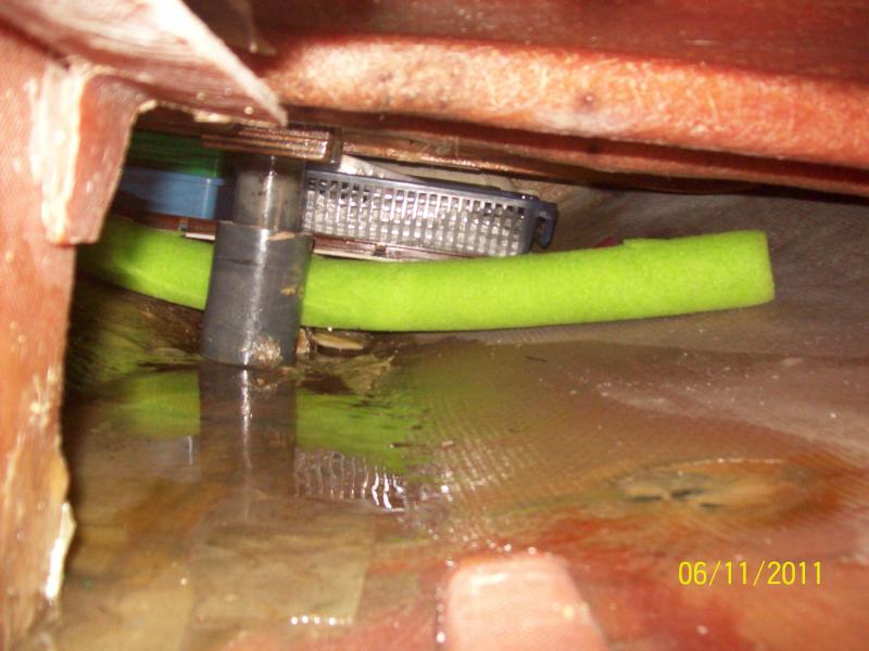

My DS II is a 1976 model. I'm not sure mine originally had the hinge when manufactured, but I suspect that it did due to how the mast is below the cuddy floor. The picture was taken before I added new flotation. My mast is off a 1958 DS I according to the previous owner when I bought the boat. I like the flush hinge, would prevent catching the jib sheets on the hinge.
John
Jun 2, 2004
1,957
Oday Day Sailer Wareham, MA
That is what my boat looks like under the cuddy "floor", my maststep is on top of that "floor" and I did have to rebuild the location of the pipe underneath due to the fact that it was installed forward of the maststep.....OOPS! Deck inside the cuddy (what I referred to as the "floor" above, even though not technically the correct term) had actually cracked and allowed the mast step to drop several inches. I now have a 1/4" aluminum plate (about 12" x 9") on top of the cuddy floor with the maststep on that and I replaced the 3/4" plywood underneath that had rotted out.
So, anyway.... on the DS II that pipe is standard whether you have the hinged mast or not. Hinged mast was not standard until early 1980's. Factory option prior to that with the hinge being "spliced" into the mast about 1" above the cuddy top. Parts to do this mod were also available from O'DAY dealers and are still available from D&R Marine or DWYER Masts. In a way I almost wish that my had that option installed, I like the solidness of the one-piece mast, but when a bird sits on and breaks my windvane partway through the summer, it is just too combersome to unstep the mast to fix it. If I kept my boat on a trailer, there is no question that I would DEFINITELY add the hinge!!
