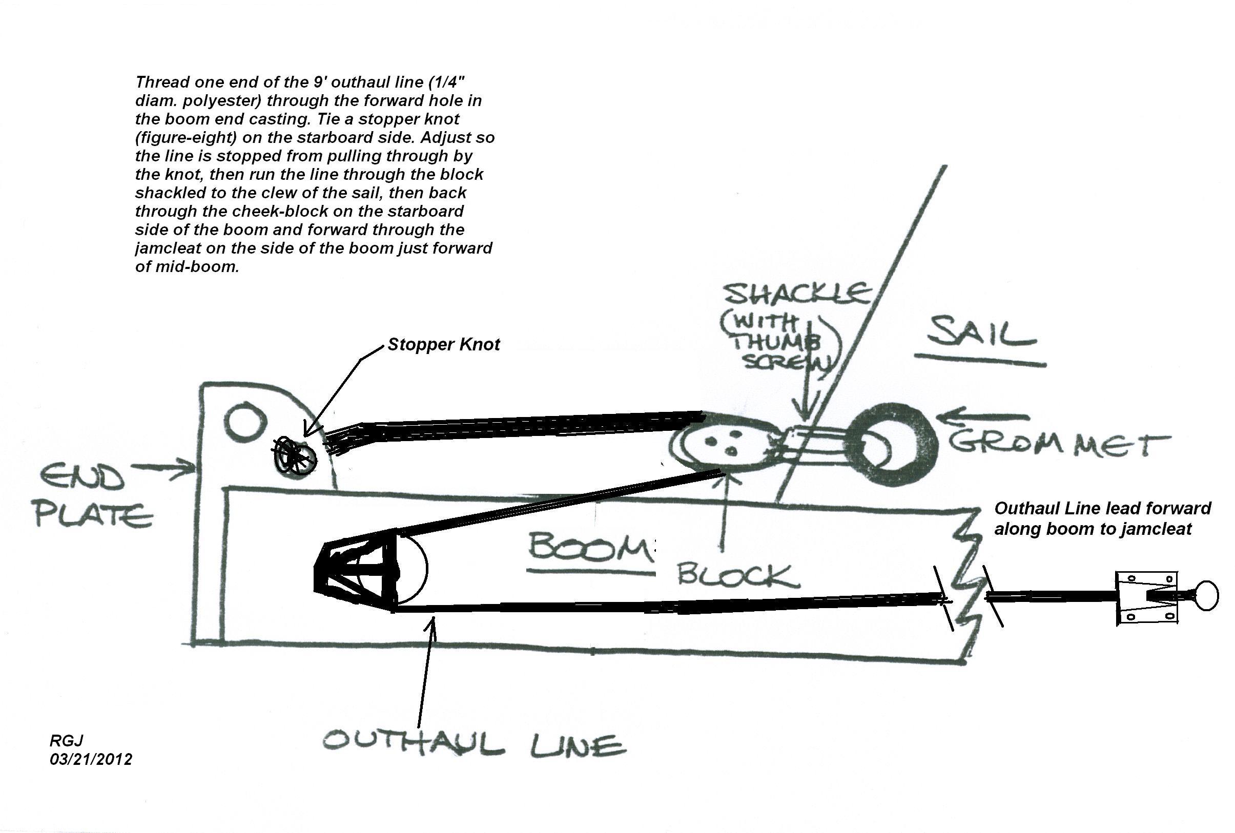

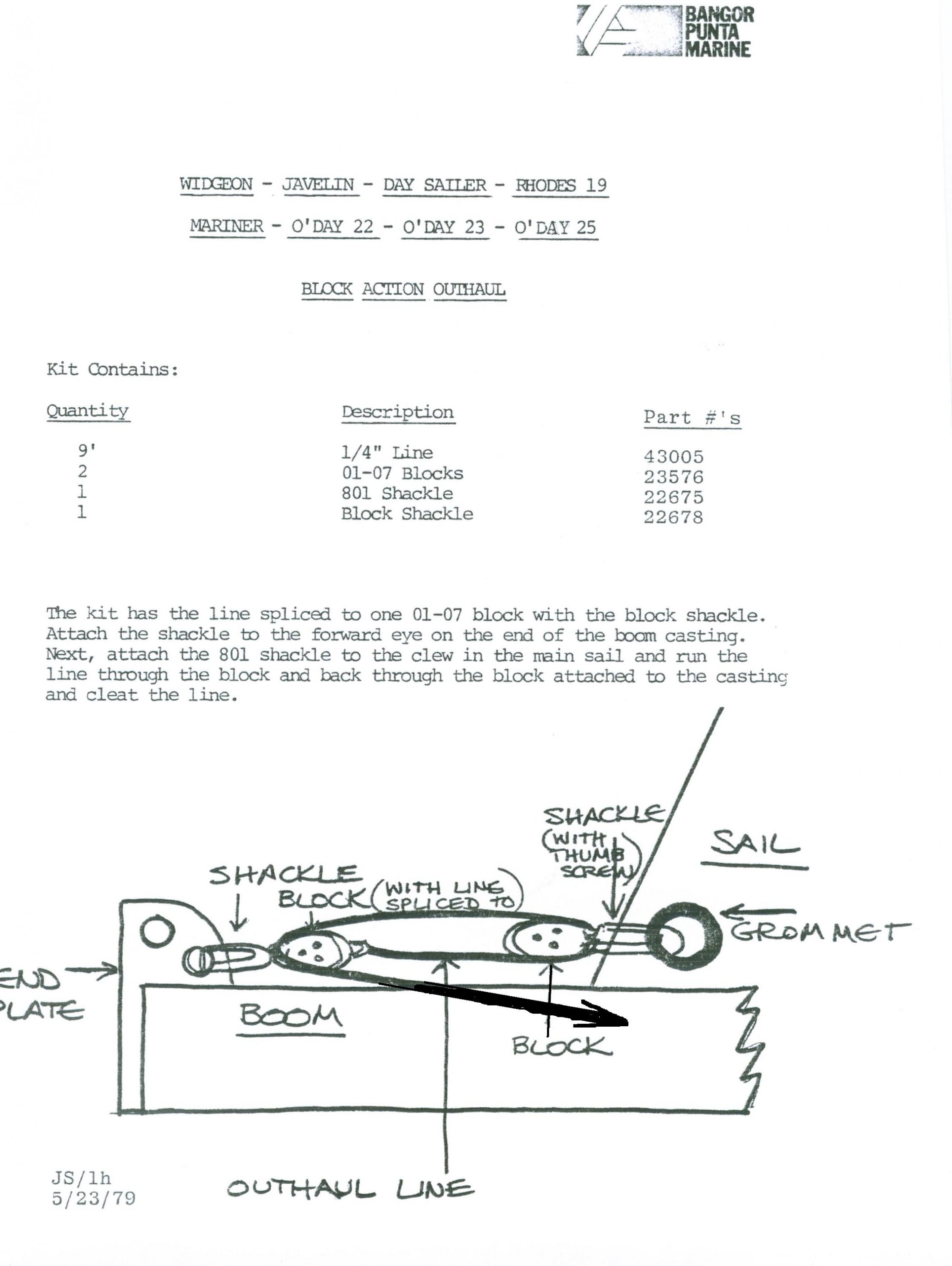

Alternate block-action outhaul.jpg DS II_jibsheet correction.jpg Block-Action Outhaul_ODAY.jpg There should be a V-shaped jamb cleat located about midway along the starboard side of the boom to take the outhaul. At least that is what my boat has (1979 model). I find that the outhaul line slips a bit In that cleat so I add a couple of half-hitches around the outhaul after tensioning the line. I rarely adjust mine, but if it is blowing strong, but not quite enough to reef, I often tighten the outhaul to flatten and depower the sail resulting in less heeling.
Below I have attached pictures from my expanded owners manual, including one drawing of how I rigged up my outhaul (originally it was just a single line run from the clew through an eye on the boom end-cap, then forward to the cleat. I think that if I ever had to replace my boom, I would install a regular horned cleat instead of the V-shaped cleat.

That's great, appreciate your replies. I saw that v-jam cleat but when I tried to jam a piece of rope in it it wasn't very effective. I figured it was something for a boom vang system, that's what confused me. I drilled the rivets out today and removed it, I've gone for replacing it with a regular horned cleat. Thanks for clearing that up.

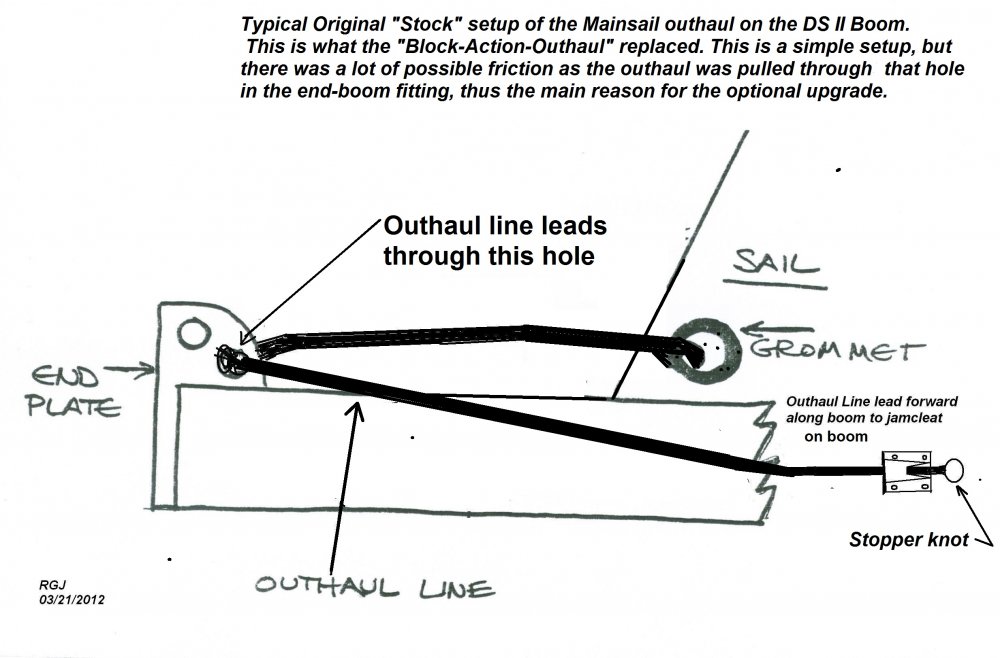

Can you illustrate or explain the original outhaul setup? I'm trying to set up my Daysailer and I don't have the cheek block (nor do I know how to install one, as I'm new to sailing). I'm confused as to whether the line ran through one of the eyes on the boom endplate (which is in your pictures) or through the single eye on the metal tab that's bolted to the end of my boom (which is not in your pictures). Thanks if you can help.

The "stock" setup most years (if not all years?) was simply a line run from the clew of the sail, through one of the holes in the top of the boom-end fitting, then forward to a cleat near mid-boom, My boat has a sort-of jam-cleat that looks like a "hat-shaped" stainless-steel fitting with a "V" cut out of one side. I upgraded to a home-made version of the "Block-Action-Outhaul" that O'DAY offered as an option. I really should amend my Manual to include this original setup more clearly.

Sunbird, I rigged the "alternate block-action outhaul" and am very pleased with the way it handles.
