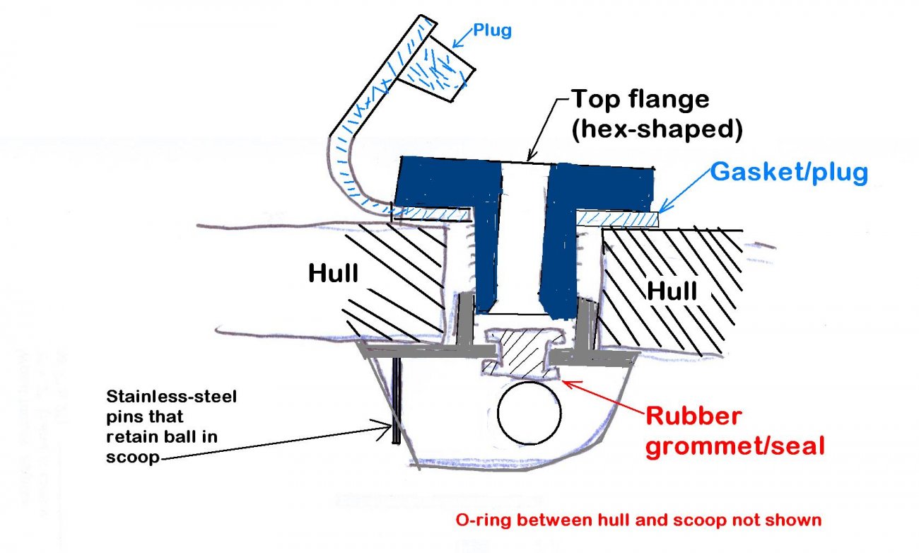

Any idea of who makes the self bailer as used on the O Day day sailer 2 & 3? The rubber bushing is missing from inside and I doubt the ball will seal without that. I haven't had the boat in the water, but I don't think so. I hate to replace the whole assy. for that one lousy grommet. The previous owner replaced the bailer a couple years ago, but that grommet is now missing.

The plastic self-bailer is the same one used on the SUNFISH sailboats, except the threaded pipe part is longer on the DS II/III version. Rudy at D&R Marine sells the complete unit, but MIGHT sell individual replacement parts. D&R Marine, Assonet, MA (508) 644-3001 If all you need is the rubber bushing (sort-of a ring seal?) you may want to check with a local Sunfish dealer, as that part will be the same for both versions. I have a diagram at home showing assembly.
