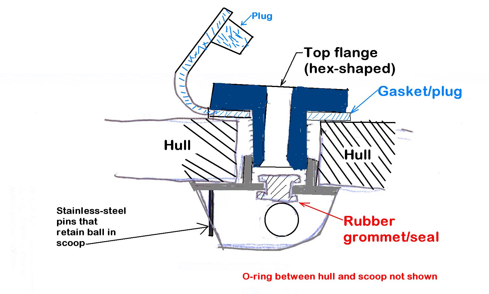

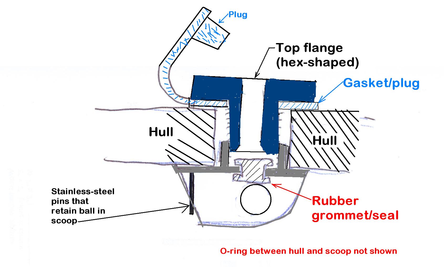

I'm still trying to find the pictures that I remember saving of a DePersia Bailer. Not sure where I had seen them (and saved them from), but somewhere I have those! Anyway, I think I had mentioned having some pictures and diagrams of the newer plastic bailer (modified SUNFISH unit) well, here they are, not sure if it will help, but..... In the mean time, I'll keep looking for my DePersia pictures and see if I can offer any ideas,
Thanks for follow up. Pictures not necessary. I've succeeded in getting "stopper" out, cleaning it up, finding new o-rings and adding some silicone lube. It seems a lot happier.
Removal of entire bailer from boat another option, but years of silicone seal and bottom paint makes this another easier said than done step, so that's gong to be plan B. I've also learned that there are actually 2 sunfish DePersia style bailers and the longer one will be long enough for an ODay Daysailor II, if it gets to that.
Right now, only missing piece is bronze flange washer that originally held it in place. Actually superfluous for the moment, but i like things to look neat and complete.
