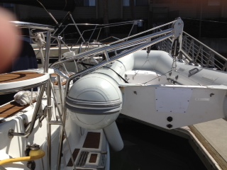

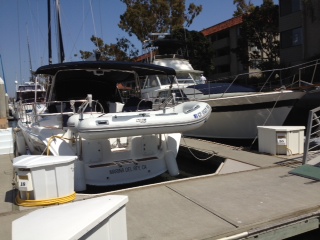

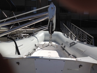

Jan 10, 2012
75
HUNTER 49 MARINA DEL REY
Got these Saint Croix davits, the top block does not swivel. this keeps the twist out of the block and allows you to pull up a heavy dingy, I have a 20hp electric start Honda with the Saint Croix helm seat. I just have to pull the boat past the transom, no problem. Sorry I don't have pic's with the motor and seat.
