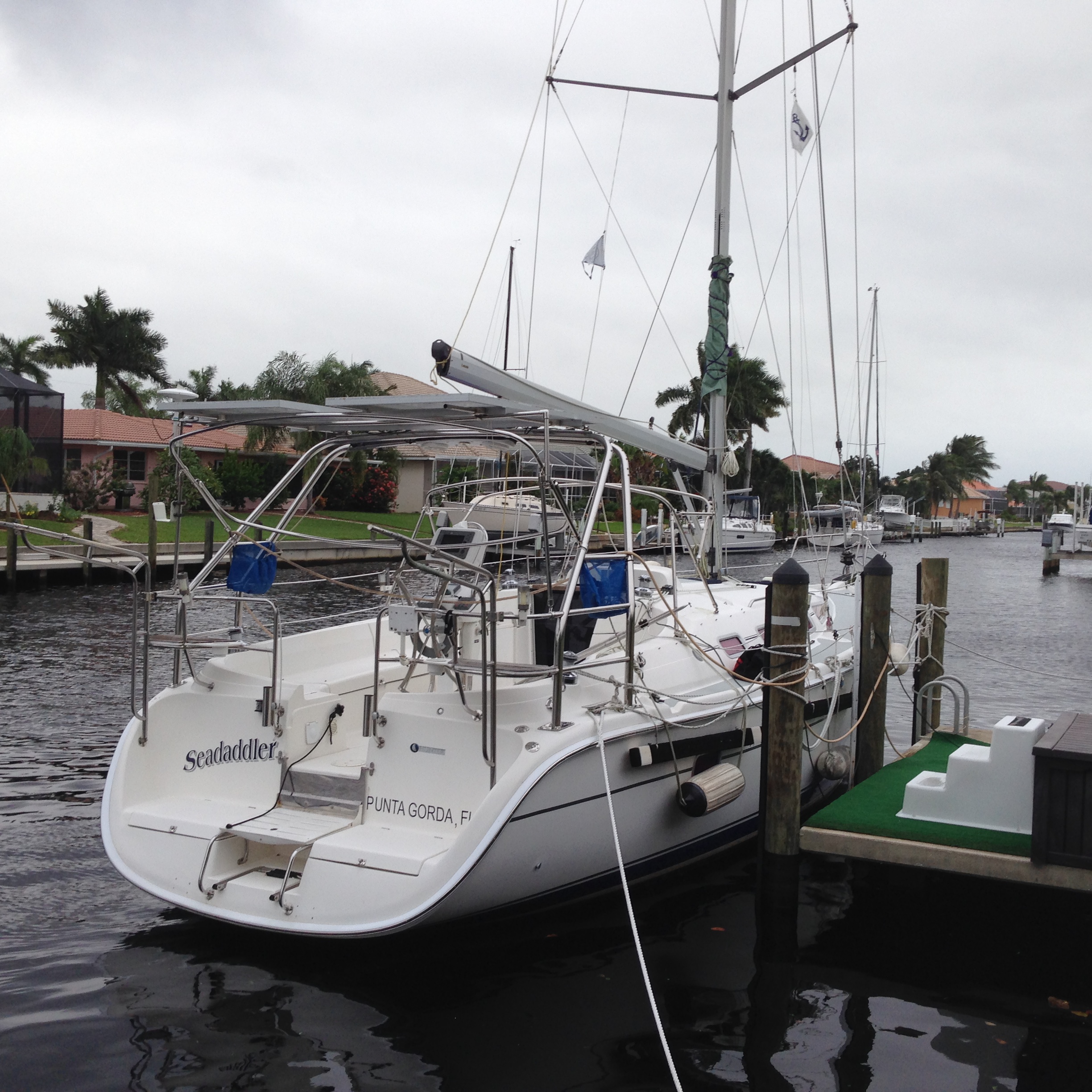

I never wanted Davits because I always back in to my slip at the marina but I moved to
a private dock behind house and used getting off the sides port or starboard.
But towing the dinghy was always a problem when going back to the slip and saw a lot of other friends with Davits and it looked so nice and easy and even kept the motor on when on the Davits and we do mostly anchoring when cruising and so got the Davits and best thing ever
and so easy with deporting dinghy in 5 minutes and usually pull the dinghy up part way out of the water secure no worries sleeping at night tilted in case of rain so water can drain out.
Davits have made my life so easy with less handling the motor off and on and do sail with dinghy and motor on the Davits.
Best thing ever that and solar panels up off my arch over my Bimini.
