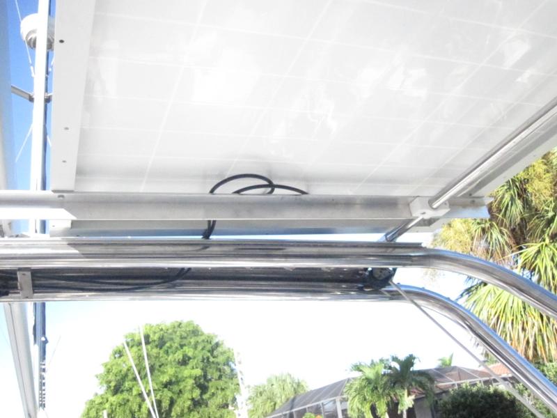

I really don't like putting solar on Davits,does your
Hunter have a stainless arch and rather install solar off the arch
as I have done and than added the davits with out solar on them.

Are there any pictures of a H42 or H45 with an arch structure over the transom holding solar panels?

Have a look here,
http://roadslesstraveled.us/sailboat-solar/

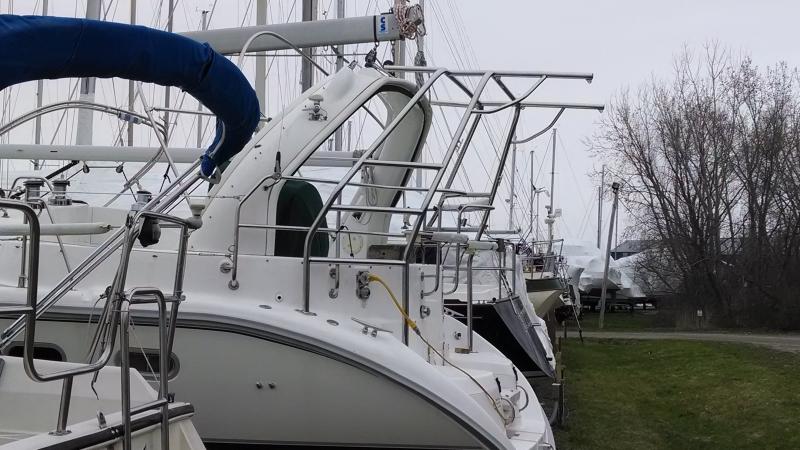

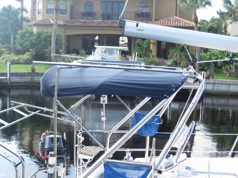

Hunter does have a davit setup that mounts off the arch
easy install all off the arch and saw the nice setup at a dealer once.
Davits were the best thing we ever added and that way the dink is always
ready to go and easy no real work and I always leave motor on dink ready to go.
I have Ocean Marine but the hunter davits are so easy to install and just bolted
to the arch and made for 38 hunters and up.

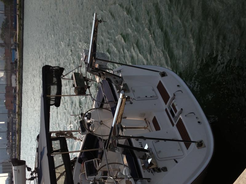

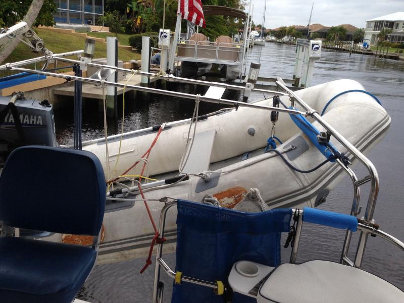

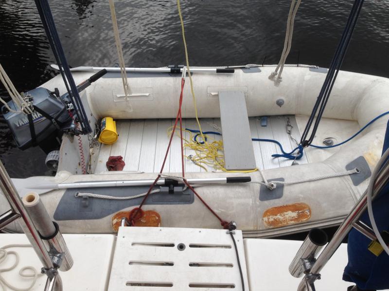

Jun 1, 2009
1,881
Hunter 49 toronto
We are contemplating adding davits on our 456 and would like to get some feedback from the group. I want to also add 2x345 watt solar panels on top of the davits. Thoughts?

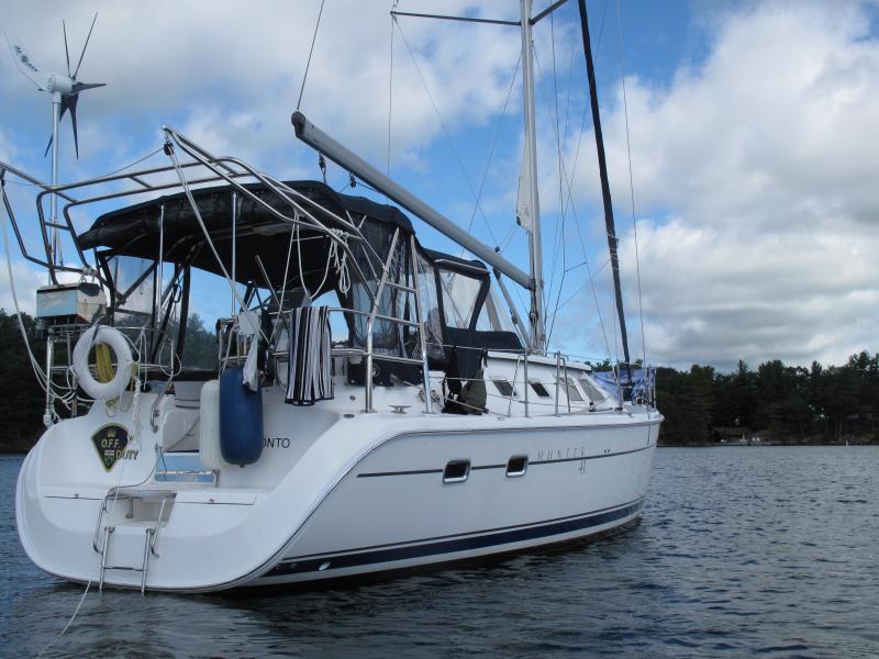

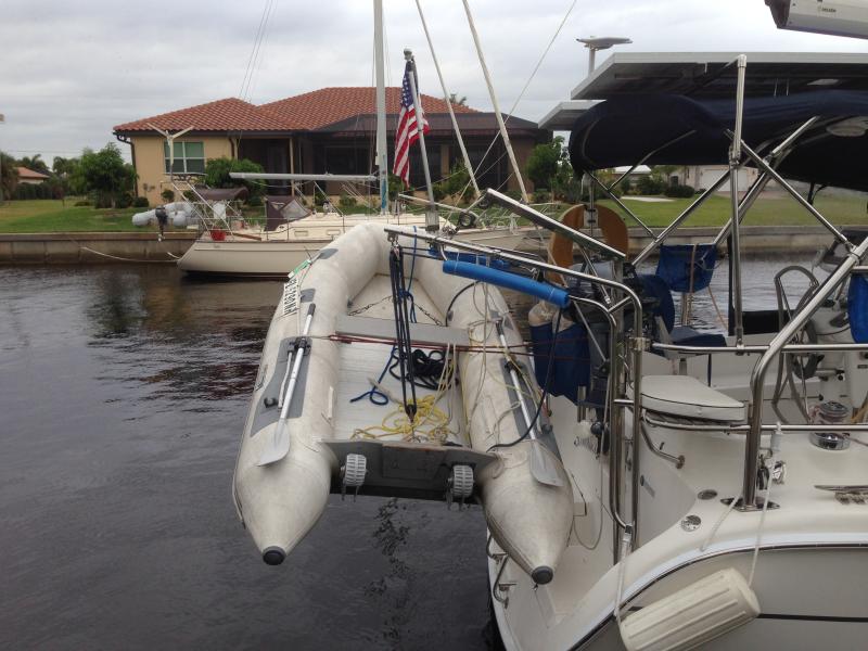

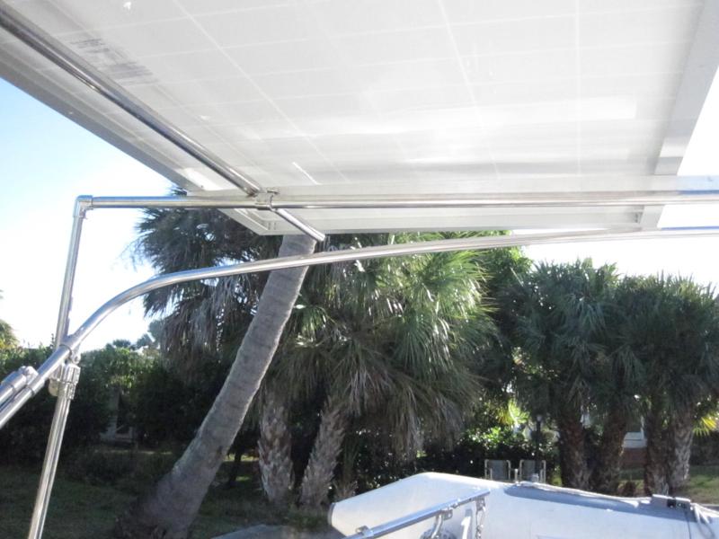

This is what I did on my 49
Big job, but amazing results

I have davits and I have a 290W solar panel. My panel is mounted off the traveler arch and would barely fit on top of the davits so I don't see how you would mount 2-345W on them. Plus I think you would get a lot of shading down on the davits.

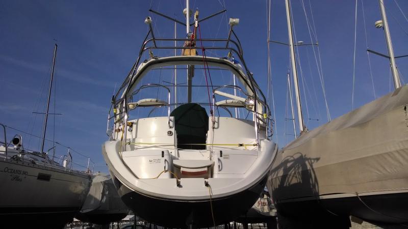

I read ALOT about solar panels and shade. I talked to some installers and the consensus seems to be that it is better to mount them parallel to the water surface than to have them get shaded. I'm sure there is tons of opinion on that subject here as well, but I have seen more than one boat hanging their panels on the life line facing outward. Just one more thought.
BTW Tantor I think your davits are aewsome. I have been looking for a welder locally to do something similar on my 41. I'd like to be able to walk under the dink.

We installed the factory Davits from Hunter. Easy installation (simply bolt together) and well up out of the way.
