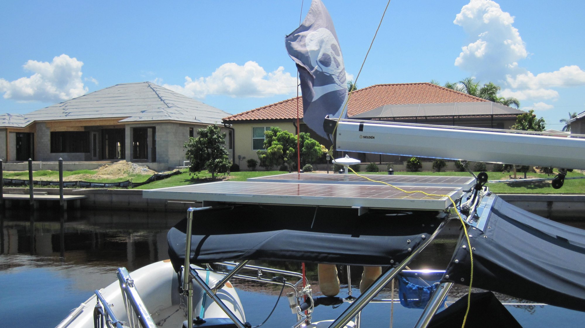

I looked at davits from Martek, Kato, and Garhauer- ended up going with Garhauer and couldn't be more pleased with them. Their standard height was perfect for maintaining the "walk-through" aspect of the stern, and they were also able to provide the cross-bar for mounting the forward edge of the solar panel (340 watt from Arizona Wind and Sun) once I gave them the measurement between installed davits.

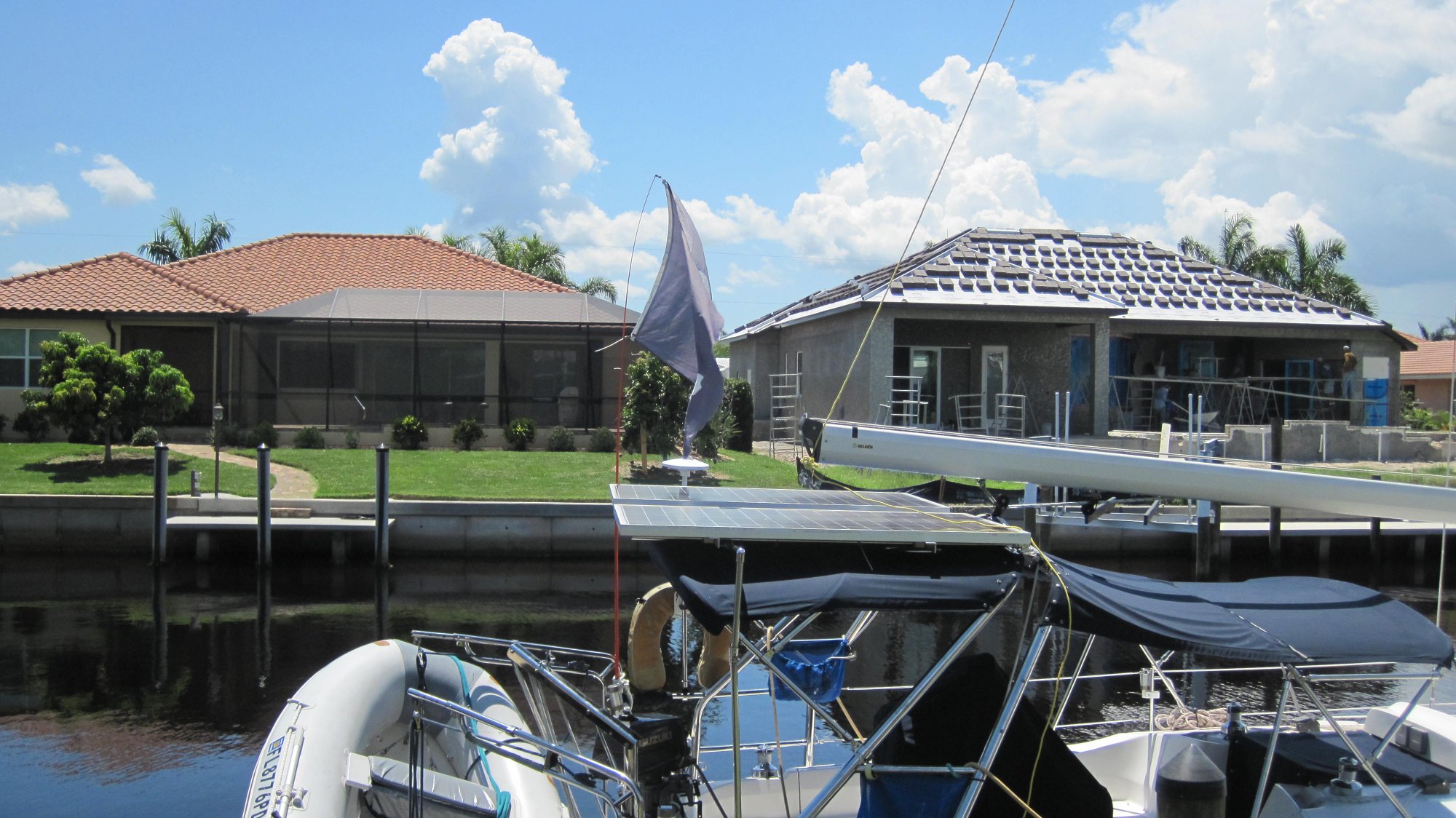

The dinghy is normally snugged up to the underside of the davit arms and secured so that it cannot move and chafe. With the dinghy and davits that low (at the pulpit) I doubt that you would have enough room to enter under the dinghy. My dinghy is just a bit higher and it is a difficult struggle to board from underneath. Furthermore your dinghy would like to be tipped toward the drain for rain water drainage and that tipped position doesn't help visibility.
I think your only choice is to mount the davits and dinghy fairly low so you can see easily over the top. But you will need to give up the ability to enter the cockpit from below the dinghy.
I have a h40.5 so it is a bit different than your 410, but her is a view to the stern with my dinghy in place.

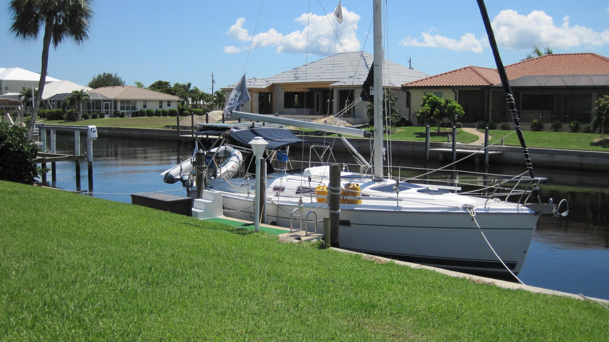

I have a 9’ hard bottom dinghy with 4 hp 4 stroke and like keeping the motor on the dinghy while sailing and cruising so I put
2 solar panels off the arch and ran 2 round tubing from arch back towards stern and did that in 2010.

Sorry for the delayed response (I was not getting notifications for this thread). My davits are from Garhauer, and measure 66" tall at the mounting upright and about 9" taller on the outside. My first post photo shows how the feet are mounted, and yes, I did have to remove the cup holders from the stern rail seats (haven't missed them a bit). Garhauer supplied backing plates for the base mounts, and I did not have to do any reinforcement for the fiberglass there. They also supplied two support struts which I still haven't gotten around to mounting...

I think Garhauer has a couple of standard sizes, with mine being the tallest at 66" with 42" arm length. A I mentioned earlier in this thread, once I had installed the uprights, I measured the distance between them. Garhauer then supplied a raised crossbar that clamps onto the forward edge of the davits, giving a mounting surface for the forward edge of the solar panel and allowing it to be flat. I used four Gemini mounts that I found for about $25 ea. online (I think from eMarine.com) for mounting the panel.
