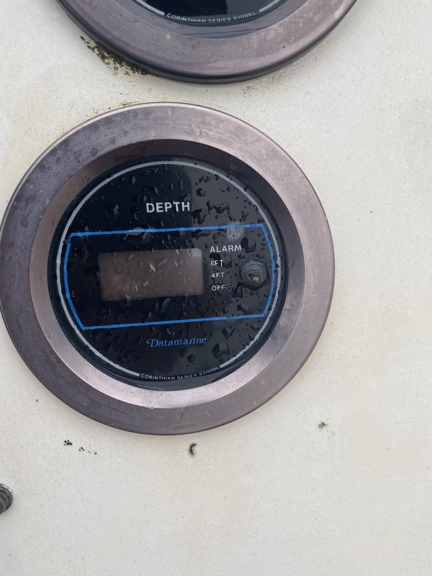

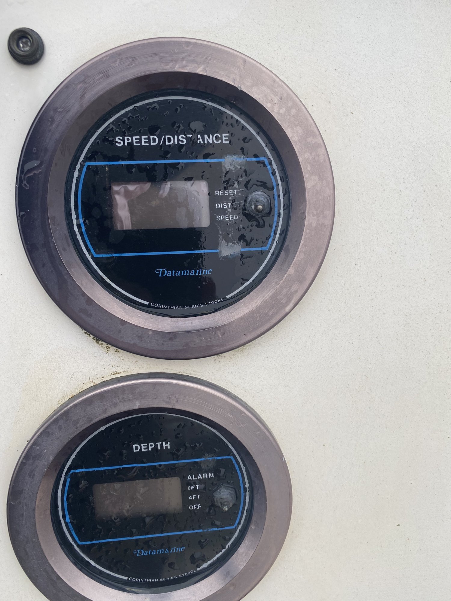

Luna has a couple Datamarine instruments in the cockpit area near the companionway hatch. I have no documentation on these or the transducers. Does anyone know where I can find information on these? Is Datamarine still in business? And how hard is it to remove the transducers while still in the water?

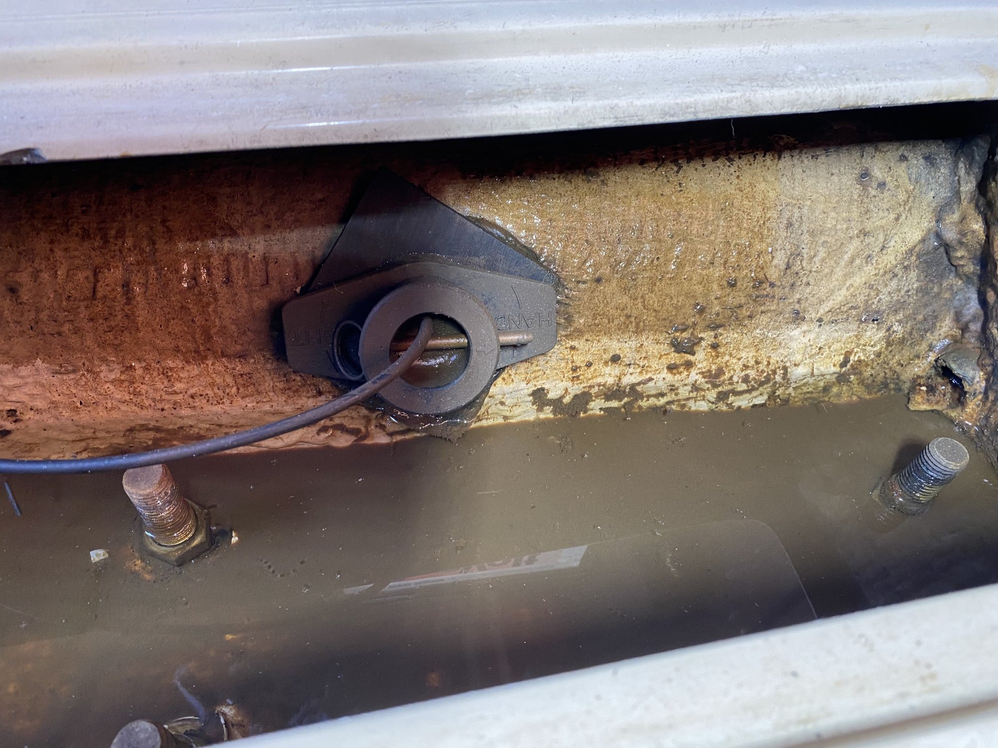

This is most likely the speed transducer as I believe it would be difficult to determine depth from that angle. There is another one of these through hulls in the engine bay that goes straight down, which I figure to be depth.
I am going to guess there a pretty healthy collection of sea life growing on the sensor so it will not work without some serious cleaning.

Since Datamarine is no longer a thing, who then makes gauges similar to these? They are using a 4” hole in the cabin.

Yea, that's a problem, since newer instruments use smaller holes. On my C36 I made some nice bezels of Starboard to plug the big holes and mount the new gauges.
Do you know if they work? If you don't need or want an integrated instrument system, if just depth and speed are O.K. for you, you might just continue to use them.
24,926
I took a face like that, left the trim sides and cut out the center instrument, that just happened to be the diameter of the autopilot control for my Raymarine AP.
I have seen others use starboard or fiberglass to cover the hole and resurface the area. Some attach a starboard or wood cover for the hole then drill a smaller hole to insert an instrument that is of a smaller diameter.
