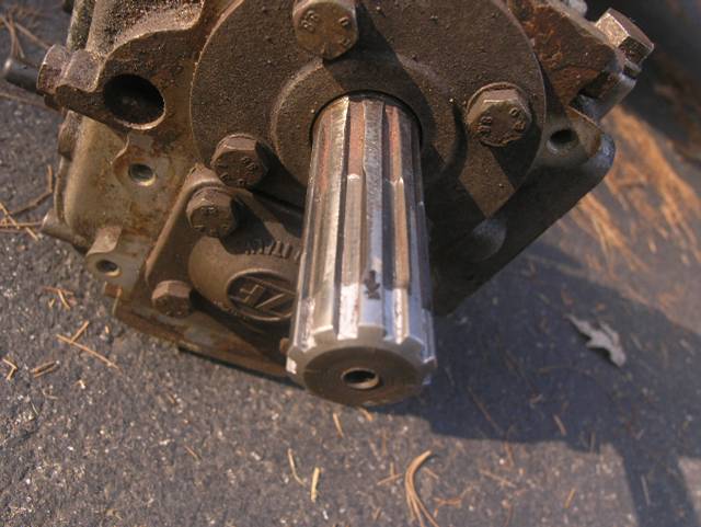

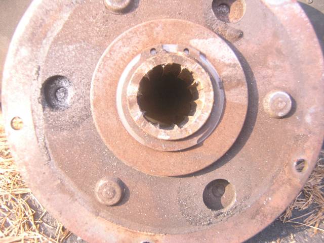

Well folks, I pulled the engine and split the bell housing to find out why I was getting so much rattle from 1000-1500RPM. What a job!

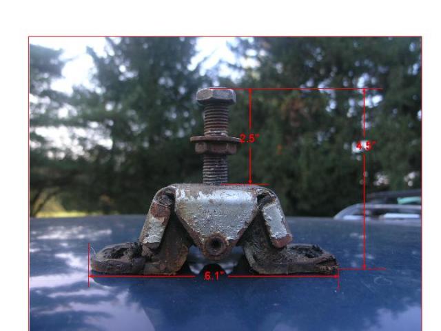

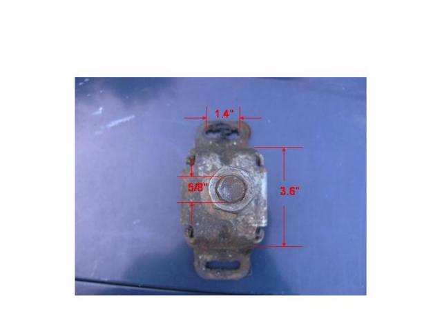

I was literarily revolutions away from completely striping out the spline collar on the damper plate due to the P.O. installing the incorrect one (see Pics). The tranny is not original because there is no name plate on it. I believe I have identified it by dimension and input to output ratios as a Hurth ZF 5 or 6. Unfortunately because the wrong damper plate was used (the collar is way too large in Dia, this caused a very loose fit, can't believe this was installed like this!! The trannys input shaft splines leading edges are quite worn and as a result the entire shaft will need to be replaced. The tranny does not leak, no appreciable play, and the fluid was clean. So what to do, get the shaft ~$400 and replace it, or get a new tranny ~1200? I will also be replacing the motor mounts and cutlass bearing. Has anyone replaced the motor mounts, if so where did you get them and which ones did you use? I will need to maintain the lateral adjustment feature (the wide mounting slots) the engine needs to be offset quit significantly to the starboard in order to get my alignment correct.
