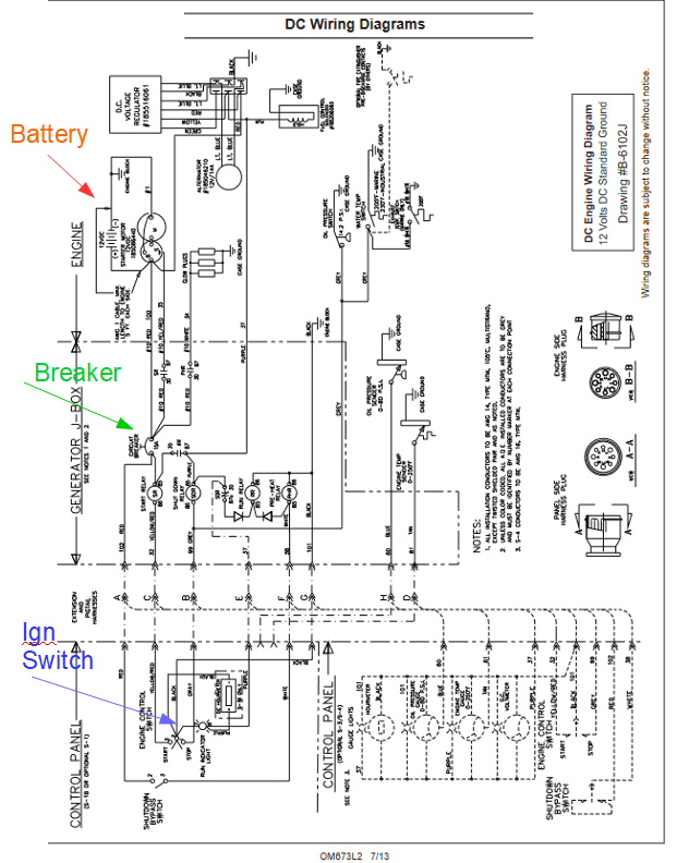

Here is your wiring diagram (From JamesG161) with the components to check indicated.
Print this out. Get a multimeter or a 12 volt testing light, find the start battery by tracing the cables and start testing.

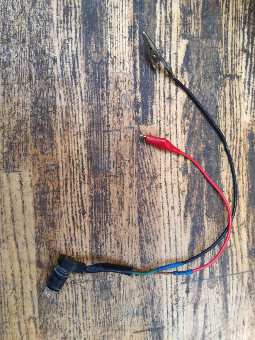

I use a simple 12volt test light made from a Suzuki instrument light. Works great in the dark for tracing power supply.
